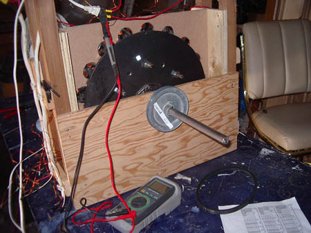

I have constructed a steel dbl rotor, as I threatened in last my posting. Here are some photos and test results. Can anyone verify these figures? I personally don't think they can be correct. If they are I have created a monster. My intention was to generate heat for my garage next winter. Little did I realize I would need a prop the size of my house, and 50 ft in the air, Bet the neighbours notice LOL.
 I've got a few mechanical bugs to work out, wobbling, stator construction, housing, decent bearings, attachment to the shaft and support within the housing. Other than that I'm off to the races.
 I'm learnin' a lot an' hav'in fun.

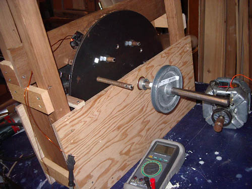

By the way, the electric motor in one of the photos is fairly new from a dryer. Can anyone help me with a way to hook it up so I can turn my creation instead of using a drill?
Thanks.
Values are projected after 1 coil tested at the stated RPM.
2 of 16" x ¼" iron Rotors, 72 of magnets 1/2" x 1/2" x2" , coils 125 turns of 18 g copper

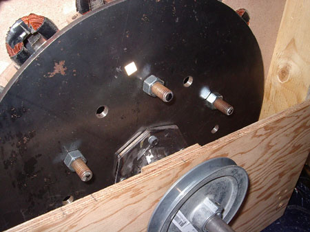

Note the threaded bar sticking out of the rotor. I drilled and taped six holes on one of the rotors to facilitate disassembly. They work like a charm and only 3 are really needed.

If that's open circuit volts and short-circuit amps, then your power figures are way off. For maximum power transfer, assuming you can constantly adjust the load for varying rpm, you need to use half the voltage, and possibly half the current, which gives you a figure of one quarter the power vs open circuit volts times short circuit amps.
For an air-cored axial flux machine, the internal impedance is fairly close to the dc resistance. Taking your very first line as an example, and loading it such that the load = the internal dc resistance;
 Coil                             0.5    60    9.3    18.6    172.98    173.0
9.3 volts open circuit into a 0.5 ohm load, 9.3/2 (4.65) volts into half an ohm
power = 43.245 watts (not 172.98).

This is calculated amps. Not short circuit. I read that short circuit amp reading is useless information. Just for kicks I tried to take a S.C.reading, as I did on my first genny, and the thumping was extremely powerful.
I think it is good that I've overcalculated. Does this mean I can calculate sweep area on the lower power values?

The wobble is less than 1/16 " x 2. I have looked for on off the shelf coupling or whatever for the 3/4" shaft. No luck so far. Any suggestions?

I put a load, 171.1 Ohms, and tested voltage. I didn't notice any difference in voltage. How can I test as you suggest?

The ratio of your open circuit voltage to your short circuit current should equal the resistance of the alternator.  I checked one set of your numbers, the 18 coils in series from the first listing and got 8.9 ohms, so your resistance measurement of 9 ohms appears to be correct.  You can use a Thevenin Equivalent model of a voltage source equal to the open circuit voltage in series with a nine ohm resistor to predict the current and power into any load for a given RPM.  For instance, if you connect a 9 ohm load across the alternator's output, half the open circuit voltage will appear across the load resistance.  You can calculate the power the load would need to dissipate from that.  I happen to have a 9 ohm 113 watt resistor in my possession, but even that might have too low a power rating.  Be careful.
I think you can see from this little discussion the importance of doing some study of basic circuit theory.

can't tell from your photo what your using now but
you will need something hefty to tie the rotors to the shaft .
some sort of mandrel(s) with set screws
maybe even a steel pully.
as long as it has a face that is a true 90 deg. to the shaft
 or a central spacer with two parallel faces .
now might be the time to get to know your local machinist. lol

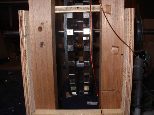

 I built a stator last night out of MDF, to hold all of the coils, and assembled it. Now the coupling of the shaft to the rotor has become a real issue. There is a lot of resistance in the rotor now and the shaft spins. I can only get the rotor to turn slowly. This even when no coils are connected to anything. I am working on a coupling today. Is this resistance due to the magnet/copper proximity? ie. the phenomenon of dropping a magnet down a copper pipe.

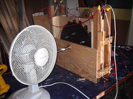

The coupling of the shaft to rotor is now complete. Tests have been done on open circuits and results are precisely as forecast. I can get a desk fan operating no problem. The 750 watt baseboard heater is another issue. The resistance on the machine is huge. I'm trying to push a 750 watt heater with a 450 watt drill. I'm starting to understand the concept of cut in and air gap. Currently I have a gap of .7 to .75 in. and the coils are just over .56 +/- in. thick. I need find a way to disconnect the load from the gen. until the voltage/rpm gets high enough or the darn thing will never get moving. Next I have to figure what size of wind catcher at what wind velocity will be needed to achieve this.

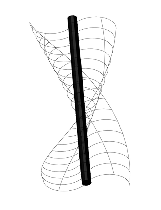

 I have designed a double helix in auto cad. Now my little brain is feverishly working at ways I might actually make it.
