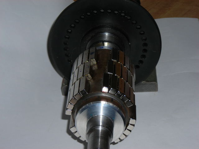

Well I have spent a long time in the studing mode and then finally took the plunge. Starting of with a 3/4 HP 220/380 3.4/2.0 1440 Rpm Motor.

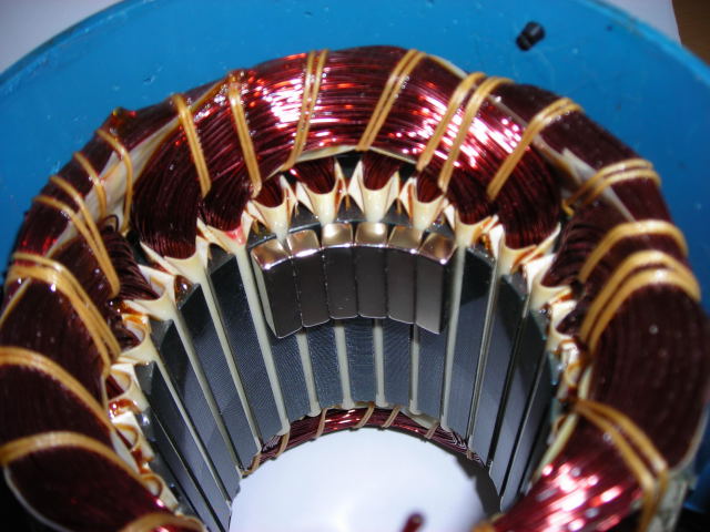

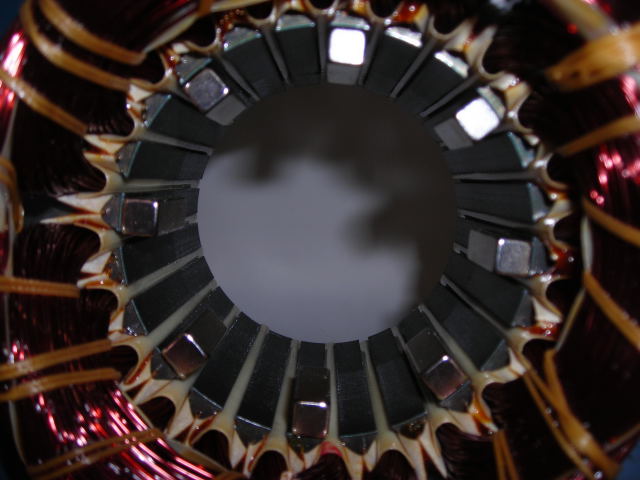

The first thing i did is set up the magnets in the stator to get the diameter of the rotor that I would have to make.
From info posted on this board from the late great Zubbly I then proceded to set up the magnets as they would need to be to cover the 5 of the stator legs (id of the coils) which worked out to be 6 magnets.
Then the real fun began. Making the rotor and putting the magnets on it.

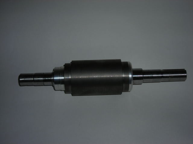

The rotor is made of grey iron stock machined to allow aluminum end caps to be pressed into it and onto the stock motor shaft. I used loctite 638 for this task.

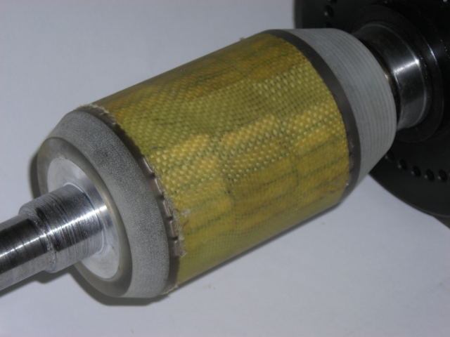

The magnets where placed on the rotor using Loctite 326. This took weeks as I placed each magnet on the rotor and gave curing time between each. In the beginning and end steps I was limited to only placing 1 magnet at a time but inbetween I was able to get 3 set at a time. I made a testing sleave with the proper I.D. to test clearances as I went along. Slowly step by step all 60 magnets found there rightfull place upon the rotor.
After all magnets where in place I laid up some Kevlar tape on the rotor and cast the unit with slow cure Epoxy resin. After casting I then cut down the O.D. to fit within the stator. In the end the magnet to stator gap is .047 of an inch and Rotor O.D. to stator is .012 of an inch.

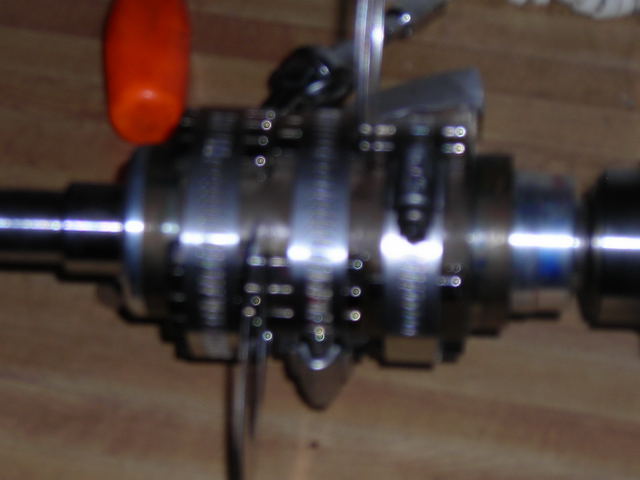

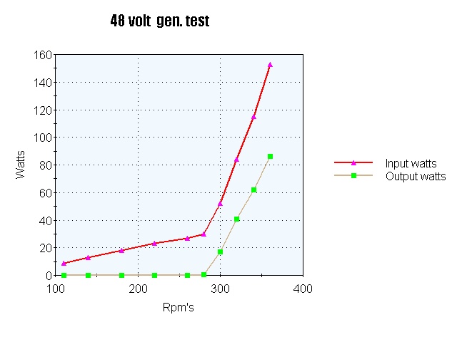

Many thanks to Flux for pointing me in the right direction to test input watts properly. I already has spinning the motor in my little lathe between the chuck and the tailstock. I just added a arm to the base mounting point that has a point setting on a gram scale exactly 1 foot from the shaft center line. By getting the torque foot pound reading and rpm's from a laser tach I was able to calculate input wattage. Ft. Lbs x Rpm's/5252 x 746 = Watts
With the Amp meter and volt meters attached to the batteries I calculated output wattage.

Nice work and nice data. Everyone else seems to measure output but ignore input.
Your data clearly shows iron loss below cut in and the efficiency on load.
With fast blades at tsr8 I think your iron loss will delay start up but once you get it spinning it should be ok. Looking good so far, I hope it works out.

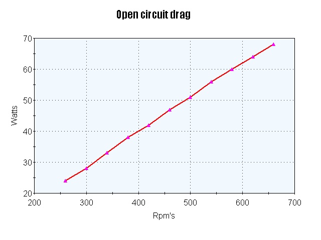

if it isn't too much trouble :)
how many watts input power does it take just to turn the alternator at speed
with an open circuit stator?
i would expect the answer being X
therefore X= windage, friction, cogging, iron losses due to hysterysis, eddy currents in the laminations, but
neglecting copper losses.
your 55% figures pretty close to what i would expect from a pm machine of this design, and really is not bad in my opinion

Re: Having fun (My first Motor Conversion)
« Reply #4 on: June 02, 2008, 02:35:36 PM »
You're off to a great start.  I especially like the wrap of kevlar around the finished product.  You've obvioulsy heard of the rotor burst protection layers in turbofan engines.  I must agree: nice job packing the magnets on, too.
I see 5 concentric coil groups, and can extrapolate that the 6th is hidden under the cropped edge of the picture.  With a speed rating like 1440, then I guess it's a european 50Hz type, originally with 4 poles, and you conserved that geometry.
I'm seeing about 60% efficiency when I look at your chart at 360 RPM, when you have less than 90 watts.  Once you ask for 560 watts, then the loss will be higher.  There isn't much cure for this with a motor conversion; even after re-winding you have the iron swimming in magnetic fields to overcome.  You can see that in the input power required before getting to cut-in at 280 RPM.
Say you have 5 ohms resistance as you have it connected now.  To get 560 W output, at 48V, the current is about 12 Amps.  Using I^2*R, that requires at least 700W, and don't forget the iron, about 100W more.  So... 560W out and 1360W in, you have about 40% efficiency.  Don't worry, that's pretty good.

« Reply #5 on: June 02, 2008, 05:56:58 PM »
Bob G
The open circuit drag is estimated on two run ups. I believe cold bearing grease add drag to my first run up.
A)260=23.82 WATTS
B)300=28.29
C)340=32.65
D)380=37.51
E)420=42.00
F)460=46.52
G)500=50.99
H)540=55.61
I)580=60.14
J)620=64.11
K)660=68.15
