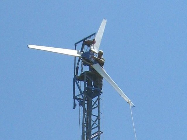

First up were my blades and tail sections onto the turbine. The stator was shorted so that the rotors could be turned but would inhibit the blades from rotating. With the stator shorted you can turn the rotors, it does not turn easily but this gave me the ability to align the rotor to the holes on the hub.
Here is a picture with me threading the nuts onto the threaded rod that holds the blades onto the turbine. I used lock washers, lock tite, and double nutted each stud:
Once the blades were on the brake actuator was engaged to positively keep the blades from rotating, and the guide rope was removed.

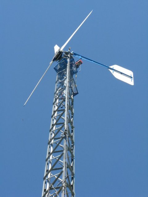

Next up was the tail this was a little more difficult as the lift point was a little bit off on the tail. The lift point should be slightly off center and away from the tail vane so that it can be put onto the yaw bearing easily, my lift point was on the side towards the tail vane making it slightly difficult to maneuver. But eventually I was able to man-handle it and get it onto the pivot point.
The next picture shows that the lift point was too far out and was also a reach for the winch as well:
The crane worked very well and I am quite happy with how it performed.

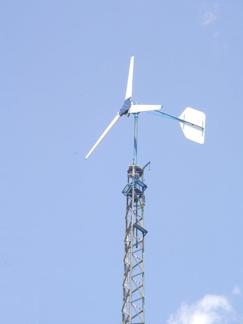

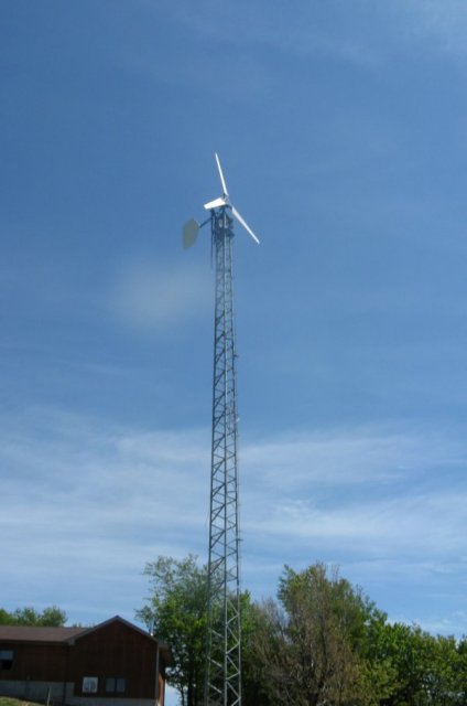

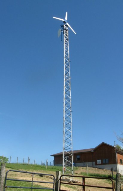

Here are a couple of pictures of the tower with the completed turbine, being that they were taken from downhill the tower appears taller than it actually is:

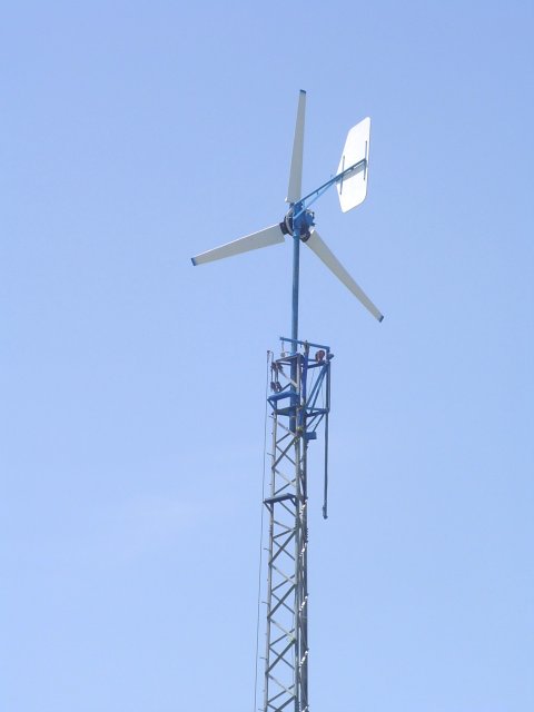

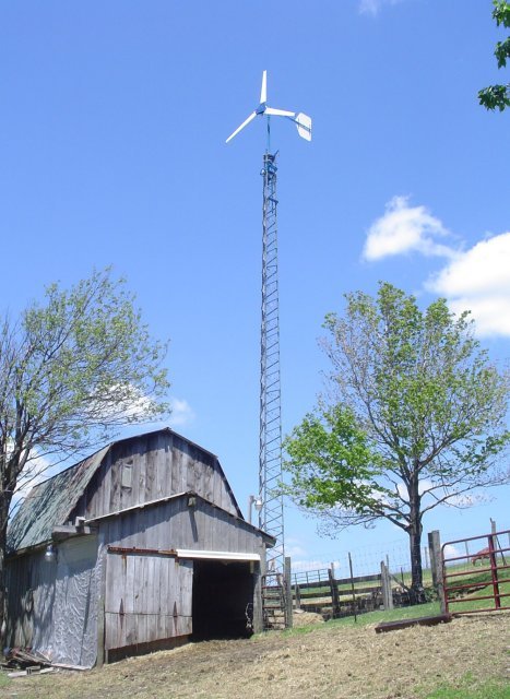

OK the weather gods were with me again, perfect weather with just a hint of a wind. Murphy is still around - but I beat him today - and got the telescoping stub raised!
In climbing the tower early this morning I realized that the lower mounting plate could not be removed for modification since 1/2 the lattice braces are located on the inside of the tower structure. So instead I loosened the bolts that held the lower mounting plate in position and when I got the winch mounted into place and gave it a try, this time it worked!
In my working with the design that I have I found one thing that repeatedly came back around - forgetting to design in allowances for things like hooks. It has been a close call on a couple of occasions (sometimes by inches) and I barely squeaked by with enough room or height.
But it all finally came together for me today and I got the wind turbine raised and into operating position.
Here are some of the pictures that I took from various angles:
In the next week or so I can finally get the turbine operational and get some electricity generated and data accumulated.
