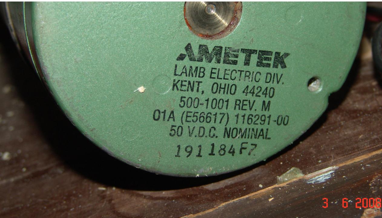

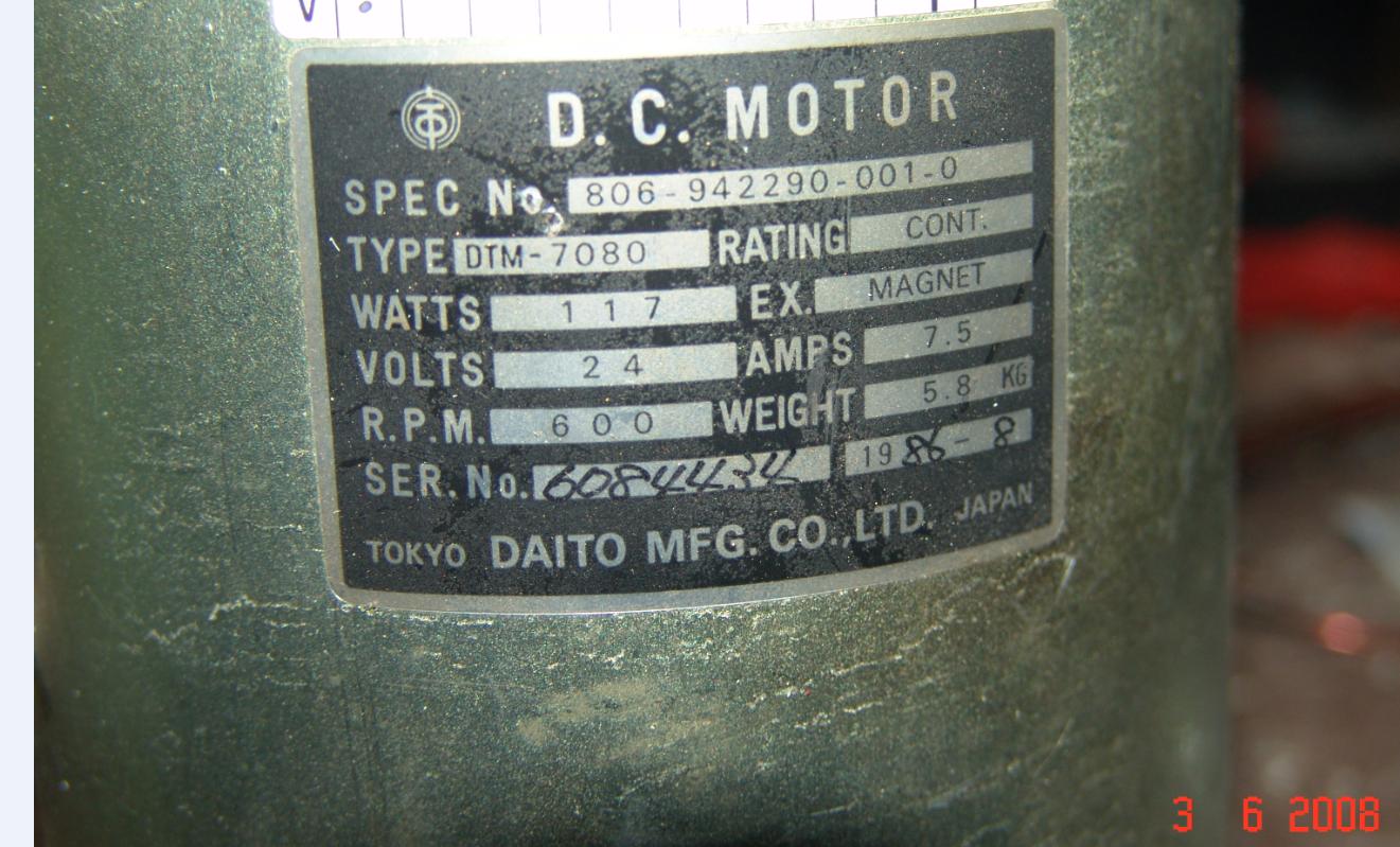

AMETEK 50VDC or DIATO 24VDC ?
Which one is better ?
I don't know the details of AMETEK except that is 50VDC,
Details of DIATO is in the Picture.
Please help me to choose the better one.
Best regards and Thanks in Advance,
Bhatti.

http://www.tlgwindpower.com/ametek.htm
this link to see what 50vdc Ametek you have...
hope it isn't the NO Good one....

« Reply #5 on: June 05, 2008, 10:53:00 AM »
WATTS: 117
VOLTS: 24
RPM: 600
AMPS: 7.5
« Last Edit: June 05, 2008, 10:53:00 AM by barshad »
Re: AMETEK 50VDC or DIATO 24VDC ?
« Reply #6 on: June 05, 2008, 11:18:21 AM »
That is information about a motor.  Nothing about a generator.
It may hit cut it at 350 RPM, if you have a 12V system.  And it may never make 12V at under 1000RPM.  It will burn up if it makes more than about 15A for very long.  It may never make 3A.
But that really doesn't help at all, because there is not enough info.
Look through Speo's posts and graphs about Ameteks and Indianas.  V/RPM and terminal resistance.  Whatever else he has posted.
Nothing more than WAGs until it is spun open and loaded, at a few different RPMs.
