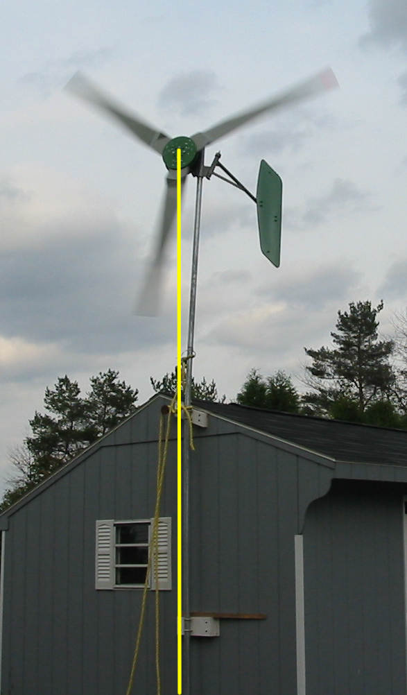

The support pole for my mill "failed" late last fall; that bummed me out at bit... The good news is that the mill was working long enough that the boss thinks we saved on electricity (I'm not sure it wasn't mostly conservation) and she has okayed a section of larger pipe to get it back up in the air.
A real tower has been a thorn in my side because there's no place for a guyed tower except in the front yard and that's been vetoed by the boss. Until I can get my self-supporting tower up, I put the mill up a short piece of 2" pipe bolted to the millshed.
I don't recall anyone writing that 2" pipe was good enough to support a 10' mill but I do recall someone writing that they wouldn't even use it for the last few feet... I can say now that using 2" pipe is surely a bad idea.
First real storm we got put a little bend in the pipe:
That didn't seem so bad but it wasn't furling,the angle of the tail assembly was all wrong on top of the bent pipe.

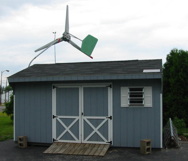

About a week went by without me getting around to it and another storm came along. I woke up in the morning to see the blades rubbing against the top of the millshed. Here's a pic after I strapped the blades to the pipe to keep the mill from turning:
As crashes go, that one wasn't too bad. The worst damage (after the pole) was a little ding in one blade where it hit the roof of the millshed at speed. I'm sort of glad it did find a way to stop itself as it was making well over 50 amps during the storm. I'd wanted to furl around 35 amps so I fretted about the controls (and the alternator) but appears I had enough headroom; everything seems to have survived at least as far as I can test things on the ground.

That was my thought, that the part sticking up over the roof was equivalent to the part that would be above the top guys in a guyed tower.
I don't think that the wind overcame the pipe all at once. I suspect that wind gusts over the previous few months flexed and eventually fatigued the steel to the point where the sustained high winds were enough to bend the pipe. If so, another demonstration of why its better to have the mill way up there away from the turbulence...

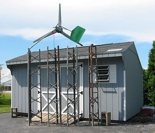

Hi Rich,
I've had this DMX-32 for a while...
My plan had been to use the bottom three sections and then brace it at about 14 feet up against peak of the garage attached to the house. With a pipe at the top, that would get the mill up to about 30 feet. (I had a brief exchange with mitcamp who has put mills on DMX towers and he seemed to think that that would work well enough.)
The racket the mill made against the shed, though, has me thinking seconds thoughts. Now I'm not exactly sure where to put it but I'll proceed to make a base for the bottom and something to hold a pipe for the top and hopefully I'll get the location figured out along the way.

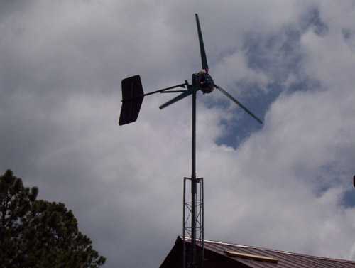

DanF had a tower setup mounted on the side of his house, I think I recall he or DanB mentioning that there was a bit of noise from it and that the setup was not ideal.  If DanF reads this, he can chime in on his experiences with that setup.  Here is the top of his from when I was out there in 2005:
He had the Art Randolph fiberglass blades on it then.
