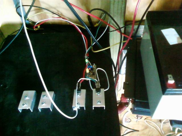

Next, I needed a controller.  This time I did some more searching and asked some guys around here.  I decided to go the www.ghurd.info route and bough two kits and the variable voltage regulator to help test things.  Ghurd has been a great help, Thanks again ghurd.  I am not exactly a soldering iron kinda guy, but I made it through without any Harry Pottering (magic smoke) so far.  Here are some photos.
This it the ghurd controler  hooked to a p-fet and a Schottky.  I have some extra heat sinks waiting for the next step on the left side.  Both the Green and Yellow LEDs are on, cause its fully charged, and dumping.

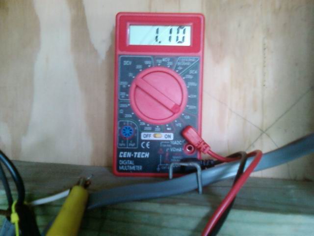

This it the HF $3 multi meter, hooked in just for measuring amps.

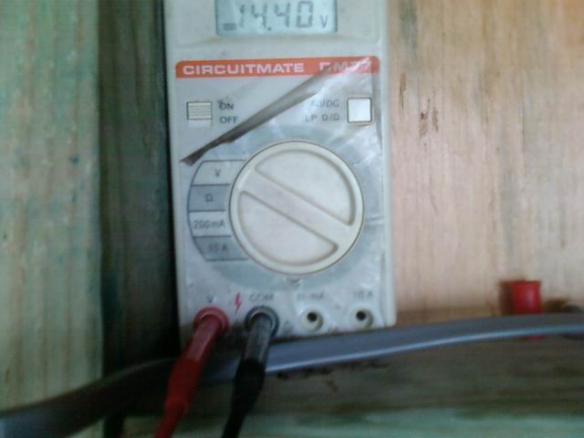

And another multi meter, for volts.  Starts dumping at 14.4 right on the money.

Looks good DrDave.
The kit has the 1N4007 D1 diode to protect it from reverse connection.  No need for a crowbar.

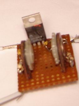

Well, after a miniute or so, the 7809 got a little hot and BANG !!!
I heard something ricochet off the back wall after flying threw the den and the living room.  Harry Potter for sure.  Than means sparks.
Here is a photo of the 7809 with the right half missing.

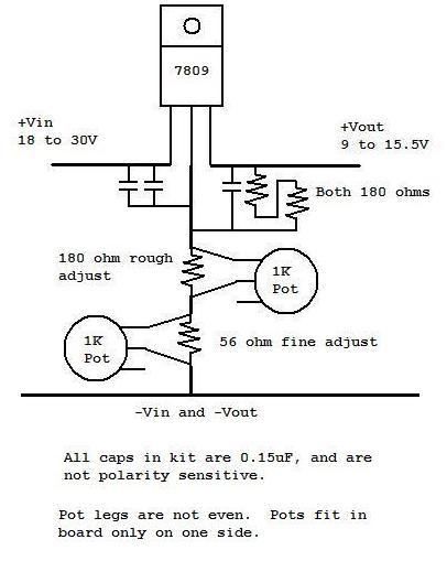

Woof, It is a variable voltage supply to set the controller circuit at an exact voltage.
http://www.otherpower.com/images/scimages/2050/VVcontrol2.jpg

"Why the 7809?"  Because that's what I sent him!
Simplest and Cheapest solution I could think up. See the link above.
It is set up sort of the same as a 317, but the output window is fixed between 9 to 15.5V.
No reason to go higher or lower.  And it won't smoke the controller circuit.
I have a feeling there may have been an issue with the connections in the mosfet/relay coil/flyback diode area.

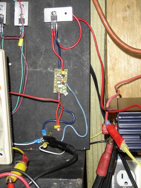

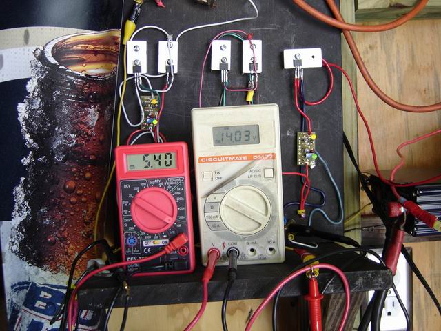

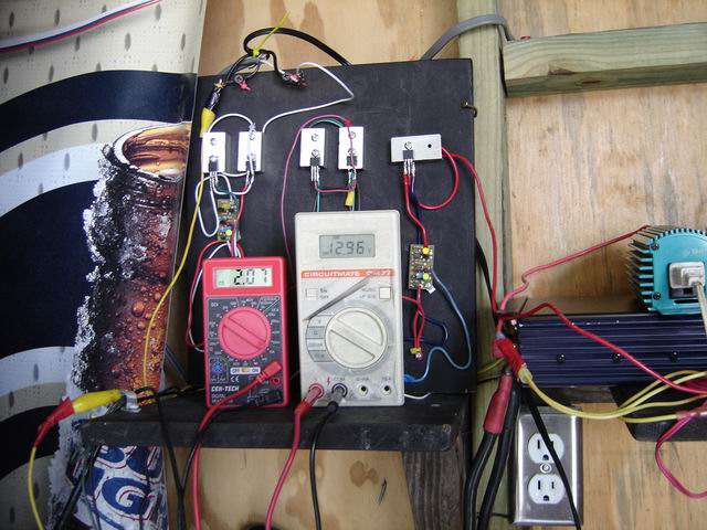

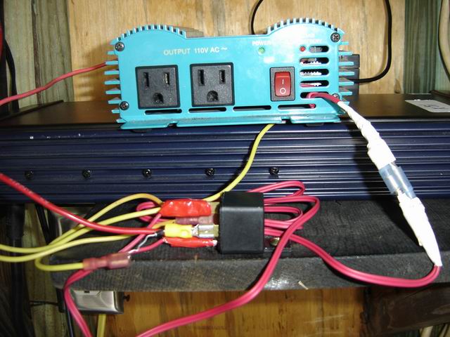

DrDave
  • Posts: 9
Re: DrDave's Solar stuff
« Reply #12 on: July 05, 2008, 05:06:00 PM »
Hey guys thansk for the comments.
At this point I have to post a hold harmless for I wouldn't want ghurd to get any flack for my lack of soldering skills.
The 7809 is used only in testing of the charge controler kit to make sure it stops and starts at the voltage you want it to.  Its not part of the live system.  Ghurd sent me another and I was able to rebuild the voltage regulator.  It worked great on my charge controller.  And then I tried it on my second controler kit, and it Harry Pottered again.  My second kit has a short in it somewhere.  I check the amp draw on it and its way out of wack.  So I built a third kit and a new voltage regulator last night and all is well now.
So I am going post some updated photos.
This photo shows my 400w (green) inverter that I have run some red wired in the vent hole and paralleled to the on off switch.  These wires got to the switch side of the Black relay.  The Coil side of the relay goes to the LVD which activated the relay at the desired voltage.
This photo shows the charge controler on the left of the black board, the LVD is on the Right side of the black board.  The red meter is measuring amps coming in from the solar panel and the right is volts from the battery.
The Charge controler has a green(power light) on and the yellow(dump)light is off.
The controler is charging the battery because the volts are below 14v at this point.
The LVD controller has both power(green) and active(yellow) LED's on.  That is because the voltage is above the disconnect setting.
This is a close up of the LVD it is just a controller and a FET.
I have a 1.8k resistor in Rx for a 1v hysterisis.
Here the battery is fully(volts at 14v plus, and the charge controller is dumping (yellow led on now).
Note the Amps, higest I have ever seen on 80w panel.  Must be a solar flair or something.
Thanks to ghurd for putting up with all the dumb questions.
« Last Edit: July 05, 2008, 05:06:00 PM by DrDave »

The 7809 is only for testing/tuning the controllers.  Turns out I did a bad solder job on one controller, causing it to draw major amps.  That's what caused the 7809 to pop while I was attempting to dial in a bad controller.
New controller working now like a charm.
