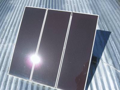

I've had these panels in the sun now for ~2 years. They are used in New Mexico, in the Catron county area so they get plenty of sun, and not much moisture. They have been feeding a 12v 240AH NI-CD bank. I know they are barely keeping up with the self discharge of these batteries, but for occasional lighting they work too.
Anyway here are some pics.

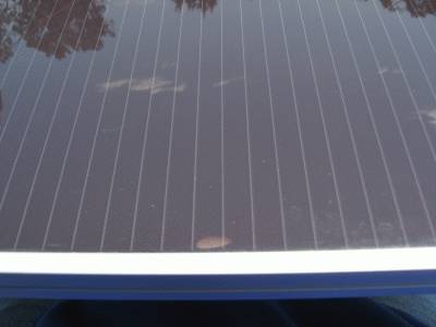

This 1'st one shows an area on one panel that has a clear patch on it, I don't remember if I received them with this smudge... It's hard to see but it's up close to the aluminum case in this pic.
This next pic is shows the setup sitting on the roof. I used the original bracket setup they came with, but added some screws and washers to make sure the panels couldn't slip out of the clips in the frame. I also wasn't sure how permanent my grandparents would want this so I placed a 2x4 under the panels and stacked ~70lbs of rocks on that to hold the panels down. They have stuck so far.

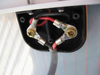

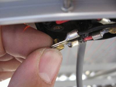

The next pics show the inside of the junction box on the back of the panels. I'm not sure if the corrosion was caused by the soldering flux or something else, either way I cleaned them the best I could and re-assembled. I need to put some di-electric grease on them when I can.

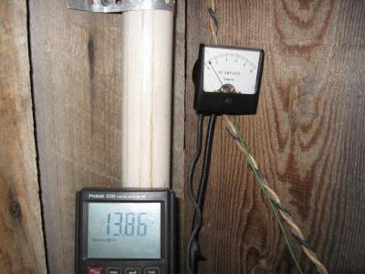

This Pic shows the panel output... pretty disappointing. I don't have documentation showing them brand new but I'm sure it was twice this amount.
If the picture shows up bad the volts read 13.86, and amps show just under 1 amp.

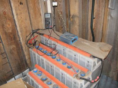

This is the current battery setup. the 6 lonely cells you see there are not being actively charged, they do get a boost from time to time though.
Also I had received the 1'st gen charge controller. It died a slow death, I'm not sure what the ultimate demise was but I felt that it was drawing more ah than it was helping to keep. Now I have a diode in it's place, I have a feeling that these batteries wont be overcharged without it.

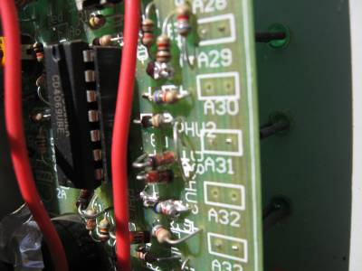

Here's a picture of the nice soldering bits blobbed onto the legs of some resistors.

Nil: you definitely would want to clean up those connections inside the terminal! some WD-40 or electrolitic grease is almost mandatory too. then...re-check the output of the panels. You could adjust the panels (at least by hand...temporarily) so they are facing square-on to a nice, clear sun. If they still don't put out close to 1.7 - 2 amps for all three, then we all know the panels are loosing their output. The voltage output looks low too, but should wait until cleaning those terminals, and possibly checking the output of each panel seperately.

If they are on a hot tin roof, that may be why your output is low. They have to be getting lots on sun, esp. with the light reflected from the roof.

The picture I took of the ammeter and volts is the amps into the batteries and the battery volts. I didnt test them unloaded. I know these panels have a fairly high unloaded voltage for being 12v rated(thin film of course) but have a really hard time raising the batteries to even 14.5 v.
I forgot about heat affecting the output. I looked at the picture info and found out the pictures were taken 3/22/08(I'm a professional procrastinator). Out there it would have been 80 degrees at most, defiantly not chilly but I'm not sure if the heat at the time had much affect on the output.

For a couple of weeks they DID do 40watts when brand new into my 12V batts.
But then they began doing less and less and less as the weeks passed by.
The instruction manual with the HF panels confesses:
"It is normal to see up to 20% (percent) degradation in amorphous silicon solar panels within the first 6 months life of the product before the amorphous coating stabilizes." -end quote
Well, my experience SO FAR is more like 50 percent degradation loss.  The 3 panels now do 22 watts (1.6A) max in high, Direct, strong sun in the summertime.
I have bought TWO sets so far, and they both did the same exact 'degradation'.
I hope it don't go down any more!  I got the first set a year and half ago, and the second set about 6 months ago.
I suspect my story is like many other new ones--- you don't have the $500 bucks to buy a quality 80watt solar panel and I was impatient to get started, so I got the HF for a couple hundred.
But now, I wish I had saved and got a quality 80watt $500 panel that will ACTUALLY KEEP doing almost the rated output for many, many years and last for 20 years and then you could sell them and get half (or more) your money back.
I am beginning to fear the HF panels may not last half that long.
Thus, I spent $400  for the two HF sets that together give me 3.2 amps (about 44watts// at 13.5v) in max sunshine.  Whereas, if I had saved and got the quality 80W panel it would be doing 60-70watts (AFTER initial 'degradation) and last for decades. (This is what I have gathered from listening from others who have quality panels here)  I personally have never bought and tested a quality panel yet.
