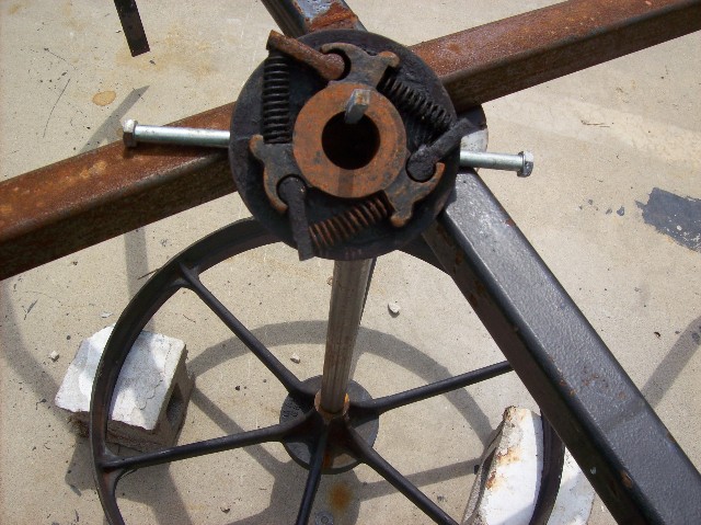

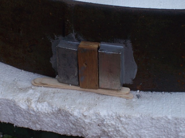

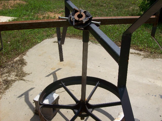

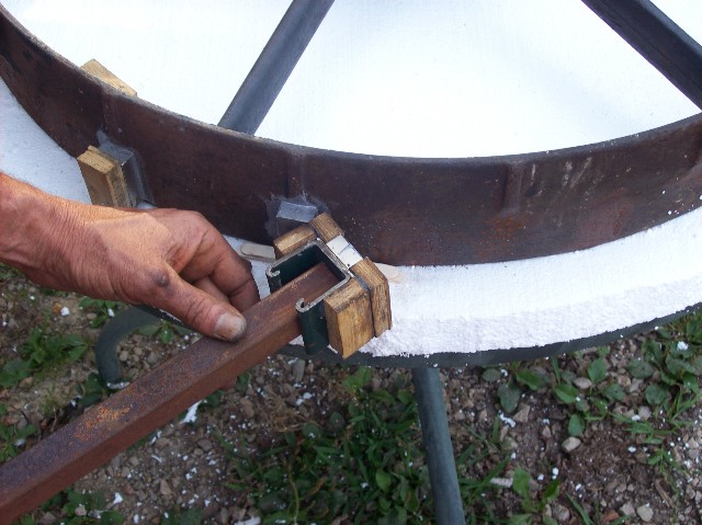

 It's nothing special but works awesome for me.Here's a pic of the tool if you want to call it a tool.
 The tool has a thin sheet of fiberglass milkhouse board for ease of loading and unloading.When the mag is set spacers are installed until cured.
 The density of the tools steel is less than the rotor for easy removal.
 The rotor is center punched in multiple spots where the mags sit and the mags are roughed up with a hacksaw blade.I'm using the epoxy i posted earliar on.Seems Nice
 Here's a pick after setting
 Havin fun and 52 more to go.

Mark;
Maybe its a "jig"??
« Last Edit: August 17, 2008, 06:35:20 PM by TomW »
Re: My Mag Setting Tool
« Reply #2 on: August 17, 2008, 08:12:25 PM »
Hi Tom
 Ya, gig or rig will work also.
 Has you can tell i've had mags do strange things to me in the past. :v)

 Something weird happened,I just got home from work and had a mag preloaded in the tool from yesterday.Coated it with epoxy and when it was in the set position the mag flew out onto it's neighbor.
 After rechecking the polarity,the mag was inserted wrong in the tool.So i guess it also has a failsafe built in.Don't want that to happen again.
 There are 18 tread marks around the wheel and using them has a guide.I think you can see them in the pics.

 I'm up to 16 so far and taking a day off on friday(hopefully),so should be done this weekend sometime.I give each mag time to set 1/2 hour and visit the board.
 I use a weak ferrite to double check polarity and it's cool when i move fast past the mags the vibration created in my hand.
 The tool is working fine and so is the poxy.
 I'm havin a blast.
