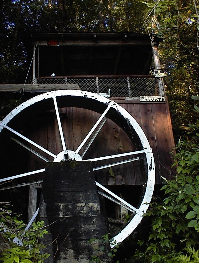

I want to do a story on this old waterwheel and generator from the North Carolina Mountains but I'm not sure about my picture sizing. Is this OK?
If I'm looking at it right it's about 98K. I have a bunch of pics of the insides with generator and controls but don't want to use up bandwidth.

     OK. This is at a cabin owned by very good friends of ours. It's located in the North Carolina Mountains not far from the town of Franklin where the Water Wheel Factory is located. http://www.waterwheelfactory.com/
     I got my first look at it about 8 years ago and knew right off I wanted to help preserve it. The first thing we did was to rebuild the sluices and get water flowing back to it. That was the hard part, re figuring what they had done back in the 40's. The old bearings had these big caps that you unscrew, fill with grease and then screw down again. We worked them pumping in lots of new grease till we felt we had purged as much of the old as possible. After sitting dormant for about 40 years it was turning again.

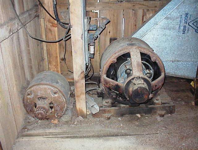

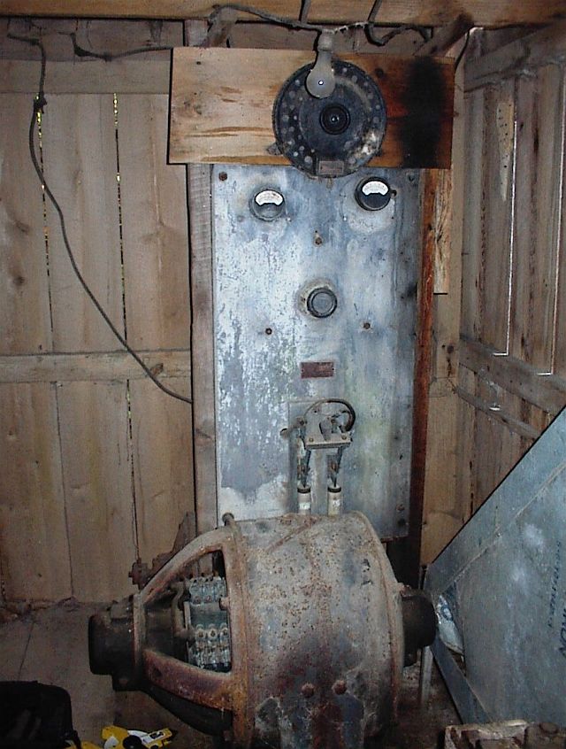

Inside looked like parts from Frankenstein's Laboratory
A shot of the gears
The Label on the generator said 14KW, 120 volts DC and if I remember the rpm's was something like 1500. Heres a close up

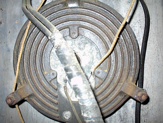

On the control panel there are two round knobs that turn, one in the middle and one on a large black round thing up top. This picture is whats behind the control knob in the middle.

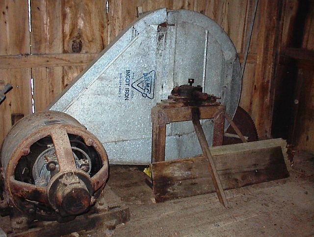

There's a second smaller generator that isn't hooked up. Maybe it was used first and upgraded.

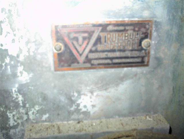

The Label on the control panel

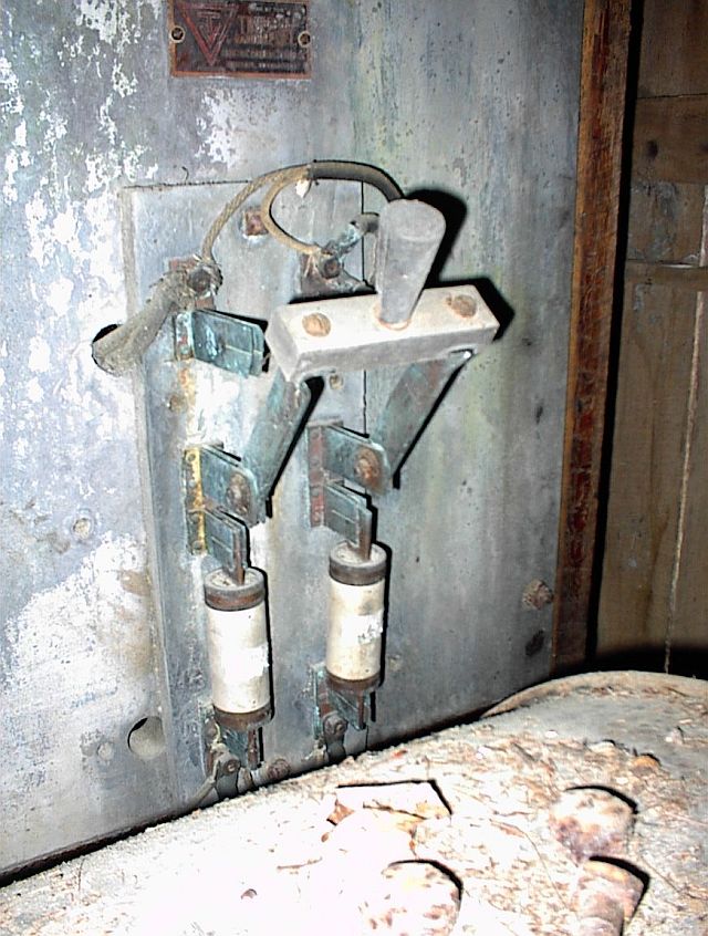

And my favorite, the knife switch

     The wheel is 12 foot diameter. On the same shaft as the wheel is a gear, 48 inches diameter. From that gear runs a chain to a smaller 6 inch gear. On the same shaft as that 6 inch gear (inside the shroud) is another 48 inch gear and from that gear runs a chain that turns another 6 inch gear on the generator.

The dc generator is probably shunt wound although it may have some compounding. The things with the knobs on are the field rheostats to adjust the voltage. Judging by the similarity of the appearance of the generator and rheostats to BTH equipment I would guess that they were from General Electric, although the styling may have been fairly common.
I expect it will still work if you clean the commutator and free the brushes if stuck.

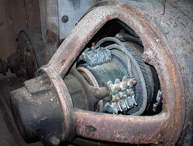

     Here's a shot of the label on the generator. It says, "Western Electric", a popular brand back in those days. Probably built by GE as Flux said and sold under the Western Electric brand name. I see I was wrong on the volts, it says 115. Sorry the pic is so blurry, I tried many shots and this was the best.
     I believe that it would still work. Nothing has been disturbed and the brushes still move smoothly against the springs holding them to the armature. Still, I think it is best left undisturbed and I don't want to mess with 14 KW of direct current. There is one chain in the drive that has been removed and hangs in another shed so that when the wheel turns now it is free wheeling, only needing a fraction of the water to spin it.

     Inside the generator are 4 big coils at 90, 180, 270 and 360 degrees. Halfway between 360 and 90 degrees is a fifth smaller coil. I suppose thats the one that gets the rest of the guts all excited. Maybe if I study hard and pay close attention to what you guys teach here, I may be able to make that old genny spin once again.
