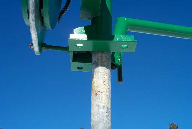

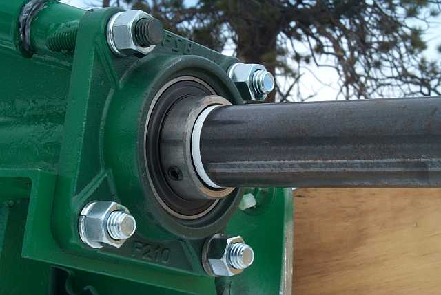

One of the things I learned was----the typical yaw bearing
(pipe over pipe) without something to spread the weight and the
wear is not a good idea. I've seen other postings here that confirm
that. It doesn't take long for the end of the pipe to wear through
the flat plate that's supporting the weight of the generator head.

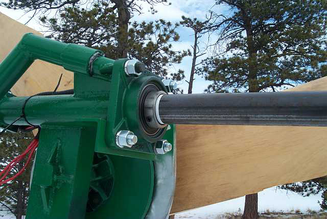

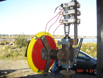

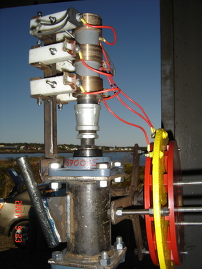

My solution is a 4 bolt flange bearing. Add a couple of pieces of
angle onto the bottom of the yaw so that the bearing has a flat
surface to bolt to.
Set the bearing so that there is a clearance of 1/4 to 1/2 inch
(6 to 12 mm) between the end of the pipe and the flat plate stopper.
Paint a white line around the tower stub at the point where the bottom
edge of the bearing will sit. The white line will tell you if the
bearing has slipped and the pipe is once again rubbing on the flat
plate. It's visible from the ground, so you will know without having
to lower the tower and check.
The next thing I learned was to install a grease fitting on the side
of the yaw bearing. I tried greasing the tower stub and then slipping
the yaw over it.
No matter how I tried, I always  ended up scraping half the grease off
with the end of the stub. The simple solution is to install a grease
fitting (or 2) during the building of the yaw. Put the yaw on the stub
and pump the grease gun until your arms hurt. You don't end up looking
like a greased pig! I don't have a picture of the grease fitting.

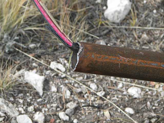

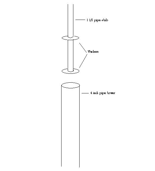

The lesson that really hurt was the one that cost me a set of blades.

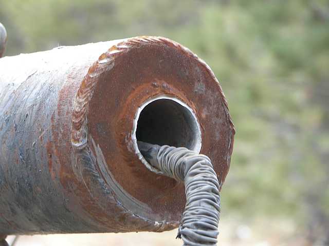

The tower stub needs reinforcing where it meets the tower. My tower
is 4 inch black pipe. The stub is 1 1/2 inch  black pipe. It never
entered my little brain that it would need bracing. The end
result can be seen in these pictures.
The stub was constructed of 2 large washers and the 1 1/2 inch pipe.
One washer, welded to the bottom end of the stub, slid into the 4
inch pipe. The other washer, about 18 inches up the stub from the
first was welded to both the stub and the top of the 4 inch pipe.
I just knew that was a very secure joint!!!  Wrong!!!!!!
Here is a picture of the broken stub after it was cut from the
top of the tower.

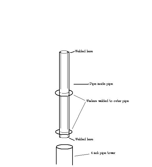

I now know that you either need some triangle shaped braces or
another piece of pipe inside of the tower stub.
At the time mine crashed, I didn't have any 1/2 inch thick plate
to make braces, so I opted for putting a piece of 1 1/4 inch pipe
inside the 1 1/2 inch tower stub. Those 2 pieces are welded together
on each end. Then the washers are slid over the 1 1/2 inch pipe and
welded into place. Then the whole assembly is slipped into the 4 inch
tower and welded.
That way if the 1 1/2 inch stub cracks and breaks where it
meets the tower, I will have a little help from the inside pipe. It may bend, which is
my warning that something is wrong. That way I can lower the tower and fix it .
Hopefully without destroying my blades again.

One other note on the bearing.  I have some similar appearing flange bearings, and if I recall correctly the rated load parallel to the axis of rotation was only 15 percent of that perpendicular to that axis.  I wonder about how long they will hold up under this type of loading.  I know DanB had some thrust bearing designed to take loading in that axis, and I had wondered about tapered roller bearings for a yaw type of application because a pair of them should be able to handle a fair bit of loading both perpendicular and parallel, although I don't recall off hand seeing anyone using any for a yaw bearing, and the cost for the sizes required might be prohibitive.  Rich
« Last Edit: September 26, 2008, 12:53:59 AM by richhagen »

The fracture could have been excelerated by the heat from the weld at the collar.  I have done pretty much the same, but placed a good three to four feet inside the larger section filled with cement.  Makes for a very heavy tower, but has removed all vibrations.  I am in the process of moving this tower, and once I head back out to the house will take a few photos.
But I do agree that extra support from the upper and lower portions can never hurt.  The stonger your support, the less problems you will face. :-)

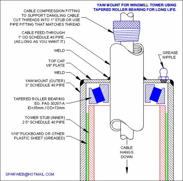

Re: Lessons Learned
« Reply #15 on: September 30, 2008, 04:47:43 PM »
Sorry I didn't get this posted sooner.  I must have hit "preview" instead of "post".
Here is a drawing of the yaw mount I built last year.  I actually don't know what tapered bearing part number I did use, but the FAG part number was handy.  I'm sure you can find a cheaper bearing that would work fine!
At this point, I think the compression fitting would work, instead of the series of pipe fittings I actually used.  I think an even better third option would be to use the cable relief straps - neat things but I haven't got a picture handy.
Using one tapered roller bearing, instead of a mounted ball bearing on the stub, you have a lot less heavy hardware up there, too.
One limitation with this design is that the grease going through the roller bearing flows into the stub, and falls to the bottom.  Probably not a big deal, but you can't just pump the grease gun until is comes out the buffers at the bottom.  It will never happen!  I guess I haven't completely solved the grease monkey problem.
« Last Edit: September 30, 2008, 04:47:43 PM by SparWeb »

« Reply #16 on: October 01, 2008, 08:40:55 AM »
Not only are you a generator builder, you're an artist too!!
Nice drawing.
Thanks for posting. I think I'll be using your idea.

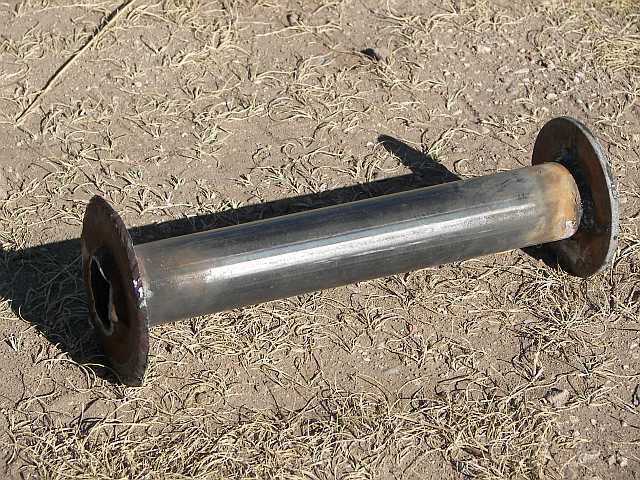

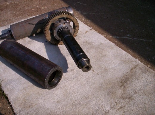

Here is another one - took it down yesterday when I noticed it wasn't yawing properly as the wind got up.
This is a picture of the stub mast that goes up into the yaw bearing, the top thrust plate of the bearing has a groove about 1/16 deep in it after only 6 months of flying but it too deep in to get a clear picture of it! You can clearly see the steel filings stuck into the grease making a thick paste that stopped it from turning.
I guess I'll be looking for Teflon sheet now...
