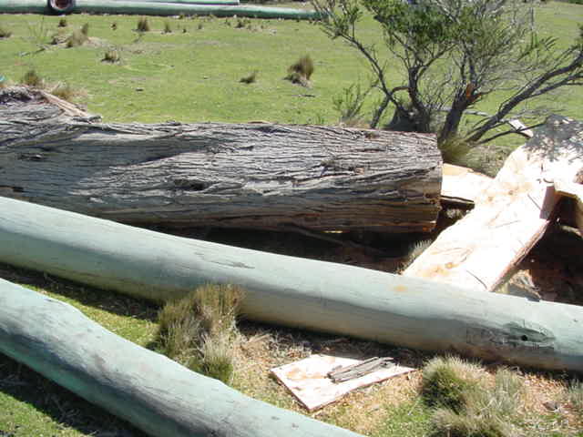

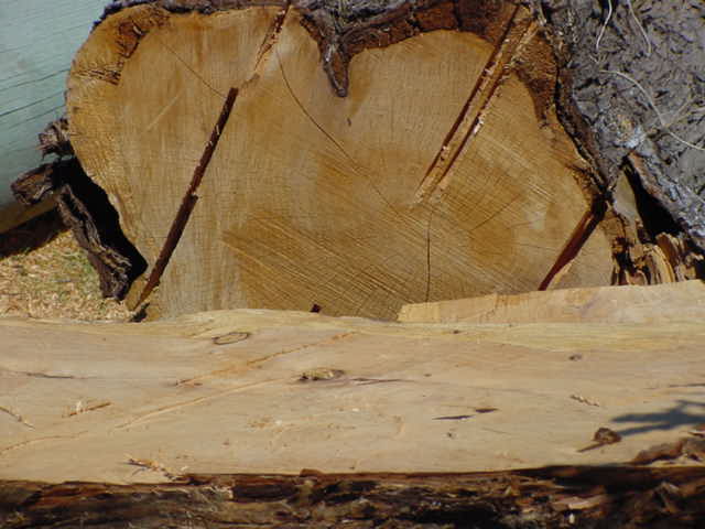

So we selected a decent sized Macracarpa log which looks like this:

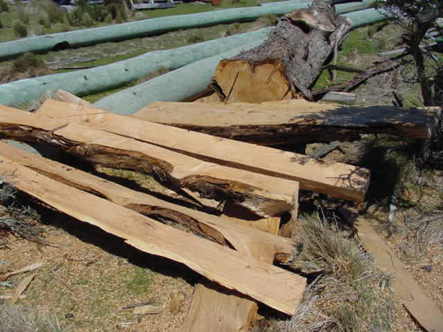

We hacked into it with Jamies 28" chainsaw and fashioned some very very rough planks,and lots of offcuts too:
You can see an offcut slab left behind as well as these offcuts:
Unfortunately I didn't take pics of the manufacture of the 10" X 2" planks . We cut squared up and true planks from the the slabs using the chainsaw jig method,.... that method can be found here: http://www.thebackshed.com/Windmill/FORUM1/forum_posts.asp?TID=1194&PN=2]    and then using the same jig method with a few of Danb's angles we cut the blades out.

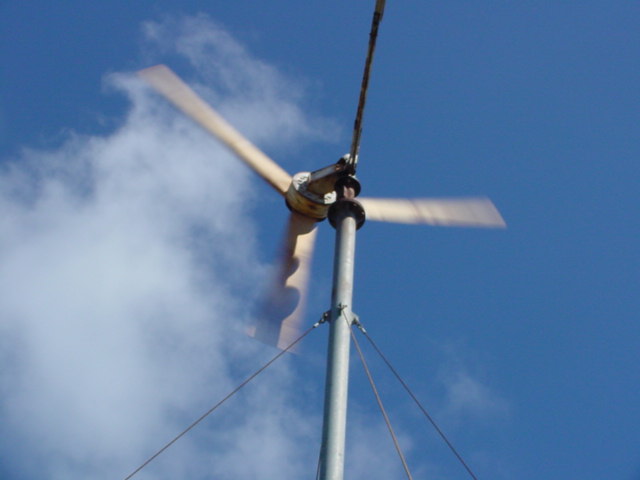

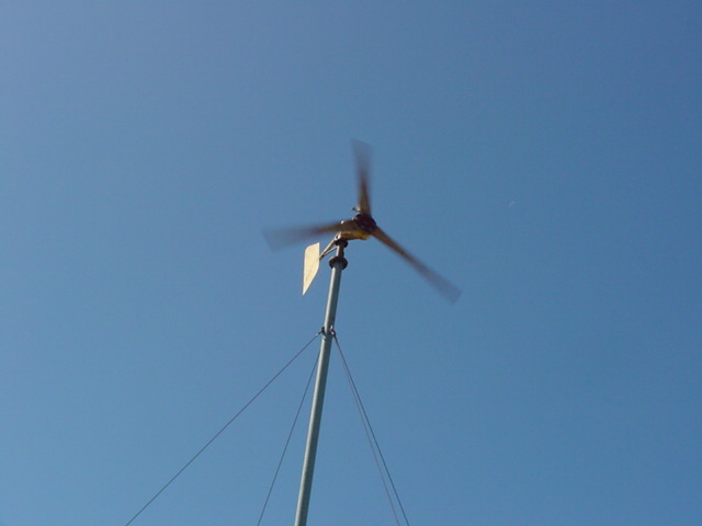

So it didn't take long to have the mill flying again. I went back up there today to take pics of them, So now we have fixed the injector pump on the Lister, and built , balanced and installed the blades...... of course the sun is shining brilliantly and the solar is putting out 1KW  instead of a few hundered watts, the mill steadily putting out  another KW. or more..... and the dump load working overtime again...... sigh.... it never rains but it pours.
(and more happy neighbours too)

The blades got a few coats of hot linseed oil,... second coat still damp on the way up.. so they do have some protection.
The mill will be coming down again to re-adjust the furling. We deliberately made the tail significantly lighter as we didn't know how or if it would furl with the different blades.
As it turns out, fully furled it does 25A@57v. In high winds (like we have today), it seems to be doing better than the original in the fully furled position.
In the intermediate winds, they do about the same, and in the light winds, about the same. In the light to middle, ehay try and furl in the small gusts,so we have made it furl far too early and it hunts about the place in the lighter- mid winds. So it needs a little more weight, and then it will probably out do the glass blades... which is a curious thing.
The AWP blades have a very heavily sculptured root area, and you would need 6" thick timber to follow it. we went for strength but with only 45mm thickness at the root, and barely an airfoil for the first 30%, after that we were more careful, and the last .....more so.
Tweaks.... we didn't sand the tips at the ends, but they are still quieter than the AWP originals.... in fact we can't hear them at all down at the genny shed... inside or out... so may not even do that.... otherwise they are as good as it gets.

1.4 KW fully furled (1.2 KW or so usable after battery storage) is sweet.
Bringing the tips down to an edge may improve the performance by throwing the tip vortex farther out, reducing the depowering of the outer half-foot or so by air running around the end of the blade.
(I'd once thought of screwing a "wingtip" airfoil onto the end of the blade to block the run-around air, ala the "wing keel" used on shallow-draft sailboats to make a short keel act like a long one (as long as you aren't listing too badly)  That would be a piecewise approximation of a ducted fan.  But a NASA design document implies that you can get much of the advantage of that, with far simpler construction, by making the tips knife-edged.  Which brings up the question of why wing keels work better on boats.  B-)  Maybe it's because, with the knife edge, you're reducing the loss of the low-pressure on the downwind side but you still lose the high pressure on the upwind side.  But intuitions about fluid dynamics are notorious for being faulty.)
