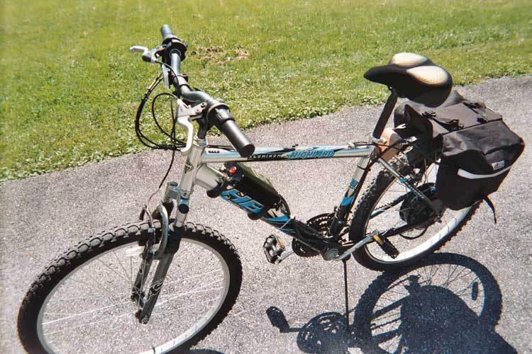

My humble Wally World Special

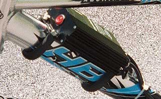

  The Crystalyte's 48v 25amp controller moves the bike right along!! Top speed on the flats is about 25mph. I've used as little as 10wh/mile of power consumption when pedaling. I plan on getting a front motor hub as well, to make the hill climbing easy, two motor hubs, two controllers, and one throttle!!! It will crazy dangerous, with a top speed of 45-50mph!!! I think I'll be changing out the front fork first!!
Just used a couple of "U" bolts with rubber hose over them for mounting the controller on the tube. It's always nice to have the kill switch were you reach it!!!!

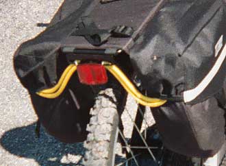

I used 8awg wire between the batteries instead of 10awg, hoping to reduce "sag" which did help a little. The saddlebags have held up well, considering the 40lbs. of SLA's they're carrying down bumpy Vermont roads.
So far, the range has been great, 16 miles on a charge no pedal @ 20mph average, and 28 mile on a charge with pedaling @ 15mph average. (48v 12ah SLA) I'm working on getting the regenerative braking system up and running too, which the range a bit more!!

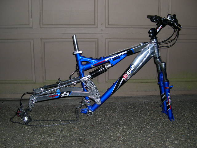

Just got myself a Schwinn S60 full suspension frame for FREE!!:>
This frame has got to be a lot less harsh to ride than the other one on these rural Vermont roads :?
I'll post a new thread when I get some pictures of the build.
