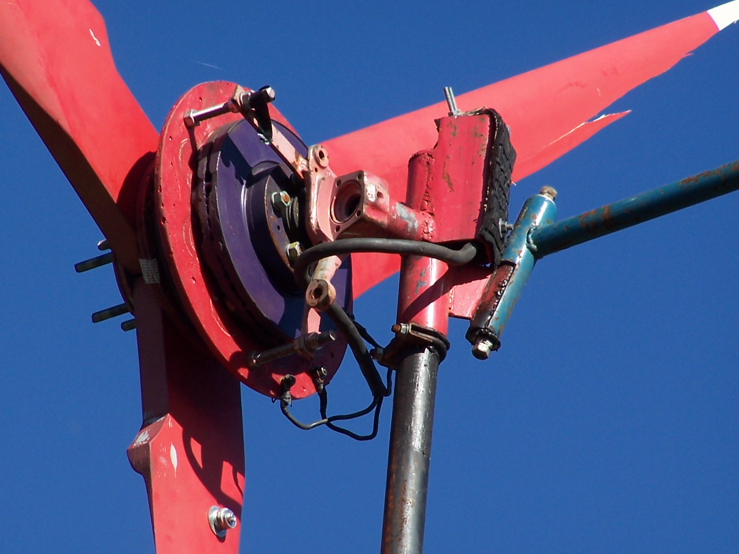

It was still pushing 200+ watts looking like this before I shut it down
http://www.otherpower.com/images/scimages/4/2ndbustedprop_1.jpg

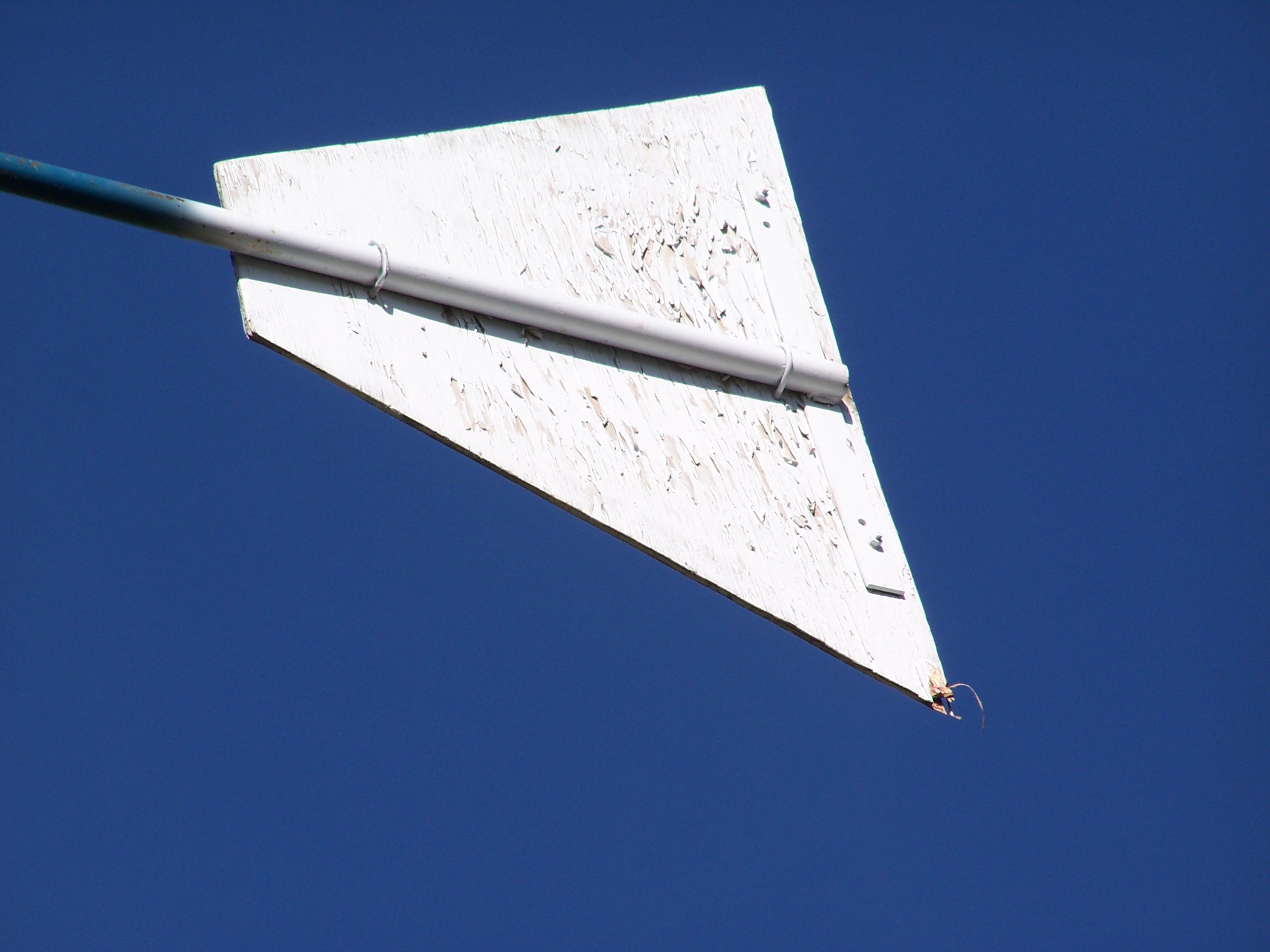

Looks like it smacked the tail [again].
http://www.otherpower.com/images/scimages/4/2ndtime_tail_ding.jpg
Had this up a couple three weeks [this time] on my "test tower"at 30 feet. Fierce winds a couple days and when I went up to check on things it was yawing pretty early and seemed to be running smoothly pushing a steady 10 to 20 amps. So I let it fly.
This also happened awhile back on this machine but I made some mods [boom stop] that should have prevented the tail getting even close to the blads.
I am in a pinch for time so thats all I can post just now.

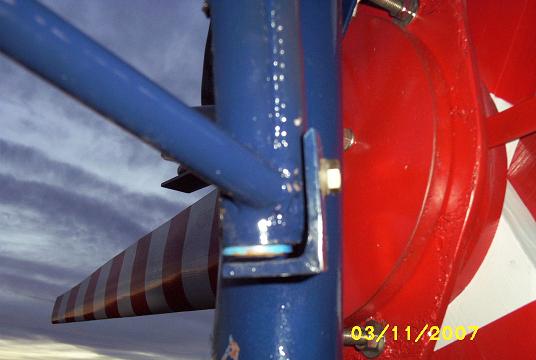

Here is a closeup of the yaw setup. Solid metal stop with a tire tread bumper as well as a thru bolt to keep the yaw bearing from coming off.
Again a large photo so just a link.
http://www.otherpower.com/images/scimages/4/2ndpropfail_yaw.jpg
Only found one piece of prop about 75 feet downwind so far.
Thanks for the response.

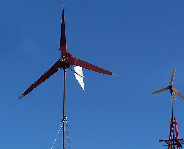

The other turbine..
« Reply #7 on: October 29, 2008, 05:16:46 PM »
hiker;
The other one is a Zubbly built conversion. No furling 6.5 foot diameter. Its built like a tank going on 3 years up with no maintenance. Zubbly wanted me to "test it to destruction" with no maintenance so thats what I am dong. Sadly, it has outlasted him. It has been hammered by 70 mph gusts [airport station 5 miles away gusts] and a sustained wind event of 45 MPH for most of one day. It just keeps on keeping on.

Admitting to one's own mistakes.  I admire your candor.
How does the nicked tail figure into the tale?  Struck by a segment of blade as it flew by?  Damaged on the ground, even before it was raised, and only noticed now?
Good luck with the new prop.
« Last Edit: November 05, 2008, 01:55:49 PM by SparWeb »
Re: Postmortem Forensics reveal....
« Reply #16 on: November 05, 2008, 04:31:46 PM »
Steven;
No clue about the tail but it didn't appear to be as "fresh" as I would expect from having happened in this incident. The damage is odd in that it is a divot into the corner that crunched the inner laminations  which would seem odd for a moving strike from the prop which you would expect to tear away material rather than "bounce" away?
As far as admitting mistakes, isn't that what any honest man would do?
My old school upbringing is showing I guess.
Thanks for the comment.
« Last Edit: November 05, 2008, 04:31:46 PM by TomW »
