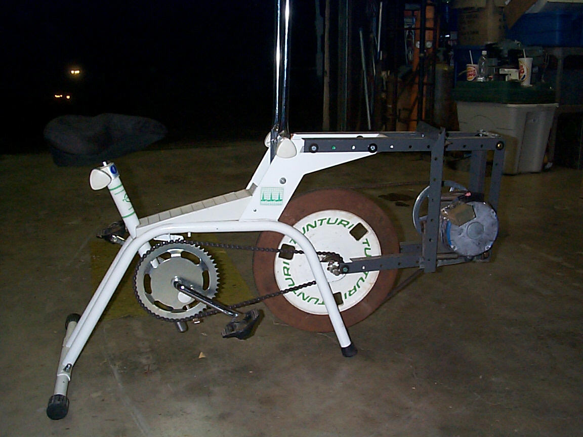

This is my entry. Its a 6 pole motor conversion. Iwas able to light a 100 watt light bulb but for a very short burst and then much rest.
I left the motor wirering stock. Also power up a small B&W tv.
« Last Edit: October 30, 2008, 07:47:49 PM by Jerry »
Re: Pedal axial flux?
« Reply #4 on: October 30, 2008, 08:34:23 PM »
a real simple pedgen can be made  from an old exersize bike..
you can keep the flywheel or change it with a  bike rim--just
use a flat belt from rim to gen..
lots of old exersize bikes at thrift shops-cheap..
check out my pedgen  files--
heres a mov. clip--motor conversion 300+volts..straight ac out-hooked direct to a tv..
http://www.otherpower.com/images/scimages/1236/stereo_test_motormill.MOV
no real big loss in friction ...puts out close to 300watts when coils are wired in parelle[3 -110v- 100watt lightbulbs]
« Last Edit: October 30, 2008, 08:34:23 PM by hiker »

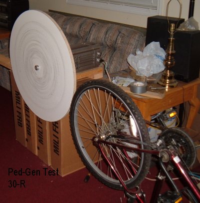

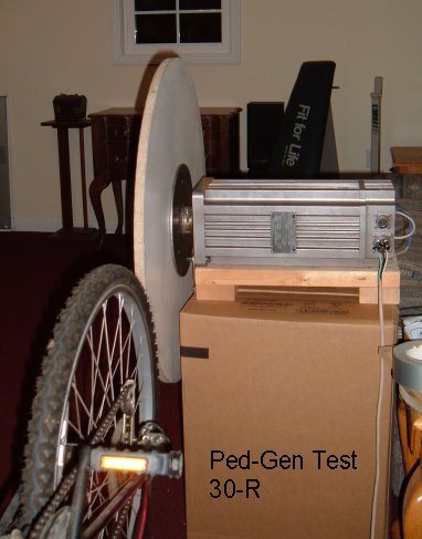

On the other hand though, if the alternator were big and heavy enough (like 40-50lbs spinning), it might just be a decent enough acting flywheel at that low rpm.  It's difficult to say.
Another nice thing would be that it would be almost silent running. Great for watching TV without headphones. This is important to me.
I've been doing some experimenting around with my big flywheel idea and it sure does seem to help a lot in getting more power with a 'semi-casual' physical effort.
I am not a work-out freak or something---but I would like a nice 'semi-casual' 30 minute workout every few days primarily for excercise AND to get some usuable power on a gloomy, no wind day.
That is my objective. My goal (challenge;hope;dream;etc) is to average 100watts during this 30 minute workout. (total= 50 watthours)
I want to start out with 120watts for 10min  ; then reduce down to 100watts for 10 minutes ; then reduce down to 90 watts for the last 'easy' 10 minutes. (total=30min workout)
Anyway, that is my goal, I don't know if I can acheive it yet though, nor if its similar to your idea of 'a workout' or what.
I am still working on my design but maybe you might get an idea from it.
Obviously I have a very efficient giant AC servo-motor (only 1/4th ohm coils)as the generator. (it failed with the VAWT sadly--so now it will find life as a big ped-gen)
Here is a couple pictures of my test with the big 30" dia. particle board flywheel.(one equals 16 lbs. // I intend to attach a second one to make a 32 lb flywheel plus the approximate 40 lbs of rotor spinning inside the motor. (total about 72 lbs of 'flywheel' spinning)
Keep in mind, this is testing.
For now, I have to hold the 10-speed (in it's 10th fastest gear) bicicle to the big 30" flywheel with one hand while pedaling with the other hand.
So pedaling with only one hand I am getting a fairly easy 5 amps (14volts at the 12Vattery) which is about 70 watts going into the battery.
But it is difficult to hold it while pedaling though. It keeps slipping off the edge of the big flywheel since I don't have the other second piece of 30"dia. particle board attached yet. Sometimes it goes to 6amps.
I am very certain that I can achieve my 'semi-casual' pedaling at 7 or possibly even 8 amps.  So I think I can do it.  Of course, pedaling hard for a short time I expect it will go way higher.
Anyway, it is a fun and interesting challenge to try and get the most efficient Watthours you can get in the least time!
-Good luck with your testing and design.  Look forward to whatever you come up with.

« Reply #10 on: November 08, 2008, 05:48:34 PM »
Ben, (and everyone else),
I was inaccurate about the 7 or 8 amps I was hoping (dreaming of) for above.
I finished my big 100lb Servomotor ped gen just a few hours ago and tried it out and BOY was I wrong!!
Keep in mind I am MEGA OUT of shape which is the main reason for doing this.
I found out I CAN get over 200 Watts (13Amps//15V at the 12v batt) for a brief peak time with the giant servomotor and Flywheel and a 12-speed bicicle.
BUT, I can't keep that up for long! Also, even though 7 amps (100watts) doesn't seem that hard at first, after a couple of minutes it starts to change my mind quick!
I am VERY glad I made it since this proves I NEED excercise badly.  But right now I can only maintain 4 amps (50watts) for 10 minutes, then 3amps (40Watts) for the remaining 20 minutes. (feels like free-spinning) (Total is About 21 Watthour)
Since I haven't 'Worked out' in about 20 years or so, I fell to the ground to rest after this and my heart hasn't stopped beating hard yet. So it was a good workout.
After I get more and more in shape, I hope to eventually work up to a 35 Watthour 30min workout.
But it won't be easy thats for sure!
This Big flywheel ped gen is TWICE as much power though than a small treadmill ped gen I had made a year ago. I could only get about 20 watts from a 'semi-casual' effort from it.  So I do get twice the efficiency and power (WH) with this new big pedal generator now. So I am happy about that.
I still need to add the other particle board circle to the flywheel and then I will see if it increases the 'Mechanical efficiency' even better.
I will post about it soon in my diary. Maybe you might get an idea.
Good luck with yours Ben. It will certainly be good for your health!

« Reply #11 on: November 09, 2008, 12:34:49 PM »
I want to thank Ben for posting this--because it made me get off my lazy but and finally finish my ped gen.  Now I am getting much more power (WH) because I had had tiny ga. (22ga.) wire wrapped around 6 diodes and it was causing a lot of extra resistance which was costing me a lot of power. I now added more wrapping wire.
So my guess initially was actually close. Now I am getting 40watthour in my 30min workout. (Twice as much as before!)
I bet I can get 300watts briefly now going into the 12v battery. (afraid to blow up my ammeter)
It really teaches me about the VITAL importance of line resistance.
I am now averaging 80Watts and it is really not that hard. I'm not even breathing heavy after now.  That first time I had wore myself out at the beginning doing over 100watts for a few minutes.
Now, my father and brother are working out on it also. (more free power for TV later!)
I forgot to mention that the gear ratio of my ped gen is only 3:1     -Thanks.
