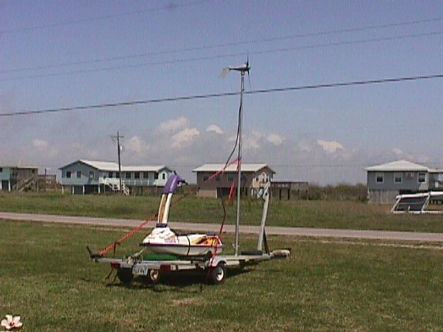

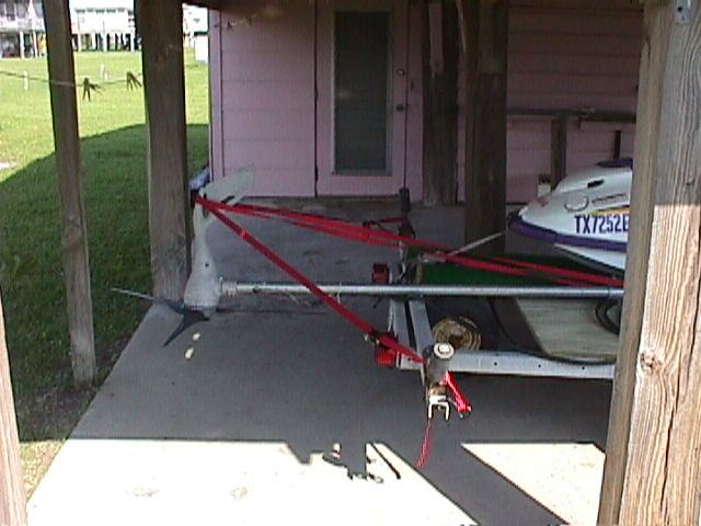

Here you can see how my previous trailer mounted windmill traveled:
This was fine for the jet skies because I did not launch them off of the trailer, but I want to be able to launch the Walker Bay directly from the trailer so having the Air hanging off the back of the trailer would mean dunking it in sea water on a regular basis.  So that it out.
My other concern is the mounting of the tower.  I envision a 1.5" x 6' pipe mounted sideways across the front of the rectangular trailer section, with a 2" sleeve that can slide back and forth and rotate.  That sleeve will have another 2" sleeve welded to it at 90 degrees.  The 21' 1.5" pipe will slide through the top sleeve (front to rear), allowing the 21' pipe to slide 10 feet forward, to the front of the trailer, when traveling.  Once arriving on location, the boat is removed.  The 21' pipe is pulled back 10', until it hits a stop in the end of the pipe, and locked in place with a trailer hitch pin.  It is then raised with the winch on the front of the trailer.
I plan to use 5 guy wires; 2 in the back 8' apart, 2 directly beside the tower 8' apart and one in front.  The front(1) and rear(2) guy wires will be 10' from the base of the tower.  The side guy wires will be 4' to either side.  So 4 of the 5 wires will attach to the supports that used to hold the catamaran and the 5th will be on the front of the tongue.  The 2 wires in back (as opposed to 1) should allow the boat to be put back on the trailer once the tower is up.

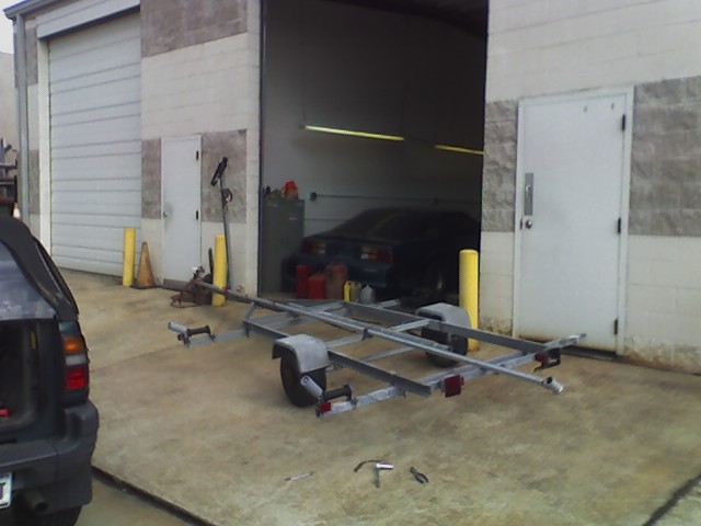

Here is a new picture of the trailer I plan to use for this project:
I will be relocating the various rollers for the Walker Bay, which will leave the old Cat support bars bare.  You can also see the 21' 1.5" pipe hanging off the back.

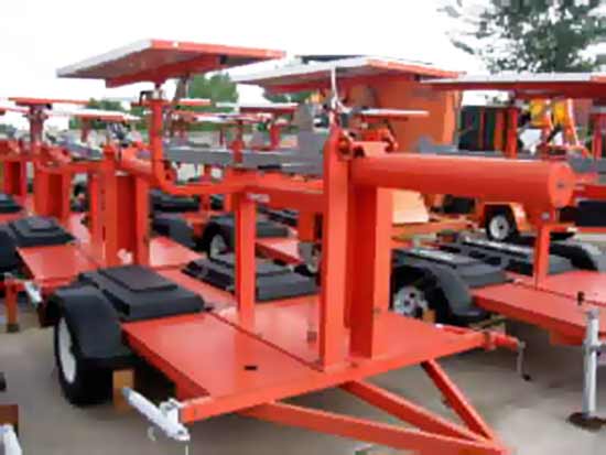

Seeing your project made me think of these, I believe these are being surplussed from the I-35 bridge collapse that happened in Minneapolis. I hope you get some ideas!
Equipped with: 2 - 123 watt solar panels, with tilt option. Solar Panels are Sharp, Solar Module ND-L3E1U, 12 - 6 volt deep cycle Trojan batteries. 4 Jacks. Complete trailer tail light wiring. 2000lb Axle. 2 Manual Winches. Sunwize Stecca Solar Regulator. IOTA Battery Charger. 7' x 14'. Also had a 30ft mast that ~was~ equipped with either a camera, a light or some type of sensor.
« Last Edit: November 12, 2008, 09:46:13 AM by Airstream »

These things are nearby me here in Twin Cities. I'd love to say I could deliver one to you for $2000 purchase price, 5% commission and fuel & tolls since I've never seen the Gulf Coast at all...
Since we are talking maybes, I would also love to say I do need two more Sharp 123W panels here to finish making up a 48V array and I'd buy the trailer up here, rob the panels off it and deliver it there for bunches less than $2000... Also they claim to be willing to negotiate purchase price if multiple units are bought - maybe they would negotiate with cash in hand on one unit too, but with my luck you wouldn't like the color and refuse delivery once I got there! : )
I doubt the batteries have been well maintained - it would require a day testing the units they have left, panels, battery electrolyte Sp Gravity, charger function etc...
« Last Edit: November 12, 2008, 02:53:45 PM by Airstream »

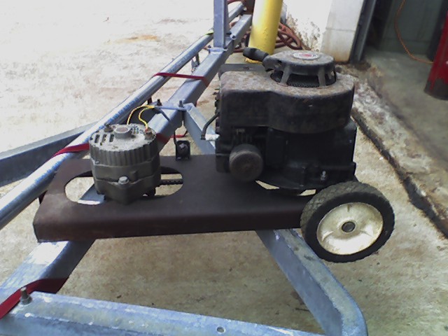

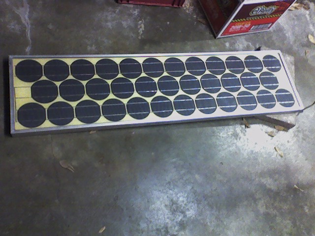

Here are a couple of pictures of the other components that I plan on using:
The 40 watt Photowatt panel.  It is approx. 1' by 4'.
The home made lawn mower generator.  This was inspired by theepicentrer.com plan.  But I built it out of some scrap U section, which provides a built in belt guard.  The engine is a 3HP 148cc Briggs and Stratton. I used a 2" pulley that is about the same size ass the one on the alternator.  I re-used 2 wheels from the donor lawn mower.  I intended to put a rubber suspension stop on the other side but have not gotten around to it yet so it bounces around a little when running on concrete.
I cut the holes with a plasma cutter.  First I cut the top off of the old lawn mower frame and used it for a template for the motor hole.  There is about 8" of travel for the alternator, so I can use a variety of belt lengths.
I hope to get some gauges hooked up one of these days so that I will have more than anecdotal evidence as to the output of the various components.  Probably some cheap automotive amp and volt meters.

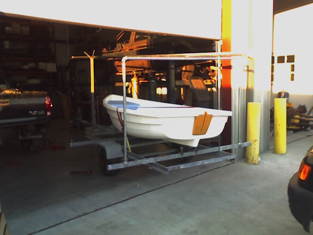

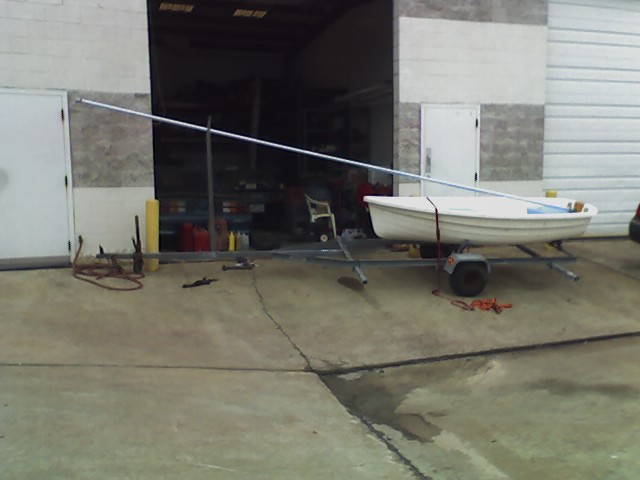

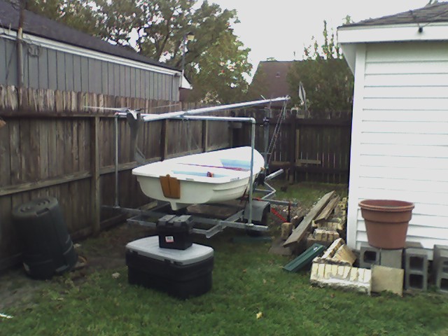

Here is a picture of the trailer with the Walker bay on it.  I also have the 21' pipe on top, in roughly the location that I intend it to travel.  I still need to construct a rear support that will hold the top of the tower and the Air 403 while traveling.
The Mast support that is holding the pipe in front rises 5' above the trailer frame.
Now I have to make a decision about how the tower will be mounted and supported.  There are two options that I have thought of so far:
#1 Leave front support more or less where it is, maybe a foot or two farther back.  Pipe will pivot at top of front support and will have guy wires attached to tongue (6' away) and front cross bar (6' back and 8 feet wide).  This will give a total of 3 guy wires.  They will be positioned MUCH closer to the tower base than I had originally planned, but it will make for a very simple mechanism. I hope that the strength of the Cat's mast support will make up for the small guy wire base.
#2 Move Front support to just in front of boat, at the very back of the Triangular section.  Rig a collar and pivot on the top of the support so that when traveling the pipe can be slid forward, then slide back when it is time to raise it.  Go with 5 guy wires in the locations mentioned previously.  This will be a much more complicated mechanism and the pipe will not be as well supported when traveling, but it will have better support when erected.  This configuration will also place the mast support right where I had intended to put the battery box.
In either case a winch will be used to pull the bottom of the pipe down and back when the tower is raised.  Once it reaches the full upright position, the bottom of the pipe will seat in a cradle, where it will be pinned in place.  Then the front guy wire will be attached to the trailer tongue.
I prefer option #1, for several reasons: Easier to construct, better traveling geometry and will not interfere with preferred battery box location.  It will also be a much simpler guy wire arrangement with only 3 wires.  It will all be in front of the boat and will not interfere with the boat in any way.
The only draw back in the smaller guy wire base.
Any opinions?

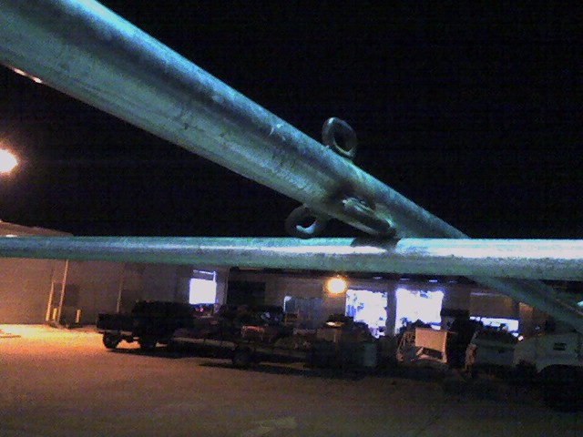

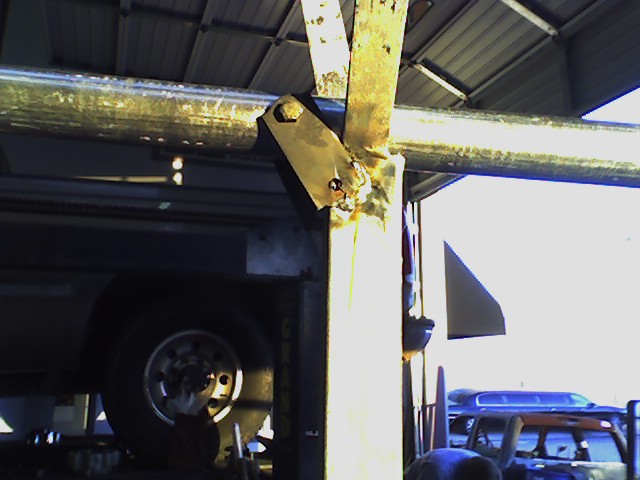

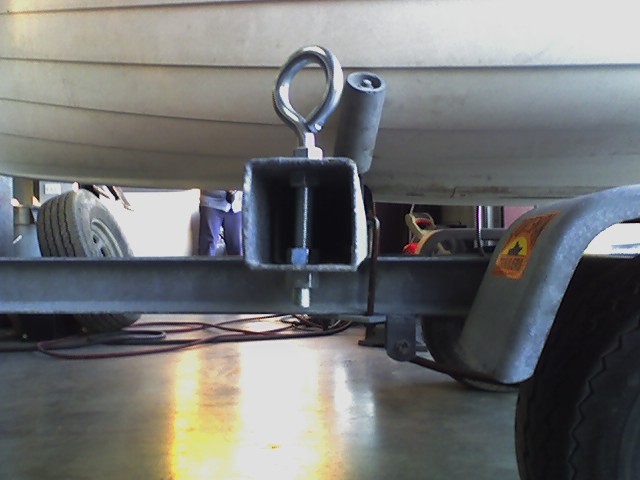

Created a brace to hold the top/back of the pipe tower when in the down position.  I made it out of 3 sections of 1" pipe, 2 90 degree fittings and 2 "floor" flanges.
Welded up a crude hinge for the pipe tower.  Once I am convinced that it will work properly I'll reinforce it.
Then welded some attachments for the guy wires, near the top of the tower.
I also mounted some eye bolts for the bottom of the guy wires.  I used 3 extra nuts on each eye bolt so that tightening it up would not crush the box section.
Soon I will attach the guy wires and lift the tower.

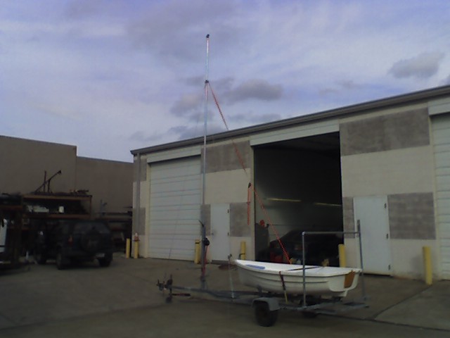

Put the tower up for the first time today.
You can not see it very well, but 2 of the guy wires are in place and 1 ratchet strap is temporarily taking the place of the 3rd guy wire.  I used straps to measure the length I needed before cutting the galvanized cable.
All the guy wires are now complete as well as the wench mechanism for raising and lowering the tower.  Now I need to get started on the battery/electronics box.
« Last Edit: November 26, 2008, 04:02:50 PM by esc »

Put the windmill in the air yesterday and it would not even turn to face the wind!
Today I put a level on the trailer and through adjustment of the anchor straps and front wheel, I managed to get it much straighter.  The windmill will now turn to face the wind, but the blades have yet to budge.
I suspect that part of the problem may be the new bearings needing to be broken in.  The wind is also very light, calm gusting to 5-8 mph.  But 10 to 20 was predicted for today and tomorrow, so hopefully it will start to turn soon.
« Last Edit: December 01, 2008, 11:09:04 AM by esc »

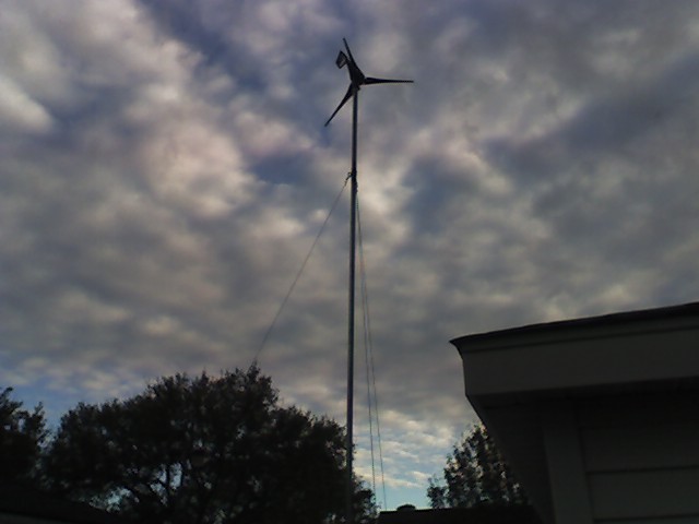

Here are a couple of pictures...
« Last Edit: December 02, 2008, 07:41:41 PM by esc »
esc
  • Posts: 163
Re: Trailer mounted powerr station (long)
« Reply #21 on: December 16, 2008, 05:40:07 AM »
Just a quick note in case anyone is following this.  Although beside my garage is about as bad a wind site as you can image for a 22' tower (surrounded on 3 sides by 40' trees), last Saturday, the wind was blowing from the one direction where it has a clear view.
It was easily spinning up and open voltage was easily pegging the 16v meter on my battery tester.  Applying the 100 amp test load would stop the thing is a couple of seconds.
So it seems to be working very well.  In another coupe of weeks I should have the chance to take it to the beach and us it in it's intended environment.
