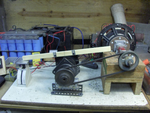

I've added a balanced 12" beam. 24" centered and same size drive pully and pma pully.
Also added postal scales. I reversed the drive motor direction so the balanced beam pushes down on the postal scales. I did this test at 5 amps only from both PMAs.
Here are the new test #s.
                       Hughs 4 ft PMA
  5 amps from pma
  RPM  426
  Drive motor volts 60.4v
  Drive motor amps  2.4a
  Drive motor watts 144.96
  Weight on Postal scales 1 LB 13.5 oz.
                      Garbogen PMA
  5 amps from pma
  RPM  491
  Drive motor volts 66v
  Drive motor amps 2
  Drive motor watts  132
  Weight on Postal scales 1 LB 9 oz.
Flux I hope this helps with your calculations?

Thanks Jerry that is fine.
5A out into a nominal 12v battery lets say at 13v gives 65 Watts out.
Hugh alternator in is 111 Watts in. Efficiency 58%
Garbogen  input is  109 W   Efficiency  60%
Those figures look quite realistic. The drive motor current lines up with the torque as it should do so I think this is perfectly believable.

« Reply #4 on: November 19, 2008, 08:33:12 PM »
Hi G.
I'm not sure what your saying here. I went to the postal scale for better accuracy.
Unfortunetly it was close to being pegged on the Hugh test.
The fish scale was to hard to pin point a # exactly.
I'd have to find a scale that reads to maybe 10 to 20 LBs full scale with some accuracy.
I thought this test was a good enough indicator?
I don't think the diferances will change no matter what scale I use.
Its just that some will harder to read then others?
« Last Edit: November 19, 2008, 08:33:12 PM by Jerry »

Jerry, if there is a way you can double the length of the arm then the force would halve allowing a greater range of tests.
