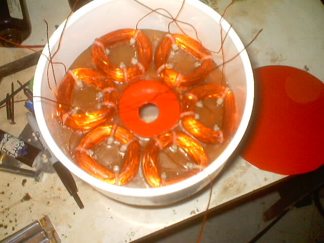

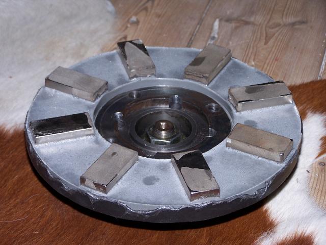

Finally, i'm starting to get my first gen together; though, only in the teststages. ;)

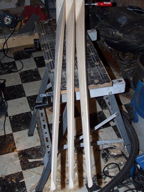

First, i made the blades this summer; measuring 7' in diameter, made of 2"x6" pinewood.
I haven't tested the real tsr of the blades yet, but they seems to reach around 120rpm in 3-4m/s. (yes, metric. Get used to it... :D )
As for the generator; it has 8 magnets measuring 50x25x20mm on one disk, and a spinning returndisk with no magnets. The rotor are 25cm in diameter, and 10mm thick. Here, cast with epoxy with waterproof-filling from West-Systems.
(These are the long 10,8cm magnets i've spoken of before; cut in half.)

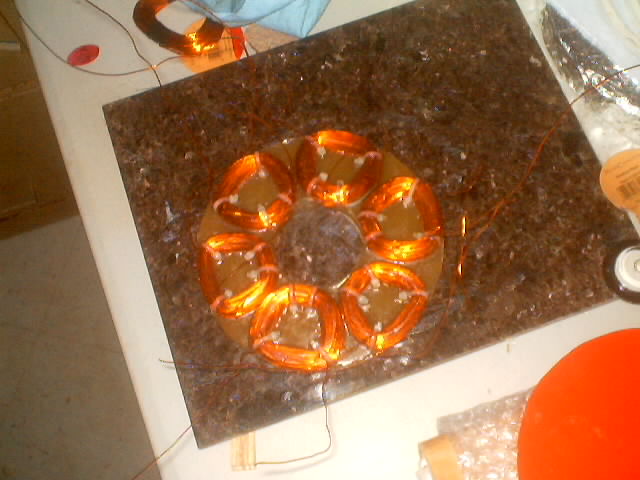

The 6 coils have 100 turns of 1mm wire. Here, temporarly mounted for testing.
Initial hand-spin tests suggests 13v@240rpm without the returndisk, and 13v@185rpm with the disk.
Now, i have lots of worries here... ;)
First, even with only 8 magnets on one disk and an empty disk as flux-return, i think that the 1mm wire (#18?) are a bit on the thin side...
Second, i blotched the casting of the stator by using butter(?!) in the form; forcing me to break loose the stator. It cracked a couple of places, but i've repaired it by making a groove in the cracks, and pouring in more epoxy. Though i suspect that it's not as strong now as it could be... :-( (next time: wax. ;) )
And third:
Would the rotor blades i've made match the generator?

Forgot to mention the rectifier... ;)
It's 6 single diodes, 1N1186, rated 35A, 200V, mounted on two too small cooling fins... :D

Hi, Why did you decide on eight magnets and six coils? Great looking Blades. I looking forward more updates. Best Regards

Simply because of my low budget and limited access to magnets here in Norway. ;)
I got hold of 32 108x25x20mm n40 magnets for free (lucky me!), but these was too large for my first project; mostly since i live in a residential area, so i cut 4 of them in half.
Another reason i'm only using 8 magnets would be my wish to use 24 of those magnets in full length to make a more powerful generator in the future. That leaves me with the last 4 which i can cut in half, making a secondary rotor and a stator with thicker wires for this first project if i find that the gen are underpowered for the blades, or i just want a bit more power...
Adds up, doesn't it? :)
Next step for this first project would be to make and assemble the rest of the windgen. This may take some time, since i'm no good with metalworks... :(

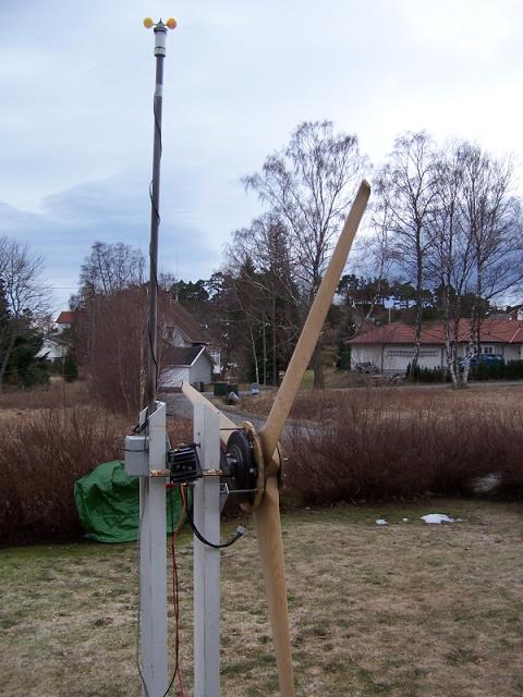

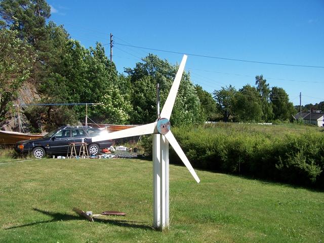

Just mounted the blades on the alternator...
There are of course not enough wind now to reach charging speed; i've seen 8-9V in a short gust of 4-5m/s...
I have still not done any metalwork... :(
