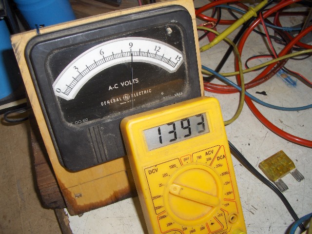

I had connected a small pair of wires directly to one of the 11 coils on the 14-11 ceramic alt for frequency measurements.
Just for fun I took a few ac voltage readings from the coil while the alt was runing at 13.93 volts dc output no load. The ac voltage from one coil is just a littel over 9vac while on the dc side of the fullwave bridge the voltage is 13.93vdc

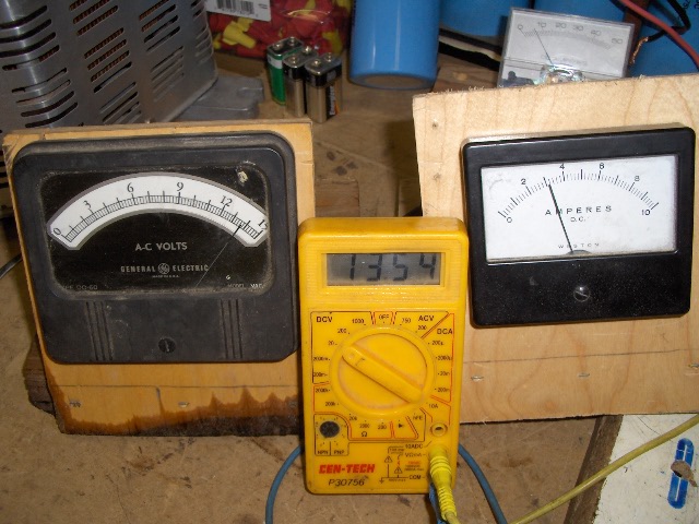

Then I loaded the alt down to 3 amps.
The AC side measured 13.5 volts while the DC side was measureing 13.54 volts.
I'm just thinking where have the diode voltage loses gone? I know they are there at higher amperage from the alt but why not at no load or low load.
Flux HELP!

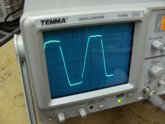

Here is the wave form under load.

It has to be a difference in how quickly the two meters respond to the difference in voltage.  The AC meter is probably slower to react (mass of needle?) and is missing the voltage "peak" while the DC meter (no mass) responds more quickly and locks in on the "Peak" voltage.

Probably on no load your coil waveform is roughly sinusoidal . Your ac meter looks to be a rectified moving coil meter so it will measure average volts but will be scaled to rms ( that is what the world normally considers ac volts). 9vrms will be 12.7v peak, which is near enough to your 13.93 ( average of the peaks of all the coils).
As you start to load it the ac volts will increase as the diode conduction angle increases. The coil resistance comes into play and the effect is seen on the scope, the flat top bit is battery volts plus diode drop. You can see the diode drop as the notch after the flat bit. The waveform is much nearer a square wave and for the square wave, peak mean and rms are the same. this would imply the ac meter reading the same as the dc. The things will not be exact as the ac meter is still reading mean but scaled rms  so it will have a strange factor. The waveform is not a true square wave either so in reality there is no real significance in the readings.
If your coils had much lower resistance the ac voltage would stay below battery voltage up to higher currents.
Diode loss is far from easy to sort out except in smooth dc circuits such as solar. The loss from diodes in alternators is difficult to determine as it affects the waveform and makes conventional measurements very doubtful.
What you are looking at is very similar to a dc power supply using a transformer and full wave rectifier with a very large smoothing capacitor, voltage waveforms with conventional meters tell you very little. The scope shows what is going on but does nothing to give you real answers as the maths for the set up is beyond most of us with complex waveforms.

Yes Flux you are correct. The wave form was much smooter and more rounded no load.
I tryed to get a piture but didn't have any luck. Timeing I'd guse. I just got lucky on the loaded picture.

There may be two issues with the stability of the scope trace when you try to measure frequency.
If the scope frequency measuring bit is a conventional frequency meter it will be affected by fast things that you probably won't see on the waveform. That vertical notch after the peak of the waveform is caused by the diodes and there will be very fast oscillations in this region if you trigger the scope on them and expand the timebase.
You should be able to use a simple filter with 100k in series and about 1uf across the scope input to remove the fast edges. For frequency the waveform doesn't matter and you should add enough filtering to get it to a near sine or triangle waveform.
Looking at waveforms of this type on a scope also has the issue that with imperfect magnet spacing the wave shape of each pole may be slightly different. If you trigger on a complete group of pole waves the waveform will be stable but the individual shapes may not be the same. If you trigger on any non integral number of waves then the trace may jitter as the slightly varying images will not fall on each other. If you try to get frequency from the graticule it will add confusion so alter the trigger and timebase speed to get a stable trace.
