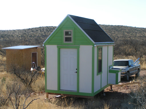

I got the solar electric system installed in our cottage (we call it the Pumphouse, since on our site plan it is identified as a pumphouse, but presently it has no water anywhere near it).
Here are some pictures:
This is the cottage, viewed from the south. I put the solar panel on the roof as you can see. Our latitude is about 31 degrees and the roof angle is 45 degrees, so I'm really optimizing for winter sun. I don't know if that's what is best but I guess I'll find out. The solar panel is a 54-watt Kyocera and it really charges the batteries well.

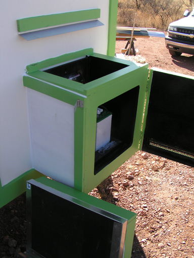

Here is the battery box, attached to the north side of the cottage. I'm really proud of this part. It is made from 99% recycled material or material found on hand (leftover scraps from other projects). My employer had bought new server equipment that came in a stain-grade plywood box. I took the box thinking I could make a router table out of it, but when I got bit by the solar bug there was only one thing for it: battery box!
I used scrap insulation, plywood, and cement board to convert it into a super-insulated, sealed box. It uses convection ventilation, with an air intake at the bottom of the door (screened to prevent insect or rodent entry) and a continuous ridge vent at the top. There is a lockable, hinged access door on the front and the "roof" is removable to make it easier to see how well the electrolyte is covering the plates. All surfaces inside are coated with roll-on bedliner stuff; the guy who sold me the batteries recommended it as it prevents any spilled electrolyte from eating through the box.
The batteries are 225Ah golf-cart batteries bought refurbished at $45 each. There is a 120-Amp fuse on the positive inverter cable. I think I spent $30 or less on the battery box, which was for the can of roll-on bed liner, the hasp, and the hinges for the door.
I plan to devise a way to prevent any hydrogen gas from drifting into the cottage through the opening for the cables. Probably some plastic conduit with an LB on the inside of the cottage, angled downward. I might run that conduit into a service panel with disconnects for all the lines going in or out of the battery box.

Nice looking setup. I like the mounting of the batteries out side the building and you could get a car volt meter to connect to them and mount in the building to keep an eye on the voltage.

I'd be more concerned about sulfuric acid droplets than hydrogen.
In either case:  Consider using permanent marine caulk.  It's a self-vulcanizing rubber you can get by the tube at any chandlery.  Hardens up into something the consistency of a hard rubber stopper, bonding to the wires and wood nicely.  (You can also use a temporary caulk ditto if you might want to run more wires through later.)

Make sure that every wire that connects to the battery, has a fuse on it.

Nice get away! I like that metal roof you can paint it white in the summer and black in the winter.  Might want to get one of those cheap digital multi-meters at Harbor freight store for a few bucks to monitor voltage (and amps) and have it screwed next to your charge controller.  Mine have always been quite accurate on the tenth scale showing accurate 12.7 , 12.5 or whatever.
