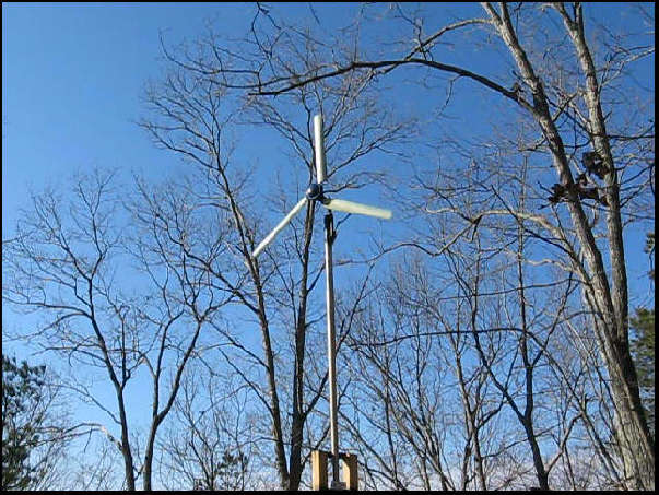

I started this test tower and a 4x4 termp on to the deck the real tower will be cinder blocks with steel and concreat in the cellsbut I can do some testing till I get it up.

First up is a cieling fan conversion an old one Ao Smith ( China ) .I 'm working on another one so I'll post the guts later here's a video with some blades I made for a Delco
http://www.youtube.com/watch?v=EeQ64kpowso

Jan an feb and mar are Slow work wise so I've been setting up some starts for the summer .I ve had that conversion up at different places and it was a little bit of a hard start . Maybe one more time with some small mags drilled into the epoxy . I'll put up a stock delco with some mods and I 'll be able to post charge data soon . Also give a breakdown on the alternator frame with the front forks .Most kids bikes have the same races and roughly the same size.
