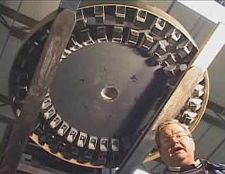

So I'm wondering about this device.
How efficienct is it?
What about the mag-lev aspect?  How well will this work?  Would it be worth the extra cost for the large levitating magnets?  How much friction would be eliminated?
Check out this new 'MVAWT': 'Magnetically-Levitated Axial Flux Alternator with Programmable Variable Coil Resistance, Vertical Axis Wind Turbine'
Large construction with many/large magnets and coils.  And uses magnetic levitation rather than bearings.
Some proposed benefits"
  • roof mounted (no tower needed easing installation and neighbor problems)
  • 5mph cut-in speed
  • almost silent
  • variable resistance coils
  • increased efficiency due to no bearing friction
So looks like a huge axal flux VAWT.  Some questions:
  1. the magnetic bearings: how well would they actually work?  while you eliminate the downward force friction, how does it stay cenetered to prevent friction from rubbing against the center pole?
  2. the claims of 200% increased output due to 'roof effect' ??
  3. the ouput claims seem overly optimistic?
Interesting!

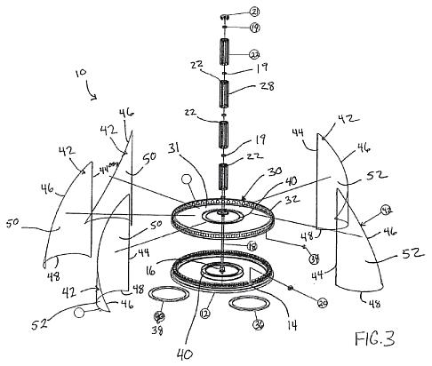

So not ALL bearings are eliminated - just the load bearing ones.
There are still bearings on the vertical shaft to maintain alignment.
http://www.google.com/patents?id=luCfAAAAEBAJ&dq=7303369

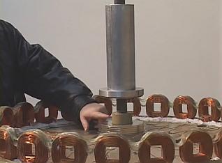

Those stand up coils look like a mess and self sevice is pretty much out of the Question unless you have a crane.

hehe I liked the part in the video, where the horribly wobbling magnet disk was shown :D

Tecker -
I agree the standup coils look like a poor design decision.  Seems like they aren't well secured and would flop around.

I find it interesting how Jay says how smooth and easy it turns, then the guy points out that is for a demonstration and unit shown does Not use mag lev.
Jay has not seen one, and Ed 'Begley' Jr will not be using one.
They have a bit more disposable income than most of us, so purchasing a POS won't bother them as much as most.
I don't see where it says Ed Begley Jr is not being compensated for his endorsement.
I do see where "about us" is 'coming soon', the distributors are 'coming soon', and the cost of the one shown is $7000.
I find it VERY interesting the company will go through all the cost and work for mag lev, but use a fairly poor "sail" design.  The VAWT guys would not use that on a $7000 machine.
Interesting, the exposed magnets have no coils?  Or have no flux return path?
All the cost in magnets to reduce bearing costs because of the high weight.
If I understand the concept, the bearings in it still has take the brunt of the wind force.

And also the variable-resistance aspect.
A computer/logic circuit controlled coil array.
I think it's a great idea.
Rather than a fixed cut-in, you can produce at least SOME power in even very low-wind speeds, and then 'kick-in' additional coils as the wind speed increases for greater output.
Kind of like a star/delta switch, but more refined.
This is the first time I've seen this idea presented although it seems a basic idea.

capthook
  • Posts: 36
Re: MVAWT: new mag-lev VAWT wind turbine
« Reply #16 on: February 08, 2009, 09:24:41 PM »
Dang wdyasq - alot of anger there :-/
Again - I'm not promoting the design or even saying it's a good one.
But it IS huge - what, 40 large magnets on an at least 40" diameter rotor?
3x bigger than most builds here so it's bound to put out some power!
No comments on the mag-lev or variable-resistance aspects?
Again - those are the two things I find of interest in this device.
And while a HAWT will outperform, most folks don't have the land/location to be able to raise the huge tower needed for maximum performacne.  So a functional VAWT has a place in the market.  Yes?!?  Yes....
the other 90% of people that don't have the land/location to raise a HAWT.
A smaller/low-wind speed VAWT would be more practical IMO... then put up 4 of them if you like!
« Last Edit: February 08, 2009, 09:24:41 PM by capthook »

Air bearings are much better technology for floating a VAWT than magnets.
It is cheaper, lower tech, inherently self leveling / orienting.  Industry actually uses air bearings as opposed to mag bearings which are really uncommon.  Typically the air compressor is ganged directly to the working shaft of the device so that at speed the air bearing takes over for a bushing or a traditional bearing.
The radial orientation of the coils in the picture is bizarre.  If you wanted to get "free" mag bearing you would want the coils to be axially oriented.  The rotors would then want to center around the stator, which would be a vertical lifting.  A radial configuration produces the rather less useful axial centering of coils and rotors.
