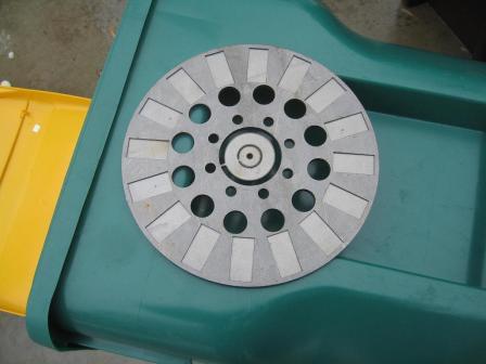

Well we finally have a fair wind day and we are able to collect a little datafrom our 10 foot turbine built from Dans plans. the wind speed seems to be around 15-20mph we are getting a few gusts of closer to 30
the Classic controller was showing 42 amps at one point and battery voltage was at 56.4 so we where able to get 2370 watts out of the turbine around 28mph windspeed with a input amperage from the turbine around 15 amps.
We will continue to collect data and work on the classic and we will keep adding to this diary entry. i am hoping for 3000 watts but i need more wind. i was hoping for 30-40mph but i dont think we will get it today

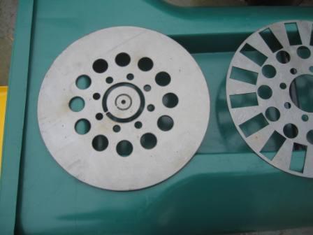

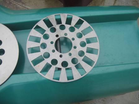

Keep and eye on the new design of rotors on my 12 footer sim to Dan's but bigger alt with aprox same size rotors 12.5inch 16 mags per rotor n45 will have update as I assemble it cheers ibeweagle under new rotors
« Last Edit: February 10, 2009, 05:56:03 PM by ibeweagle »

You make jealous wish had that classic here have made many improvements to Dans design now keep and eye on my post in wind about new rotors will update as I assemble it. Are you going to use a clipper like Red Rock has for a diversion load if turbine gets above 150 volts DC or can the fets in the classic go higher than 150 volts and also understand need for load in case something takes off the load to the turbine cheers ibeweagle

i do think i may play with a bigger pair of rotors and stator on my 10footer when i get the time? and will be open to suggestions.

we do have the data logging equipment in place and should be live on the internet in a few weeks. i will say this i have the 1 by 2 magnets and i understand that makes my machine around 800 watts. we routinely see 1800 watts in the area of 30mph winds and we haven't really even started to work on the curve for this turbine. The learning mode will really help with that.
I would say at first glance we could go 2.5 times the rating on these turbines and still be very comffy and definitely could go 3 times the rpms do get up there a little at 3 times but it still seems very quite and rather pleasant sounding. I should have the clipper in place in a week and then i can get some rpms as well as mph and what not.
