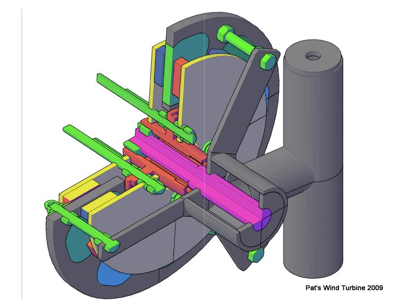

I have 20 years as a CAD designer.  Instinctivly, I started modeling my turbine in AutoCad.
I have a nice shop to work in, but lack in tools, and have no metalworking skills at all.  I have lots of mechanical knowhow and have basic tools for Automotive and Motorcycle maintenance.  What I dont have is a lot of metal or wood fabrication tools.
My first hurdle, which I have yet to cross, is the Metalwork.  I have a neighbor that builds machines for a living, so I showed him my plans.  I gave him a set of cad drawings and he is working on it.

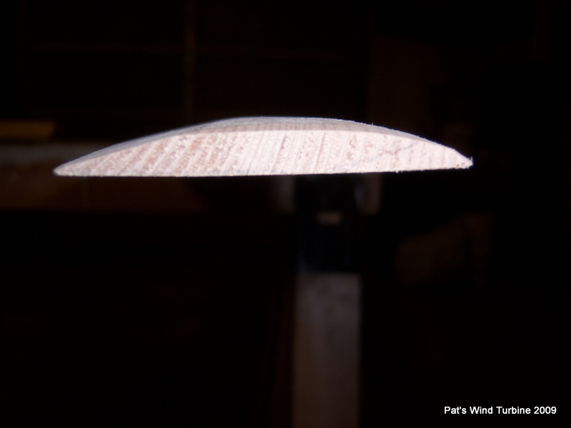

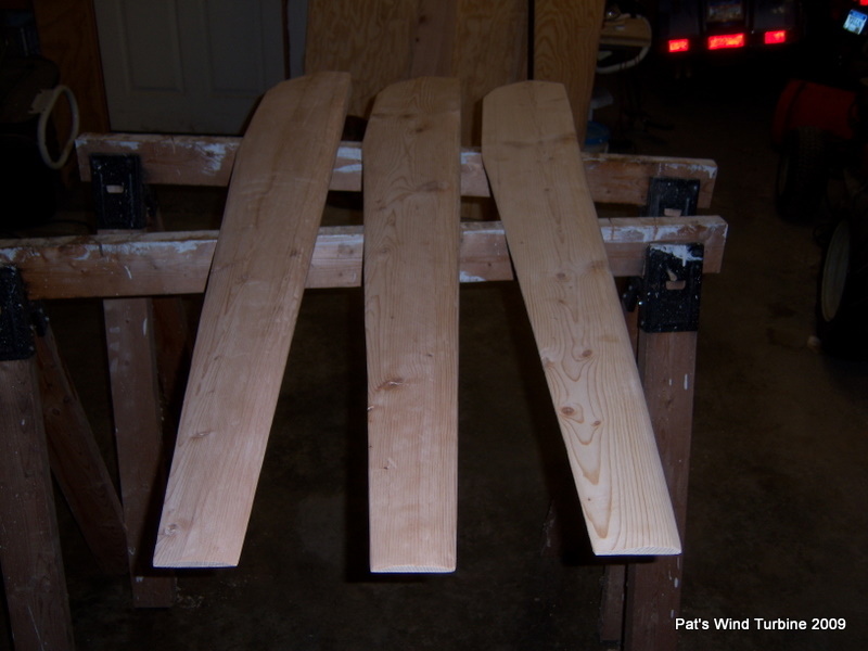

After wiring and gluing together, I started to think about blades. Again, I thought about buying blades.  Chinese blades are tempting. After a ton of research here, I decided to give it a try.  The only thing Chinese about my blades is that I bought a $30 hand power planer from Harbor Freight.  I couldn't believe how easy it was to make the initial profile.  I finished with kerf cuts and chisel/hammer.  10 minutes with the belt sander and it's a blade.
I have prooven that I have the ability to make blades out of pine.  I think I will take a look at making a set out of better wood.  A friend offered me 1" thick x 10" maple boards he cut from a tree in his back yard.  Can I glue a couple of these together and make a blade?  Is Maple ok?

Knot free wood is easier to carve and will break not as fast.
Maple should be OK but you will have to give it a decent protective layer. Maple is also used for airplane propellers.
