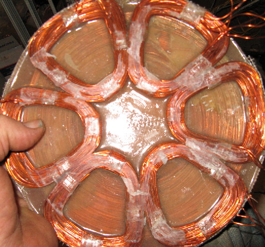

I've messed around with ferrite blacksaand fillings BBs ball bearings and magnetite . and the amount of flux is noticeable stronger with steel and better even still with  (painted steel layers) I got a very good thanster from to magnet with copper coated tig wire ( medium ) very strong magnetic transfer and can be wound in a flat coil and when potted is very strond and hard to cut sound like a steel plat when dropped .So that would work well . I have a picture of a single rotor stator on my mem card I'll post it .

 Here it is part of a dual stator single rotor (unfinished imagine that I 'll blame it on the cold )

Is that a CU lamination behind the coils?  If so, why?

That's copper coated welding wire (medium) .Magneticily it would be the same as painted wire two to there layers wound in a coil and pressed with polyurethane paint on om thin steel . Bedni uses copper coated welding rods for core . I think this would be a good DIY lam .
