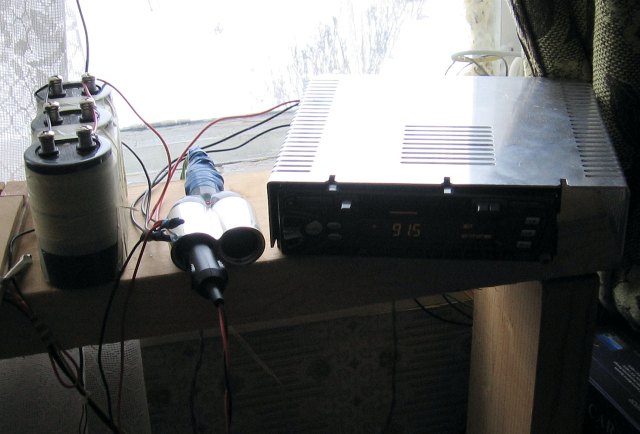

Hello,

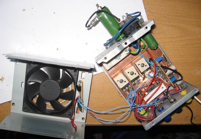

I made second windmill controller using old computer PSU parts:

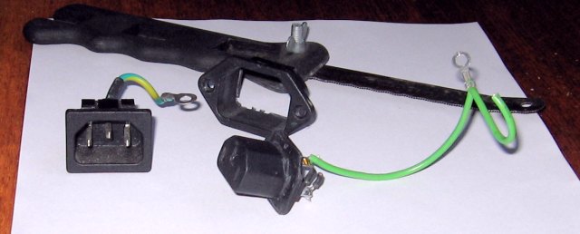

Computer PSU has nice power connector, You can use it after some modification:

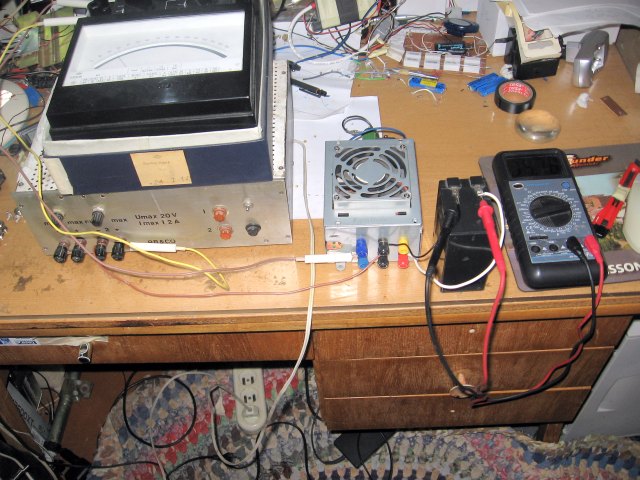

Picture of test and tuning, I have this big analog ammeter(running to 30A), adjustable PSU and multimeter to measure voltage. I found multimeters can show wrong amperage at currents more than 3A because thin cables used.
4X40W car stereo sounds good in my room. However big condensators needed to compensate long 12V wire run from garage.

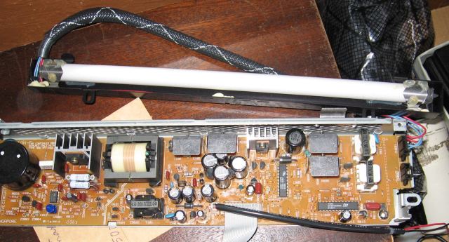

Latest best found is this lamp grabbed from old scanner, working on 12V. It makes more light than ordinary 12V 8W working light.

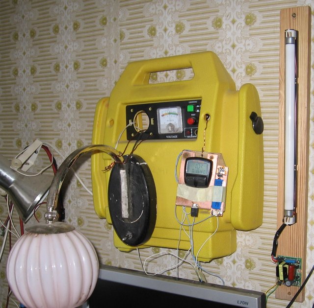

You can see from this picture also my windspeed meter, reading lamp and battery status monitor.
From another scanner I found this, inverter working from 28V and I can't find out how to turn CFL light on. So all scanners are not gold mines.

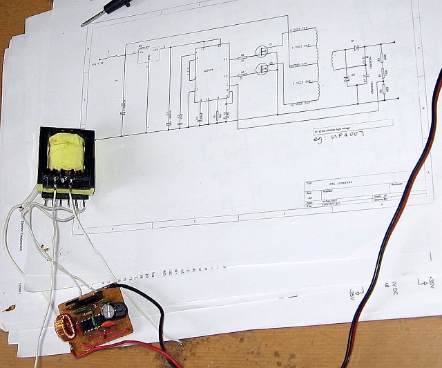

Wondering can I use old PSU supply transformer in CFL 12V inverter?
Probably not, I have to rewind this thing.
Who has made this sucessfully, can write about this.

Commanda has made a few flouro inverters from old psu tranformers and posted about it here:  http://www.fieldlines.com/story/2007/12/13/05649/929

hey i see you are using the old auto jumpbox. have you looked at the charging part yet? I was trying to figure out how to use it to charge my battery bank sence has a automatic shutoff when the batteries reach 14.6 volts. I can not figure out how to wirer it to go to a dump instead of just shuting off.
Can you heop me with this? I'm weak at wireing.
« Last Edit: March 01, 2009, 02:00:10 PM by divemaster1963 »

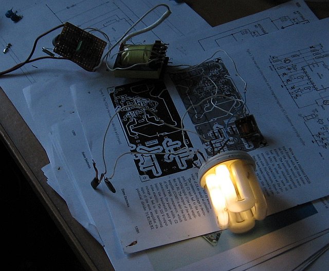

I made this. Old computer PSU transformer CFL inverter working now.
Magic thing was used choke from broken 220V CFL inverter. You have to put this in series of CFL lamp and use small capacitor like in original 220V CFL inverter.

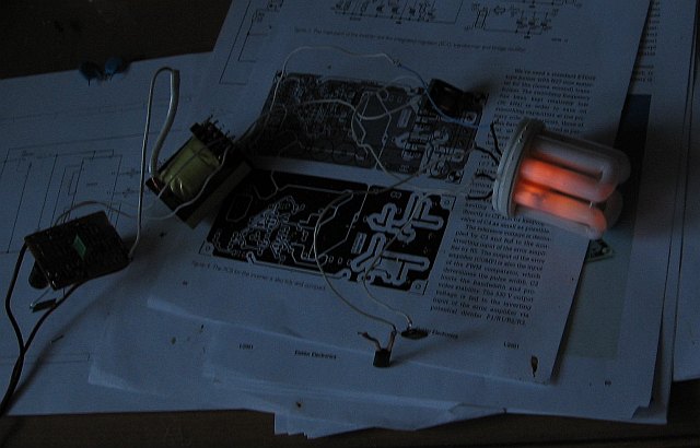

This PSU transformer has primary windings for 3,3V 5V and 12V. Best to use 12V windings but then CFL has starting problems:
May be good idea is add a starting switch using 5V winding, after a few seconds when CFL bulb is hot and then switch to 12V winding.
Always use ampermeter to measure current first, I've seen 7A and this tiny bulb shines so bright it can explode after some minutes.

I've not using this charging part of this auto jumpbox.
However it is connected and this red led starts to shine when battery voltage hitting 14V. I guess it's working too but limited somewhere 2A charging current. Tiny diodes inside.

Shining good 12V 0.6A like original at 220V when bought.
Original circuit worked for few years and stopped. Probably electronics fault as always. It is second life for this bulb.

We need to see the circuit. I know you've seen my 24 volt circuit using a pc psu transformer because it was in a photo you posted several days ago. Someone was emailing me, trying to get it working on 12 volts, but I don't think they ever succeeded, and I haven't had time to pursue the matter.
