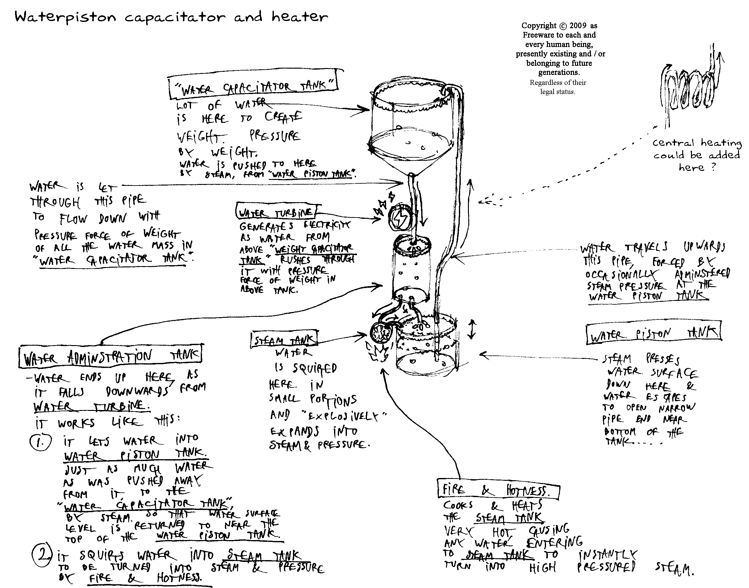

No moving parts, no moving parts friction. ok... generator has moving parts (who says that generator has to rotate on bearings though.... windbelt wobble comes to mind.... ).
Can use for heating simultaneously: Biogas. Pyrolysis gasses. Biomass (booo... biomass needs charcoaling and pyrolysis gasses for burning then... but it can be done).
Heat from burning chamber should be simultanously usable for burning ceramics and/or bricks, not to mention drying of plants and mushrooms for storing and transport.
Also: If adding passive solar heating to uppermost tank, that heat can be used as water heats that much easier then in the steam chamber... and no reason why not to add wind S-turbine to pump water from "adminstration tank" to top tank... for extra electricity.
Someone might consider adding heat reserver to heat up incoming air and cool the outgoing CO2 for extra boost... and then in such system Solar Parabolic heated salt could be used to heat the pipes through which the air enters the "fire and hotness" chamber, so that it is few hundred celsius before it even enters the flame... or does not even need the flame if much sunlight is available.
Friction of water in the pipes might be a problem ? but at least maintaining and repairing industrial pistons and bearings and such is not ?
Here is it's basic nucleus:
( In case there is problems with viewing this sketchy image here, it can also be found in this link:
http://koti.mbnet.fi/maxt/oddsnends/Pump002.gif )

In a nutshell: It uses Steam pressure (directly without pumps) to push water from a tank to a high up water tank. When electricity is wanted to happen... water is let down from the high tank, through a generator. Idea is to have efficiency and minimum amount of industrial and irreplacable parts.
As steam is in direct contact with "pumped" water, water also is heated up, and that is used in central heating of the household.
About this looking complex... Darn. Everyone who has commented on it in any context, has said the same. And I thought this was the vastly simplified version showing only the nucleus of this system. Seems like I will just have to do it illustrated clearer. To the Drawing Mobile ! (= laptop with popular image processing program).

The first steam engine pumped water from mines - they simply filled a weirdly stomach shaped tank with live steam then shut off the feed and allowed it to cool which drew a vacuum to pull water up to drain away once the pressures equalized. How is that for simplified?

Maybe it would be easier to convey your overall idea with a flow chart / block diagram type drawing.
Break it down into processes like:
Heat source>>thermosiphon to raised reservoir>>drain through alternator>>use electricity.
Thats as far as I got with the text you submitted after the post. The drawing is too crude for the complexity of the ideas you attempted to incorporate.
Solve the pieces individually when you decide on a n overall process.
Overall the idea may be OK but I would venture a guess that efficiency would be horrible compared to other, more common methods?
I would suggest you build a small prototype and run some tests. A simple PM DC hobby motor could be the electrical producer and they are common. Sometimes an hour in the lab can save a decade in the library.
Figure out how much water you can raise how far with X heat source then do some math from known data to see what is available from a given source. Most coffee makers "pump" water up with heat so that technology is understood and works. Simply a check valve and a tube thats heated.
Pumping water into reservoirs is another known technology and is commonly used on a large scale to store excess power from hydro dams.
Most of the pieces "work" so the only thing to do is figure out how to do it on the scale you need.

i think you need to ask your self what do i have and what do i want
if you have a fuel source and want electricity then build a steam generator
something like danb made.
if you want to pump water then fine
but don't use steam to pump water to make electricity with gravity
just the volume of water you would need would require a large pond not a metal tank

Water in a raised tank for an energy storage is very low density by volume and weight.  I suggest you do the calculation of energy contained in one ton of water raised ten feet.  I get 8watt hrs per ton per ten feet.  It is easier to move to a place with a hydro resource than make this scheme work.
If you want "lasts forever" energy storage get a nickel-iron battery.  The battery will last longer than you will and the main electrolyte, KOH or caustic potash, can be made from wood ashes.  Potash lye has been made since antiquity with essentially no tools.
For driving a gen head, a telsa turbine fueled by wood gas is pretty good.  The turbine has one moving part and the air compressor may have a couple more.  Both the turbine and the compressor have parts that only rotate - no moving pressure seals.  The rotating parts can be floated on air bearings with air from the compressor and have no rubbing parts whatsoever.  There are no off the shelf tesla turbines right now but there aren't any steam driven water raising gadgets either.  Some stirling engines are similarly robust and can be purchased off the shelf (though hard to find).  The technology for using wood gas in a fuel cell is coming along and that has no moving parts.  It isn't really ready yet though.
For heating water, solar thermal wins by a long shot in terms of simplicity.  The exhaust from the turbine would work too.  I'd be careful about tapping the heat from the wood gas generator.  Generally you want that thing insulated and hot, hot, hot.
Steam is a demon that wants to escape your device and kill you.  Seriously... it is dangerous, great at making hot water and lousy at doing mechanical work.  Steam works on seals and ferrous metals to degrade and corrode them.  If you don't care about efficiency a hydrodyne or other air (stirling) type engine is the better bet.
Lastly you should do the calculation of how much wood or other fuel is needed to power your scheme.  You will quickly see the need for fuel efficiency.  Even a very green/conservative western lifestyle powered by steam will require an enormous woodlot.  An acre of hardwood grows by about a ton each year and a ton of wood has about 12 million btus or 3500 kwhr of heat energy.  That seems high until you multiply by fuel to plug efficiency rates of 2-3%.

When you're raising water with steam you have a heat engine with the water for a piston.  Because it's WATER, it limits the temperature of the steam you can use it with.  That limits the hot-side temperature of the steam engine, causing your carnot cycle efficiency to be pretty rotten.  (To be efficient you need to superheat the steam, which is not compatible with it being in contact with liquid water, even at several atmospheres of pressure.)
So your system will pump the water up.  But it won't do it particularly efficiently.  OK for pumping water when you don't care about how much fuel it takes (especially if you have the heat available for other reasons), lousy for storing energy for later use.
