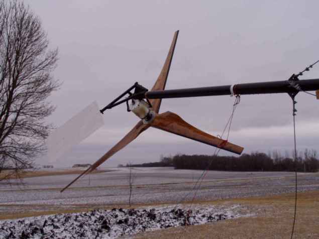

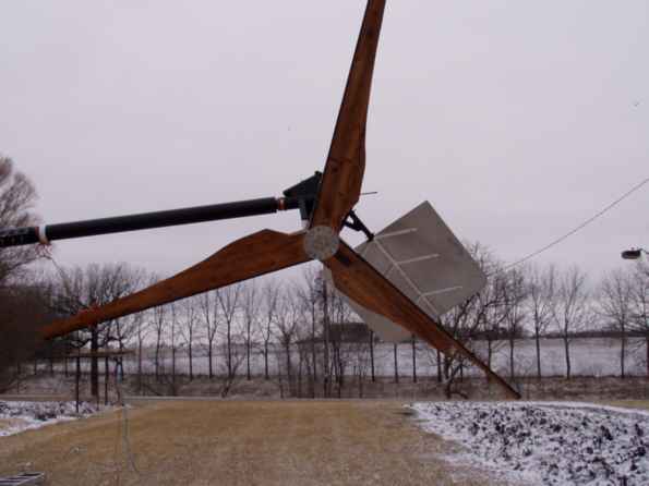

 Thanks for all the comments and suggestions. It wouldn't be hard to increase the offset. I could put spacers under the motor, but how much more offset should I try? Could it be the way I am carving the blades? As far as anything sticking, the generator assembly rotates on a bearing and the furling arm  is greased, so nothing sticks. There is very little friction on either spot. The tower is 70 feet high and the wind was blowing from an open field. No trees or anything that should have cause any turbulance.
 I still don't know if I damaged the motor, but from the picture posted, it doesn't look good. When I got it down, it was still rotating and when I shorted it out, it sparked on the contacts so there might be a some life left in the magnets. The motor was so hot you couldn't touch it. Resistance still checks the same on each phase.
 If you never had to take down your wind mill in strong winds, concider yourself lucky. I never thought a 5" sch40 pipe could wiggle the way this one did. Imagine trying to stand up a wet noodle. With the tip of the blade gone and turning at I would guess, 700+ rpm's, that pipe was shaking from top to bottom. Had to use a tractor to pull it over, as the wind kept trying to stand it back up. I knew if I didn't get it down, it was going to come down. I had all the cable clamps double nuted and I noticed that there were nuts laying on the ground after I got it down.
 I seen the pieces of blade starting to shed off, so I knew I was in trouble. I didn't have to go to the gym to get my heart rate up! But, one way or another, it will fly again.
Broken blade, motor overheated and varnish leaking out.
Front view.

From your description you are certainly furling at far too high a speed for the alternator capability. Once you get over the peak of the prop power curve you are virtually trying to furl an unloaded machine and that never seems to work.
If you can get it furling enough to drop the prop power before you run out of alternator loading you may have a better chance. Your offset seemed reasonable so I think the better thing to try would be reducing tail weight or reducing the hinge inclination angle ( or both). It would also help if you can hold the tail restoring force later so it doesn't drop so much at full furl. If you have it set at 45 deg in the horizontal plane it may help to bring it to 60deg. This will encourage it to come into furling early and will hold the restoring force higher when it finally does furl.
I am not sure what effect the large chord width of the blades does near the root, you probably need that for starting but I have never had much luck with blades like that and they may seek the wind more.
Sadly I suspect your motor is at the end of life but it may run a bit longer if the magnets are ok.It would almost certainly have been happier and easier to control with smaller blades.
