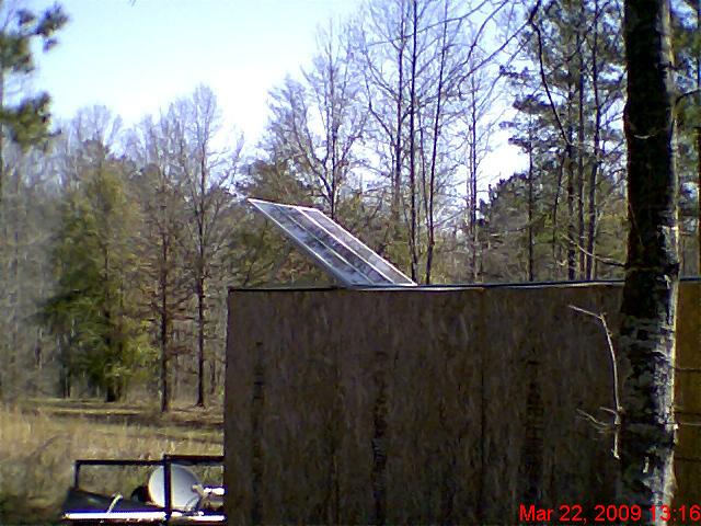

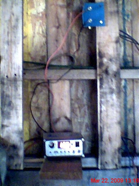

well for my first mill I'm going with 21 gauge 315 turns 9 coils for the stator and making laminated cores for the centers. the rotors will be 96 magnets, cercamic

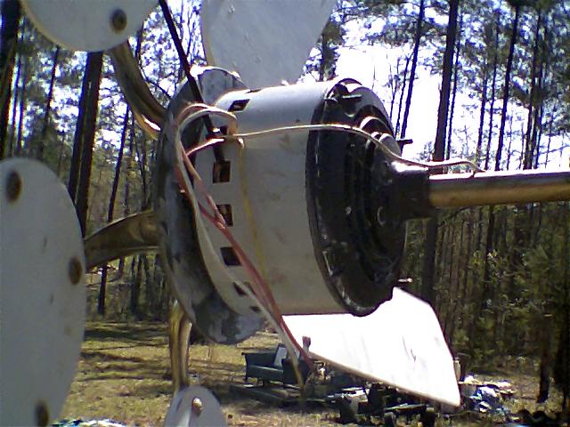

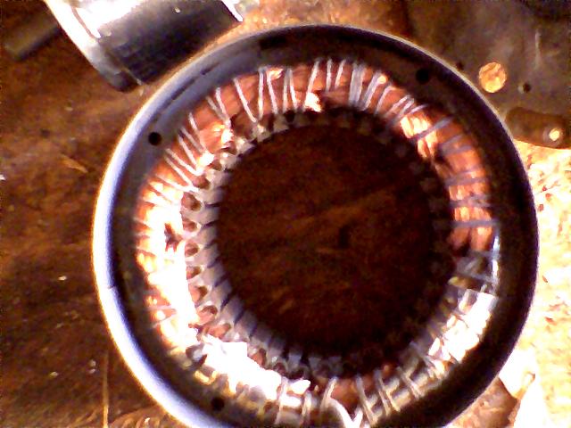

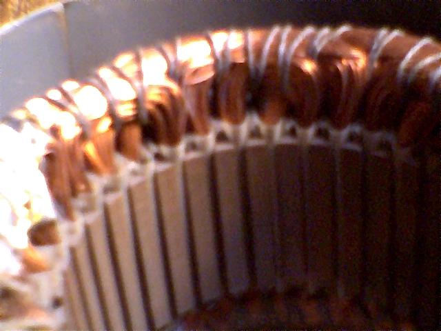

1x2x1/2 stacked in groups of 4 2 NN,SS,NN,SS . I had a friend do a femm sim. this will get the best output with the magnets i have. I'm also have a small solar setup from hf. its charging up over several days my 2 banks. I, also playing with a old regant fan that I converted to a pm using 6 of my ford stater magnets. I'm only geting open volts from the 1 red lead. I guess I'v got to rewind it to get the most out of it. It has 36 slots. good starter to learn on.
here is the photos.

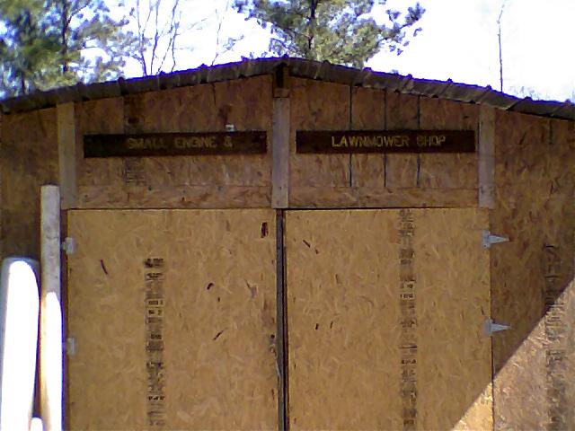

thought you may get a kick out this:
my shop is made from pallets. walls are 2 rows of 4x4 pallets stacked up. the floor is 3'x16' pallets with 2 layers of 27/32 flooring. got hte idea from a geltman that has had one for more than 20 years. and termites have not touched it.

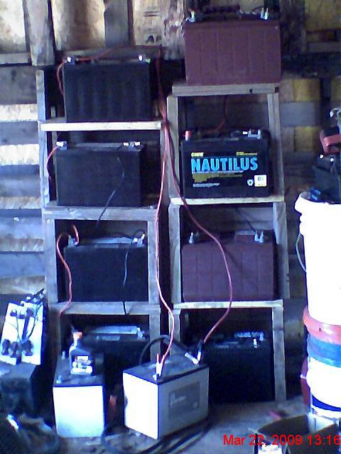

Those are some honk'n batteries you got there. Are they all hooked together to be charged off the what looks like a HF solar set?
I like the reuse of the pallets. Those are usually made of good hard wood to hold up to the load. One I get are mousy little white oak, but once dried they sure make for a nice fire during winter :))
I'm pretty picky about the ones I use, don't want to burn any that's been "treated", nasty stuff after they are.
Have Fun With IT!!

the batteries are two differant banks. one was 6 agm communication sealed batteries. 340 ah at 12.6 volts each. the second set are 5 deep cycle 12volt batteries. I got them from a gem car that I rebuilt for the dodge dealer in town.
« Last Edit: March 27, 2009, 06:40:00 PM by divemaster1963 »

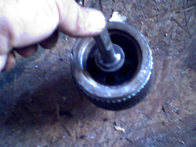

first: I have a business friend that owns a starter alternator shop. I can have all the dead starters I can get usally 10-15 per week. have looked at the gm starters also. thought about the where. havent gotten that far into the learning curve yet. but will get there.
second. have another freind who has lathe and mill at work . they build trucks and asualt weapons for the police. boy do week have fun with those at the range.have another motor from a friend who gust replaced ac unit in his house. got both fans.
here is one photo of the compressor fan. I got to upload it first. my bad as my grandkids would say.

« Reply #7 on: March 27, 2009, 06:53:12 PM »
here is the photos i fogot.
