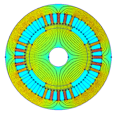

I finally got around to trying the Femm software on the 3/4 hp conversion, but I am not sure which types of steel to choose for the modeling.
Just taking a wild guess, I chose:
Carpenters silicon core iron for the outside laminates
US steel 2 s .018  for the rotor body
1010 steel for the shaft
This is the postprocessor output.
How far off am I on the choices?
Bonz

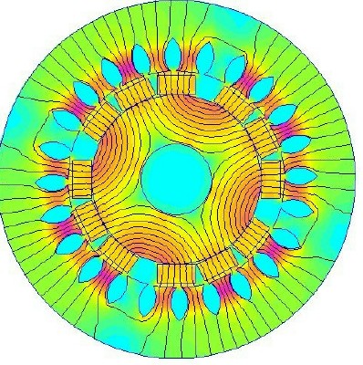

Somethin a bit odd there... Your field lines don't return through the laminates. Check out the cogging torque example that comes with FEMM (incidentally using M-19 steel):

I am not familiar with your American steels but your choice should be near enough. You can forget the shaft.
Something is very wrong with the flux path in the stator. The lines look as though they are aiming for a big steel ring round the stator core with much lower permeability than the core itself ( just about impossible).
The flux lines should return from pole to pole in the stator just as they do in the rotor.
Sorry I don't know the programme but you are obviously feeding in wrong information and it will not be in the choice of iron.

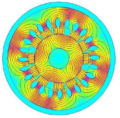

Got it.
I added an Al shell around the iron to create a boundary.
Looks like I needed to specify the outer boundary of the iron.
Putting the shell was an easy way out.
Now, on to model the 3 HP before build.
« Last Edit: April 01, 2009, 01:02:56 PM by FishbonzWV »

Yes:  It looks like your surrounding air/vacuum has an infinite permeability rather that mu-sub-zero.
