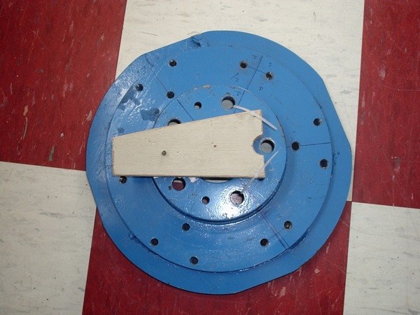

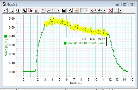

I've been working on this single rotor mill since last summer on and off throughout the school year. Finally it's getting toward time to put up the tower and get everything going (as soon as the snow melts). Basically, I've started trying to get some decent numbers this week on how much power I can produce and what RPM I should be expecting to achieve, etc.
To test the generator I shaped a piece of wood that would mount on the front of my rotor and stuck a couple of screws into it on either side of the center. I am using a T-handled allen wrench in a drill that rests on these screws and spinning it up with the drill. It's a bit crude, but it seems to hold up alright so far.
At first we've been using my small cheap cordless drill (with dying batteries) to test so my results have been lackluster. I've been using the school's physics lab test equipment though which has been nice and provides me with graphs and relatively accurate RPM measurement (with a bit of calculation).
So far the max I've gotten out of the generator has been 39.6 watts. I've got a 3.6 ohm load ( 6 18 ohm resistors in parallel) on it after the rectifier. I don't know what RPM I was turning at that time though (I hadn't hooked up all the equipment yet).
Then I got all the equipment set up and here is what I collected. DC volts: 5.94 DC Amps: 1.5 RPM: 77.5 with the 3.6 ohm load. For a grand total of 8.91 watts... hey my drill battery pretty much had it. Here is the pretty graph that I'm using to calculate the voltage, sadly it only measures up to 10 volts so I'm using a voltage divider to get 1/12 the voltage (eg. the real voltage is the voltage on the graph times 12).
Pretty neat graph, eh?

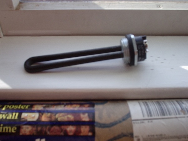

Here is the 12volt heating element I plan on using. I know it's not going to provide all my water heating needs but it's sort of a little experiment and it means I don't need any batteries.

congratulations on constructing a functional alternator first time out of the gate.
the graph is cool
what sort of coil layout and magnets did you use?
will you be able to make it a dual rotor at some future time?

The stator I am using is the 24 volt stator offered on forcefield. Nine coils, each with 66 turns and wired in star. Since I've got a single rotor I've got 12 volts out of it. I'm using 12 rectangular 1X2X.5 inch neodymium magnets.
I hope this summer to possibly start construction on a 10 footer. I don't have a good site where I live, so the problem is finding a place to put it up.
