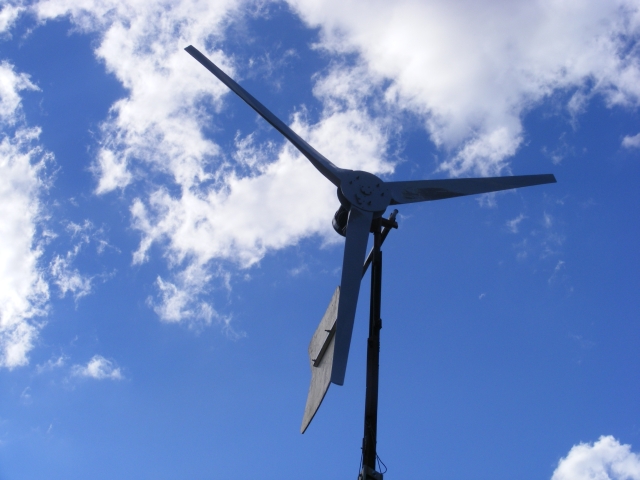

Hiya guys,

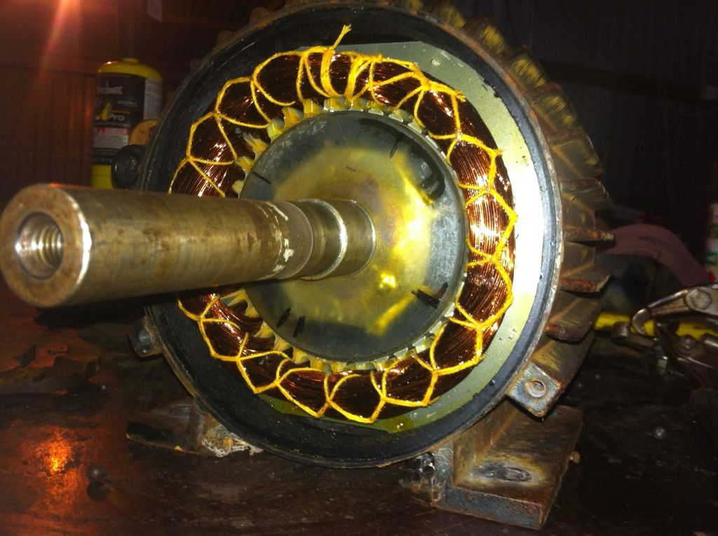

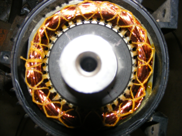

          Well finally I got the 2hp conversion finished and up and flying.Rather than go the skewed method I went with the offset method not only to save on the amount of magnets to use but increase the sq/inch of mags in the rotor. Using 8off 2x1x1/2 N45 epoxy(painted)neo's with the countersunk hole in the centre I ended up with 8sq/inchs of mags on the new rotor. Many thanks to Dinges who did the design work for the mag spacing and although I was pretty peeved off when I found it cogged slightly I've found my 3 metre bladeset overcomes the cogging no worries.
The rotor in place in the motor

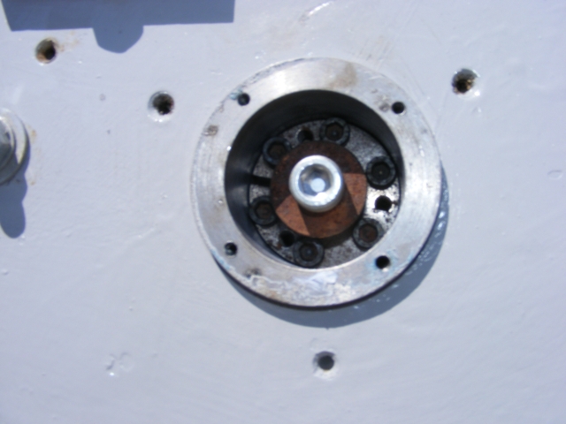

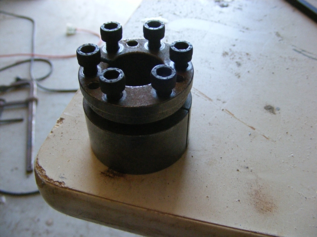

 The output shaft on the new rotor I machined to 24mm and used a dual taperlock to secure the bladeset to the shaft
The taperlock
The taperlock all tightened on the shaft, although this dual taperlock can hold over 25hp for added safety I used a washer and setscrew incase the blades decide to want to walk off the shaft

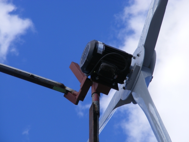

A Rear veiw of the genny
A front veiw of the genny
The blades do start with just a breath of wind and the best I saw was 10 VAC and I just just about count the turns the blades were doing. When I lathe tested the motor the best I could get out of my 1/2hp 3 phase toolroom lathe was about 140 rpm and the output was @29.5 volts about 9.5 amps. I used 2 heavyduty auto batteries for my test where 1 battery was near dead but the otherone was fine.
Well hopefully this genny will perform for me but time will tell.
Cheers Bryan

Hehehe well only time has told how this wind genny has performed and it finally came down yesterday as it appeared one of the bearings was on the way out. The rear dual ball bearing had just about seized up(5203) and the front 6205 bearing is still in reasonable nic but got another to replace it. Looking thru one of my bearing box's I found that spare 5203 and my mate gave me a new 6205 as he reckoned that was the front bearing and he was spoton.
Now I did find when a real strong gale was blowing the 20 amp gauge was topped out and with my clamp meter saw 31 amps tops on a few occasions. I am thinking of the 'sore finger tradition' and giving this a rewind as I do have the wire and new insulation here.
The blades have held up pretty well with the epoxy paint the main problem to repair. Also the leading edge has copped some damage so after all repairs I'll get some gorilla tape and see how long that lasts.
I will take some pic's tomorrow.
Cheers Bryan

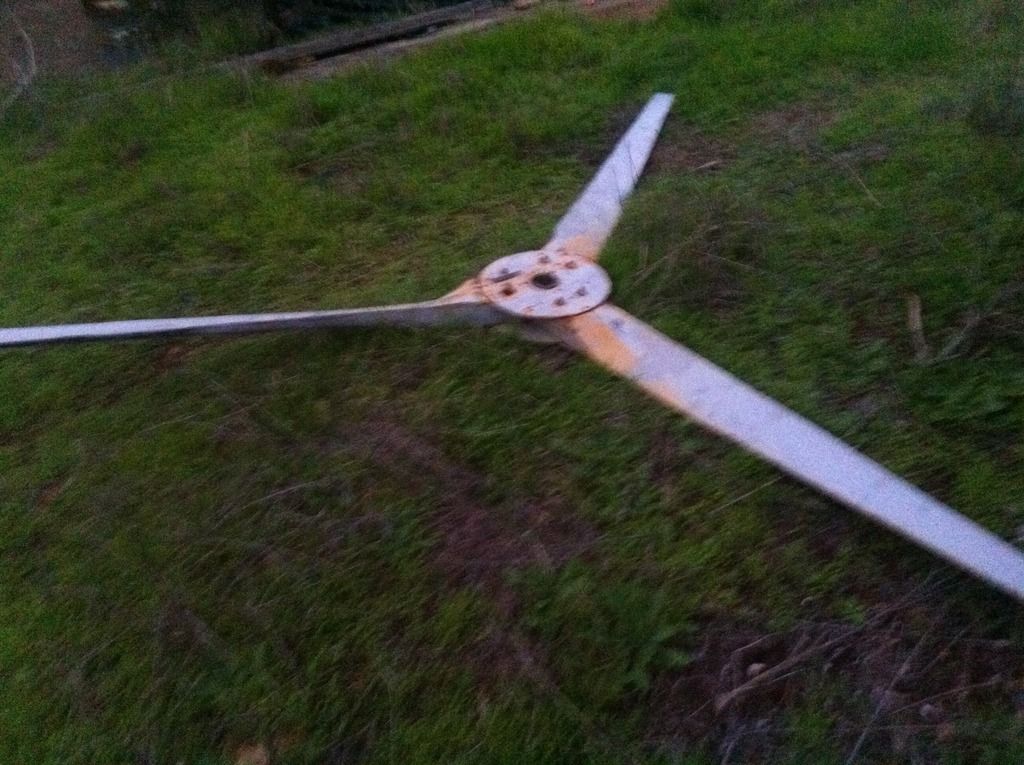

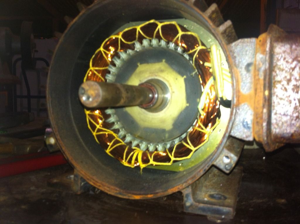

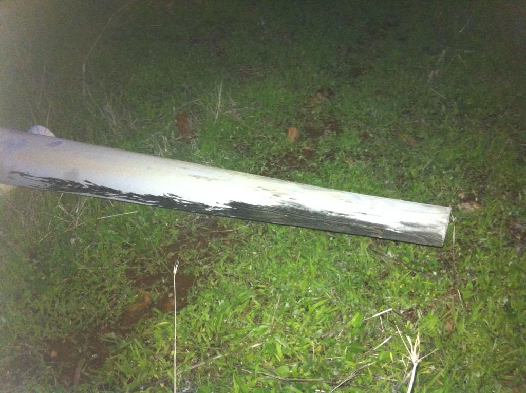

                     Well took a few pic's just before dark
The Blades
The leading edge on one of the blades (the worst)
A pic of the front of the motor
and a final pic of the rear of the motor
In the end with the rear bearing I ended up cutting it off with my 4" angle grinder, so I will need to get the rotor out to polish up the rear shaft and checkout the magnets etc.
All up the conversion still looks in good condition so I reckon I will get a few more years out it.
Cheers Bryan

The blades look surprisingly good for that period. As I expect that this thing spent a lot of time above it's max current point.. so the blades were spinning fast, yet the damage is not too bad from here.

Well got home this evening after going upto the Clare valley today and looked up at the wind genny  :'( :'( :'( going wobble wobble with only 2 blades. :'( :'( :'(.
So duly got the tower down as we are execting some high winds and it was windy when lowering with the blades still spinning.
So 8 years out of set of old Oregon fence posts wasn't a bad run me thinks.
Anyway I do have a 2 metre blade sitting in the shed so I'll take out the conlock and fit it to the 2 metre blades and see how it performs.
Cheers Bryan
