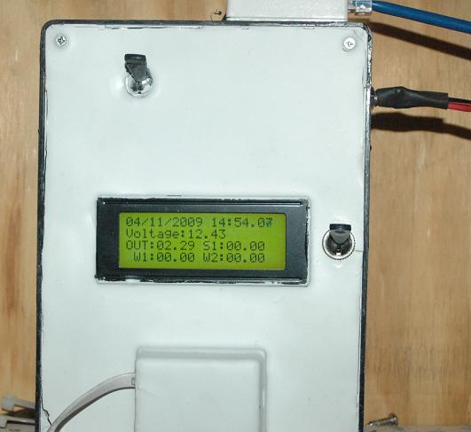

This is my monitor, based on a stamp, sounds similar. Using 912Mhz tranceiver to transmit data to the house.
The monitor shows battery voltage, (s1) is solar amps in, (w1) is wind turbine 1 (w1 is down for repairs)amps, (w2) is the second turbine,  (out) is outgoing amps... right now its pumping my little waterfall / stream

I'm usng 4 amploc's z25's and am I am dropping to punt too... I 'm replacing with  4 shunts instead ( 50 mv drop). Might just be these amploc units but I'm seeing variance .... not good. I'm no mech or elecetrical engineer, ...pretty good programmer though.
I initially thought it might be my ADC and the temp variance, but my voltage divider feeds through the same ADC and is within 50 mv of my meter (full scale) .
...as far as wireless, I 'm using parallax non addresable units.. (going to swap these out shortly for xbee's since I run more than one set.. and I need to be able to address each unit)

Do you have enough filtering? Long cable run to the Amploc's might be picking up induced hum, or the carrier from the wireless modules?  You need an RC filter on the ADC inputs.

The ADC is powered through my stamp ,the power source for which i replaced with a switching 5 volt supply , that is fed through a 12 volt filter ( ok , cheap automotive coil noise type filter), but .. no joke see variance in the 500 mA range since calibratin at  stp  (or as near as I could get it).
I still think going through a good shunt, gets a better measurement... but I'm waiting on on some SOIC board before I test (damn I hate SOIC chips)
