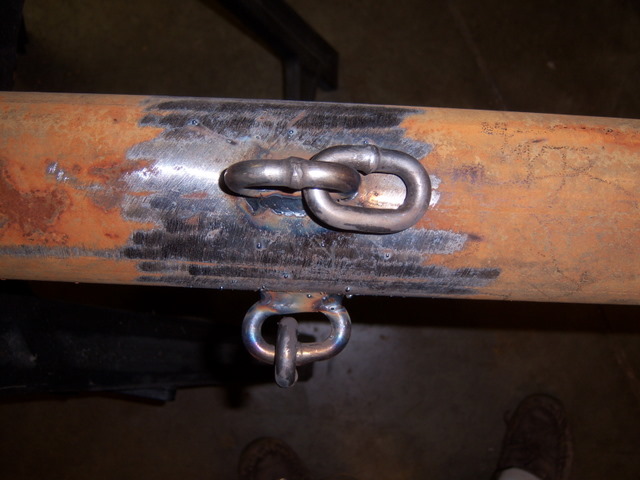

The 3" Pipe has threaded couplers, I know we talked about how bad threaded couplers are, so we did a little reinforcing.  4" pipe is a perfect fit over the threaded couplers.  I butted the threaded couplers together and welded the 4" to the couplers, and the couplers to the 3".

Used chain as a guy wire attachment.  I have seen controversary about this, and wrapping the wire around the tower as a mechanical connection backup.  Will have to see what it looks like once I start rigging.  My initial thoughts are to run the wire rope thimble through the free chain link.
