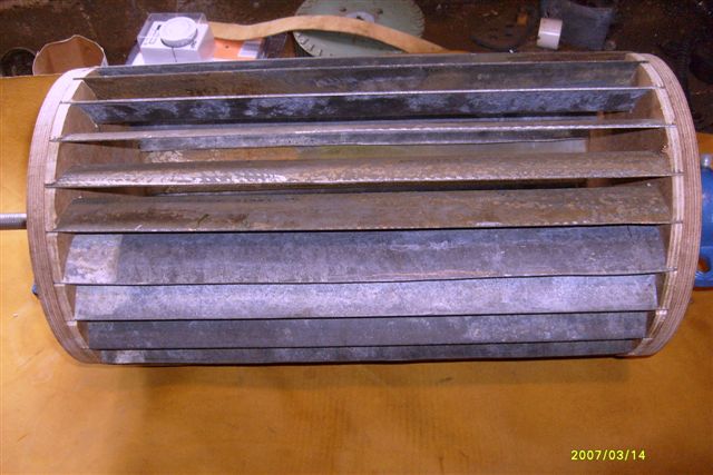

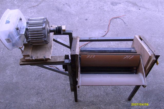

here are some photos of our work to date not very pretty ..yet
demensions are 17" long x 9" dia
so far we have had 1.5 amps into a 12 volt battery.... expecting more

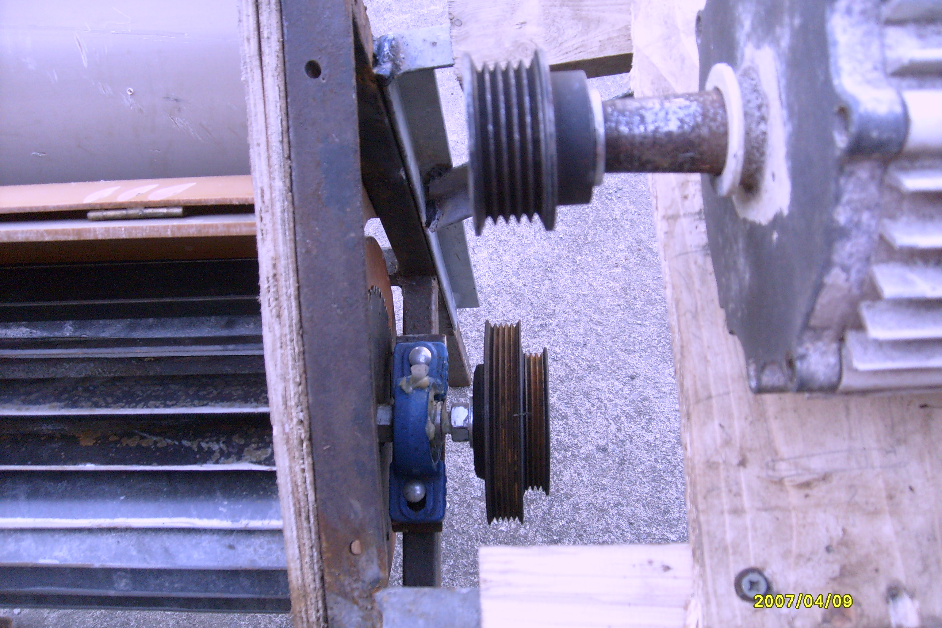

the gearing is about 3 to 1 with a serpintine auto belt
maybe 300 rpm at the genny...which is rated at 400 w 12 v........it was very poor as a wind turbine with a 3 ft blade
we intend to extend the flume to full head height and revise the nozzle adjustment to close off the flow completely so that the flume fills up and we can regulate the flow at full .......any ideas...?
the dam is next.. thinking of a wooden beam accross the river to attach the turbine to.......more ideas ?
the frame we got in a scrapyard..... a few mods , the legs were very handy for working height and also for positioning in the river

Not possible to get much idea from the pictures. There is no indication of your water flow or head but with that size turbine rotor you would be looking at a major stream to supply it and if you had a reasonable head you would be looking at quite a few kW out.
For 18W the thing is infinitely oversize and I bet your nozzle is not even running full let alone being fed with the static head of your supply.
For 18W think about a rotor 1" wide and perhaps 6" diameter as a more practical size.
You may be doing better than you think. I bet there are more iron and friction losses in that alternator than you are getting out. At that power level it may only be 20% efficient, most of which you could reclaim with a dual rotor axial machine wound for direct connection.

You may get a cheaper result with gearing but at 18W the belt drive is not going to be very good.
The alternator seems to be some form of commercial pma and I suspect it has an iron core that robs you of at least 30W. At its full rating the efficiency may be quite high so stick with it for now until you deal with the turbine.

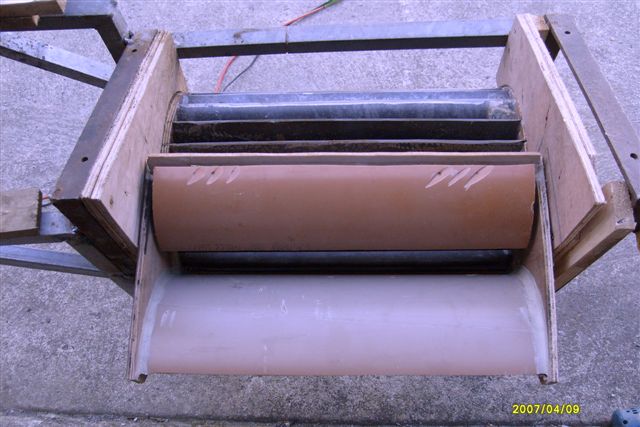

I may be wrong , and it is hard to tell from the photos but is'nt your nozzle pointing the wrong way- as far as im aware the nozzle should fire towards the top half of the runner, imparting most of its kinetic energy on the blades. The water should then pass through the centre of the runner, imparting a smaller amount of energy as it passes  the blades for the second time.
Or is the picture showing the runner upside down? Or maybe im being stupid...
Im following your progress carefully as we have two mycrohydro projects on the go later this summer. Looks cool so far!
matt
« Last Edit: April 22, 2009, 01:10:59 PM by mattg »
Re: hydro experiment
« Reply #8 on: April 22, 2009, 01:45:58 PM »
I can't tell much from the photos, it even looks to me as though it may be hitting the blades in the wrong direction but I wouldn't like to deduce anything from those photos.
I did refer him to pictures of an Ossberger turbine so I hope he has got it right.
The nozzle should be sort of tangential to the rotor at 10.0'clock and conforming to its curvature to direct the water into the vanes with the outflow striking the other side of the drum at about 4o'clock.
« Last Edit: April 22, 2009, 01:45:58 PM by Flux »

Pictured two methods of water flow we are using the verticle flow
Windspeed
« Last Edit: April 22, 2009, 03:19:18 PM by windspeed »
windspeed
  • Posts: 105
« Reply #12 on: April 22, 2009, 03:27:53 PM »
correction this is the flow we are using in our turbine
Windspeed
« Last Edit: April 22, 2009, 03:27:53 PM by windspeed »

I believe that type of water wheel needs the nozzle to cover at least 2 full vanes at a time.
That is why they control the width of the flow, in addition to the possibility of the flow into the nozzle.
Trying to control the nozzle like you are doing it looks like much of the water is not doing any work.

Oh I see, I havnt seen the vertical flow before.I stand corrected, thanks for the pics.

Once you get it working you could temporarily dam up the stream to get a couple minutes of full-width flow and compare the charging rate vs. the charging rate for the same head into a nozzle masked to a suitable fraction of the width of the rotor.  The battery voltage will roughly regulate the speed so by measuring the current (and the voltage at the battery for making the measurements more exact) you can get a good idea whether the lack of the extra wall matters.
If you don't need the wall maybe adjusting the nozzle by using a sidewise-sliding baffle will do the trick.  B-)

I seem to recall that you get the bulk (2/3?  3/4?) of your power when the water enters the runner but you need the exit stage as well to get nearly-all.
The Banki is also nice because it mostly self-cleans (the water exiting the runner pushes leaves and crud back off) and has a flatter efficiency curve with varying load than most other turbine types.

That's cute the way the "startup" picture shows the angle of the jet changing as the rotor speeds up.  Also that the water has left virtually all its momentum behind and is just dribbling down after passing back out through the rotor.
« Last Edit: April 28, 2009, 04:32:12 PM by Ungrounded Lightning Rod »

I get the impression that the thing is running unloaded. When running the jet hardly seems to be deflected. Your peripheral velocity seems to be that of the jet not about half for maximum power. Even if the speed is too low to light the bulb your alternator should be able to hold it down to half speed even if it is at a very low voltage.
Again the whole thing looks to be far too big for the available water supply. At least you have restricted the jet width to something reasonable. A smaller runner would have got the speed up but with a suitable winding you should be able to get the volts up even at low speed.
From the water supply I can't see much power being available and a decent low speed axial air gap alternator is the only thing likely to get you a decent % of what you have. Geared motors will loose you nearly all of it. A larger diameter pair of discs with lots of smaller magnets should get you what you want.

Also, Windspeed I like how you have made your nozzle variable by using the two halfs of pipe.  Have you pre loaded one side with an adjustable spring as to get the most effective conversion of static pressure to velocity whilst minimising or stopping air from entering the system?

Jon you raise an interesting point. This is a guess .
The Banki is normally used for low head with high flow, that is why it is normally a very wide runner. To be able to deal with the very high flow required for high power in low heads the thing normally runs with several blades in operation at once. Water availability control normally alters the nozzle area and hence the number of blades in contact. Conversion is done in 2 stages with about 70% of the power being extracted in the first stage. With the normal large flows there is still a lot of water to extract more power at it exits the runner.
With machines on very limited flow then I see no reason why you can't just hit one blade and it works largely as an impulse turbine much as  Turgo. In this case the recovery from the second stage may not be that high as with the very low head you will have lost much of the jet velocity on the first stage and the scatter from the first stage doesn't give you a good impact on to the blades for the second stage.
Whatever happens as long as you have the full head available to the input of the nozzle and you convert the pressure energy to velocity at the nozzle it should work reasonably well with just one blade. In the large machines with lots of flow I am not sure that maintaining maximum velocity at the nozzle is quite so important.
When you scale things down to micro hydro sizes things tend to behave differently.
Normally for low heads impulse turbines are not very practical and the choice would be some form of reaction machine but the small flows, clearances and problems of rubbish make it very difficult to make an effective tiny reaction turbine. Even propeller turbines need more water than you have available unless you get into very intricate mechanical design.
The Pelton and Turgo are not ideal from the specific speed point of view for low head and run inconveniently slowly but they do hold up on efficiency well and are less bothered by some of the other problems with low flow. You may be in the region where a Turgo would do better than a Banki, especially with a vertical shaft Turgo with runner just above water level to use the available head. For home construction the Banki is simpler to make and with normal heads and flows it is a good choice but there are always compromises.
