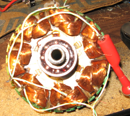

Here are some pics of the fan.
The first one is a close up of the coils
http://www.otherpower.com/images/scimages/9657/openedupcloseup.jpg

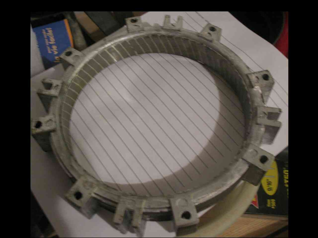

The next one is the cage
http://www.otherpower.com/images/scimages/9657/Cage.jpg

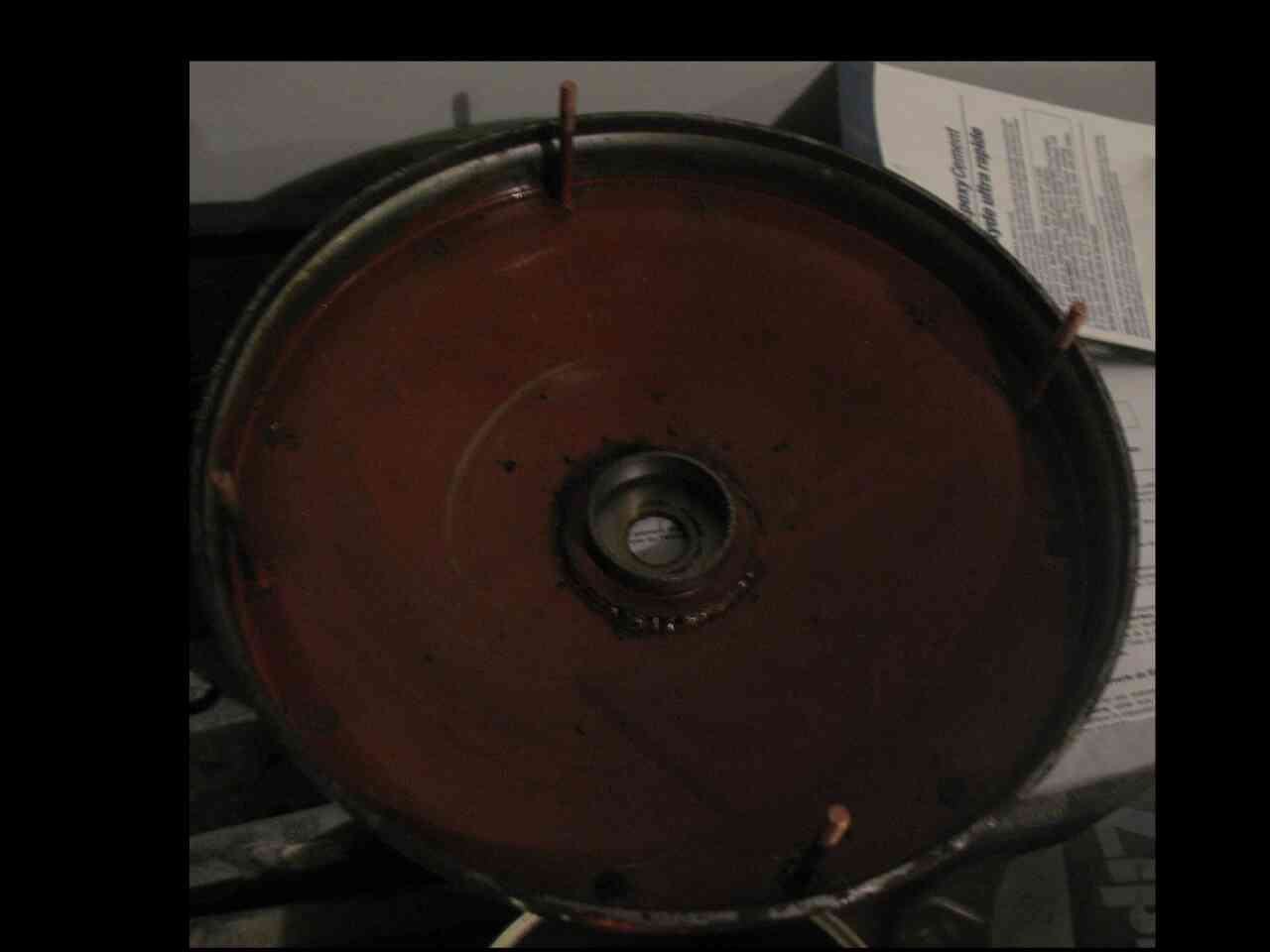

The next one is the lid
http://www.otherpower.com/images/scimages/9657/ceiling_fan_lid.jpg

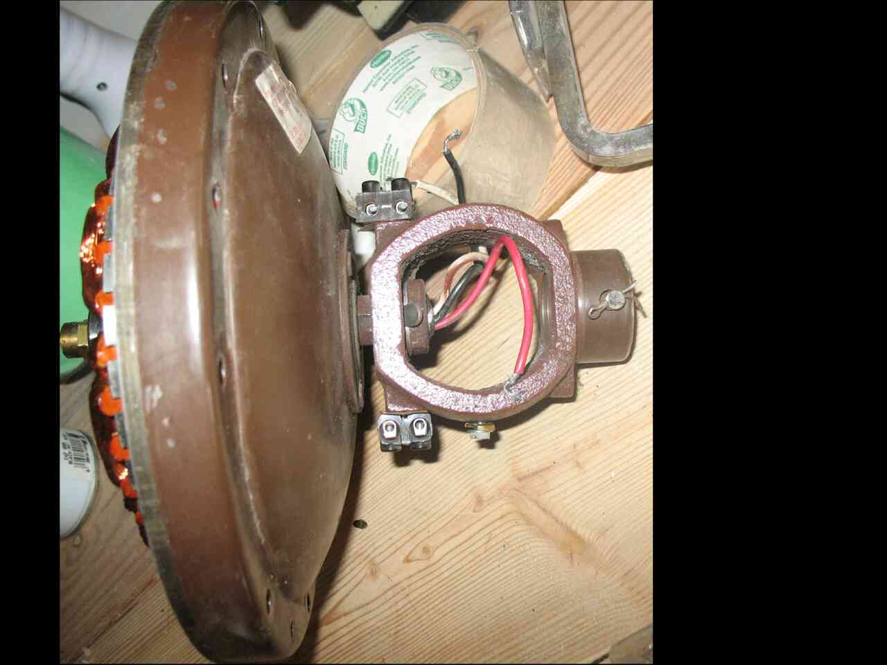

The last one is the back.
http://www.otherpower.com/images/scimages/9657/backceilingfan.jpg

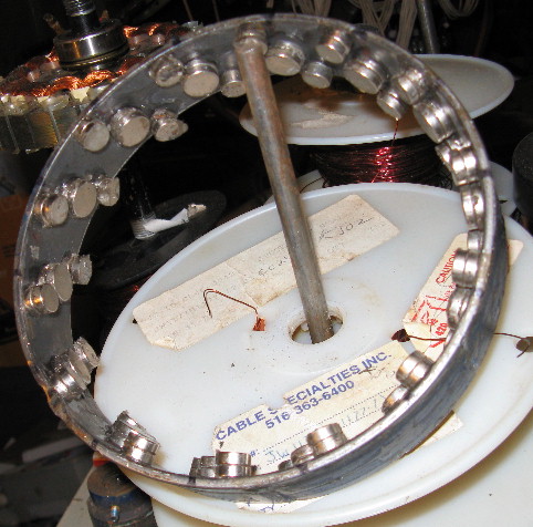

Make a ring from thin Flat bar 3/4 inch diameter larger than the stator I think 1 1/4 (homey for 5 bucks ) find somthing slightly smaller in diameter to form around  and overlap . Parallel the inner and outer and bring out 4 wires 18 gage is good .Make sure you get the starts and the ends of each coil solder together right the other side of these has taps cut and retap for parallel coil each coil is 8 + ohms so you end up with 2to 4 ohms per which will cut in at around 200 rpm 12 volt  ( may stall without some resistance or PWM .I'll post a similar motor a little later that I am just finishing a rebuild on the mag and taps to get 12, 24 . You can use thread coupling behind the flatbar ring looks like 5/16 will work or 5/16 brass pipe cut to make stand offs.

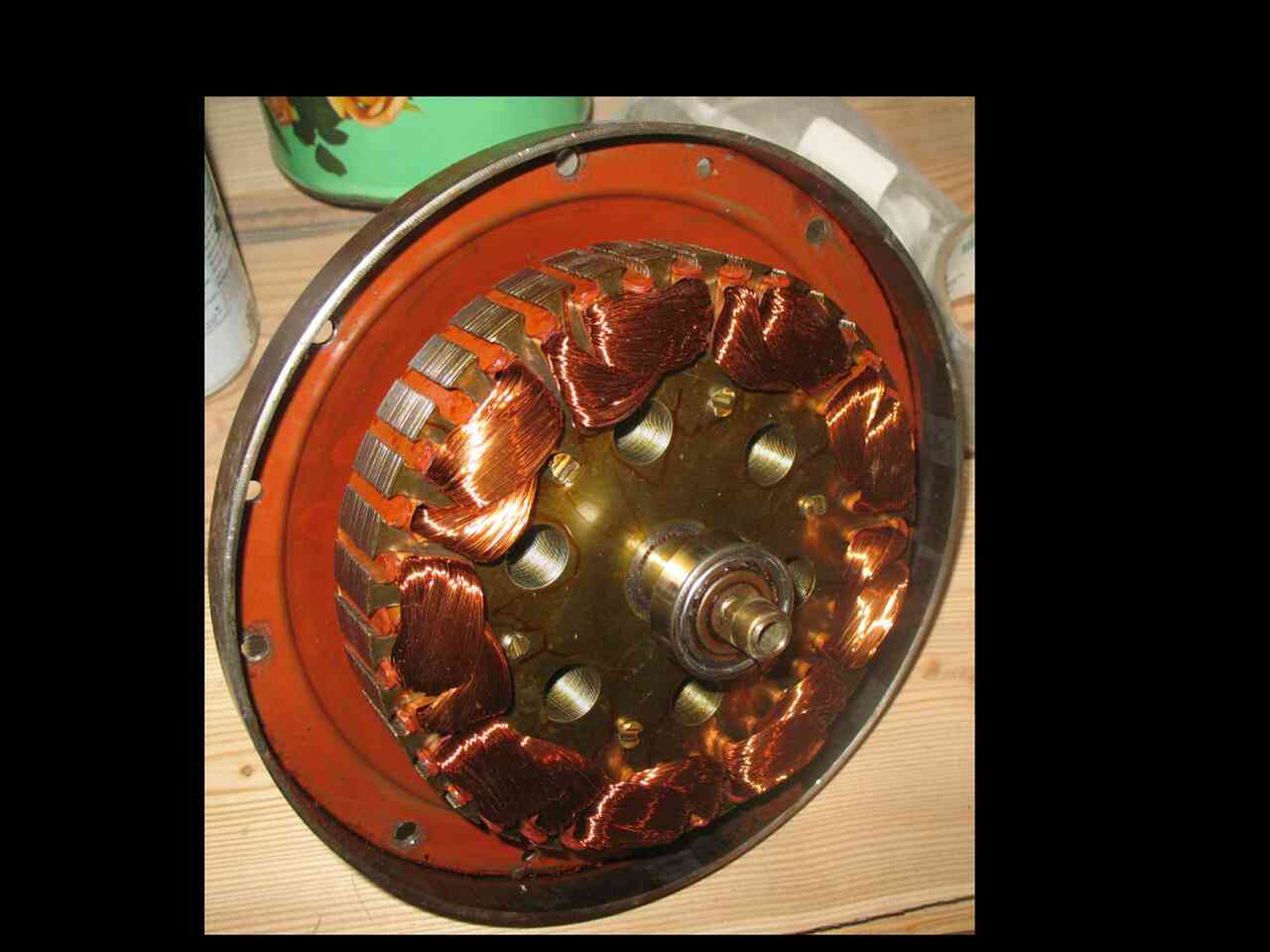

Her ya go .This motor is smaller than the one you've got posted . The inner set is low speed the outer is the high speed . All tapped the each coil is good for 1.5 amp or at least I 'll hold it down to that and it should run cool enough . The mag placement is untested I feel confident this slant is good for a start up to 200 rpm that's a little slow to stay out of stall but I have some mods for low speed I've been working on . That's why the rework on this motor .Good luck on the conversion.

The reason for the for wire are to distribute the load better and give a center tap for boosting .

Thanks for the pictures of your fan conversion. This flat bar ring seems a good way to go. Did you just try to reproduce the slant in the original cage with your magnet placement? That seems a good way to glue magnets on. If I can get larger magnets, I would like to be able to stick in place directly in the case. But I understand the flat bar also acts to redirect the magnetic flux. Is that the intent?
