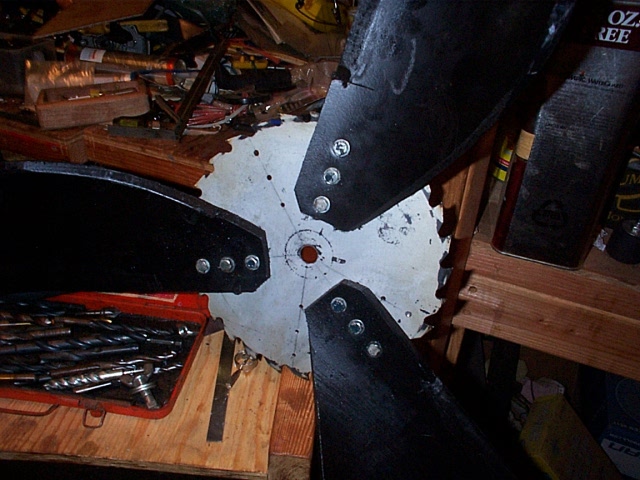

I decided to try an odd number of blades this time for obvious reasons, vibration, shadow effect etc, so it's basically just a matter of choosing a 3 or 5 blade configuration.

Maybe it was my lucky day but I think I found just what the Doc ordered. I ran into some 10" diameter black PolyPipe HDPE, EHMW PE 3408.
Extra High Molecular Weight (EHMW) High Density Polyethylene. The stuff is used in industrial applications such as underground fire mains, mining, landfill, water reclamation or sewer.
EGNW has some neat properties it's fairly flexible yet very durable, I don't think you could possibly break it unless you poured liquid nitrogen on it then hit it with a sledge hammer. The wall thickness of the piece I got is 1/2" so it's got plenty of bulk to it allowing it to be shaped nicely. It cuts, carves and drills like butter.
I cut the pipe into quarters with a skill saw. Curved lines cut nicely with a jig saw. I found it super easy to shape using a hand plane. The convex areas are easy to shave off but since the shape I was working with had just as many concave surfaces I just bent it back and was able to take care of a of these areas with the plane too. A wood rasp took care of the rest and I used a little cylindrical sander on a hand drill to smooth out the areas where I used the rasp. In other words it's pretty easy to use a number of tools to shape it.

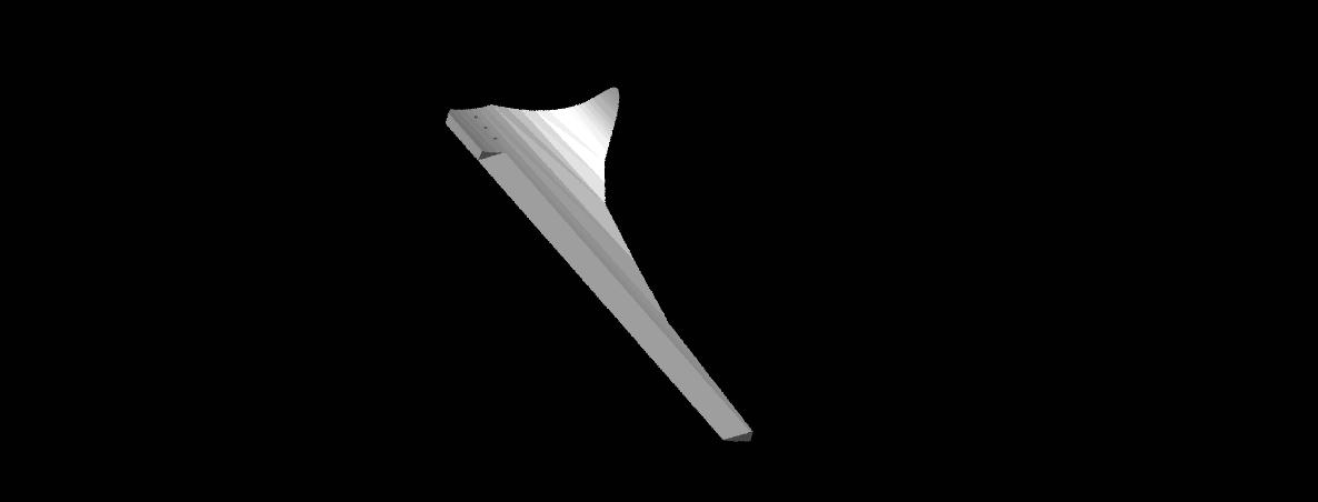

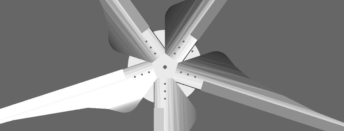

Before I dug in to do all this shaping I wanted to play around with several designs and overall shapes to see what I could come up with so I decided to visualize these in IntelliCAD, using solids modeling. The following is what I cam up with. There's nothing really new about the shape, I've seen very similar ones made by others here including Wooferhound, I think.
I had some particular design requirements in that I want these to make the best from the erratic, gusty, relatively low wind speed and changing directions here.
So, I wanted them as wide as possible at the root with the near 40 deg. twist and also figured that the more meat left near the root would also provide more reinforcement where so many of these blades tend to fatigue and break.
I also wanted the blade to quickly return to a narrower blade as I progressed away from the hub. This would, hopefully, provide some good lift and an apparent wind direction closer to perpendicular to the axis of the turbine.
I hope to make them as quiet as possible, although my last blades were extremely quiet, therefore the tapered rather sharp, trailing edge, smooth contours and round overs.

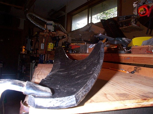

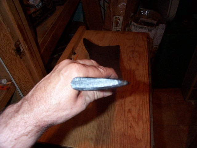

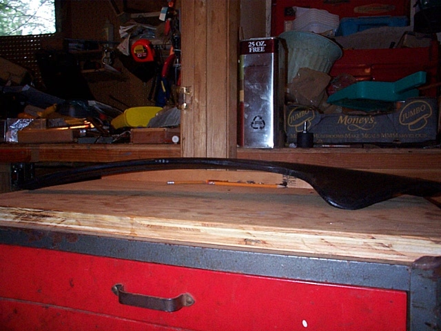

Now before I add any pics, I'll warn you that I had completely forgotten that many plastic materials tend to have a memory which wakes up when getting away from it's structurally sound, formed shape. In other words it warps or bows when you cut it.
When I cut the pipe in lengthwise quarters, no problem, the integrity of the cylindrical shape was not altered drastically enough to make a difference ... yet.
When I got out the jigsaw to cut the form, however the EHMW was silently grinning in the background, little did I know. As I began to cut, I was still none the wiser and proceeded to follow the penciled line on my paper masking. As I got toward the end of the cut, it was then quite apparent that the unpredicted antics of the EHMW had, indeed, gotten my goat.
So, serendipitously, I hope, the blades have a very distinct bow toward the oncoming wind. There's not much I can do about it, so I look at it as a feature rather than a problem. Only time will tell if they work well like this or not.

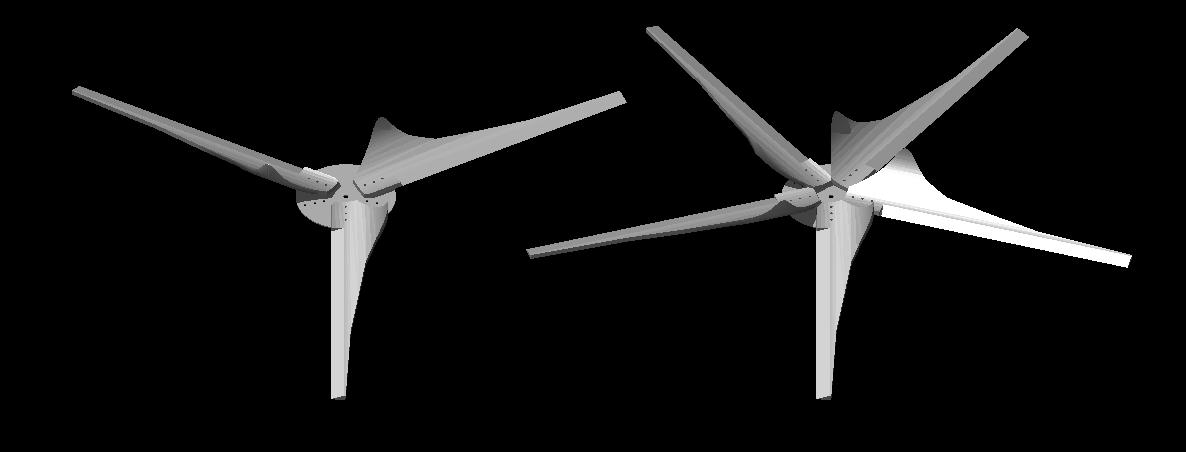

My biggest question was whether to go with 3 or 5 blades. I'm going with 3 for now but have the additional blades already cut and shaped should I want to try the 5 blade configuration.

Surprisingly enough, these longhorn (curved) blades work quite well.
We had a slightly blustery day the other day with wind speeds up to 17mph and these blades were flyin'. As I expected they do straighten out quite a lot at higher RPMs.
Fortunately they seemed to do it uniformly and track smoothly. I hooked up my ebike batteries for a load. I had just run them down to near 12V so it was a fair test load.
The blades didn't slow down much at all and appeared to work well under load as well.
What this tells me is that they will do fine until I make some wooden blades.
I have revised the dimensions of the blades at http://www.otherpower.com/blades.html
so mine will be 2/3 the size of those or a 6'-8" Diameter. I like the fairly simple construction and should be able to make some decent blades from some 2x6 material.
If I can locate some spruce I'll go that route but cedar or fir is more likely.
The thing I liked about the plastic blades is that they didn't take long at all.
Maybe 4 hours to get them cut out planed drilled and on the hub.
Hopefully wooden blades will go smoothly too. My bandsaw should help cut off the unused portions and a draw knife should make quick work of it.
