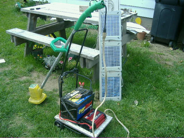

So I don't usually recharge the 75 amp/hr battery
with the ped gen
The 110 volt weed wacker uses about 150 to 180 watts.
 So it takes quite a bit to recharge with
the pedgen....but I can start charging it with
pedal power until the sun comes up ....then switch to solar
power.
This is a roundabout way to so it....would be easier to recharge a 18 volt weedwacker, it just
shows how much you can accomplish by ped generatin'
« Last Edit: May 17, 2009, 07:25:45 AM by Norm »

« Reply #5 on: May 17, 2009, 08:59:13 AM »
Thats really cool Norm.   I already know what many of the guys around here are thinking-- "Wouldn't it be More efficient to just make a pedal powered lawnmower directly.  You could save 20 percent losses!"   -Sorry couldn't resist.
I am trying to become a member of that pedal society thing. But I only usually do a quick lazy 20 Watt hour a day or so.(2 min each time I have to use the toilet room)

« Reply #8 on: May 19, 2009, 08:19:01 AM »
Bruce,
   Went to the Mall yesterday....$99 for a B&D
cordless weedwacker....I got weedwacker parts
hook a car heater blower motor on one about 10
amps....maybe more will be a lot cheaper?
Off to my daughters to wack some weeds with the
'almost cordless weed whacker'
« Last Edit: May 19, 2009, 08:19:01 AM by Norm »
