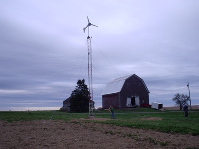

Anyways here are a few photos of the day we put it up. I don't have any of the tower being raised, or assembled on the group (I was too busy helping).

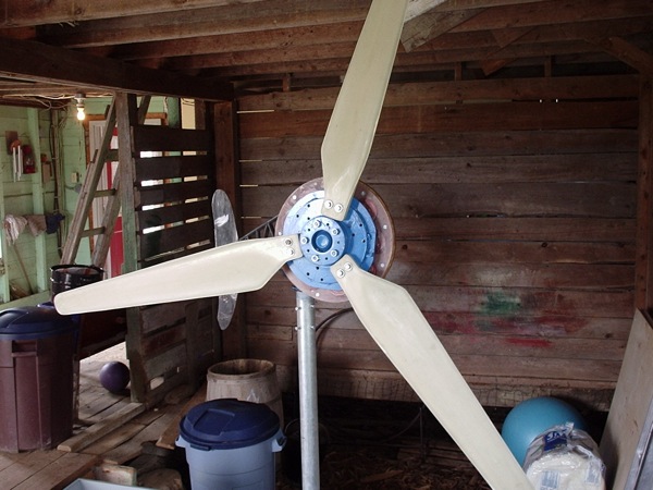

Here is a picture of the whole machine put together in the garage before we raised the tower. It was actually the first time all the parts had been together. It was hard to work on some parts of it at home and bring some to school. This was really exciting for me to put it all together and see it up close. It also allowed me to iron out anything that might look messed up.

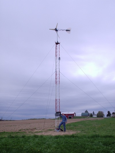

We used a bucket truck to lift the tower up and we guyed it off. The man running the bucket truck let me put it all together up at the top, it was quite a thrill. The tower is 36 feet high (sure feels a lot higher when you're in a field). We had a beautiful day that was dead calm to put it up, couldn't have asked for better weather. Pictured is the newly installed turbine and one very excited boy.

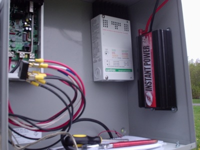

I was hard pressed for time at the end of the year and as a result we only finished half the wiring, here is a picture of the box we installed. I'm using two Xantrex C40's to regulate the charge on an Optima battery that is hooked up to a light (mounted on the tower) that connects through the inverter. I also need to make some serious adjustments to the guy wires and re-balance the blades I think (it vibrates a lot when it reaches charging voltage). Here is a picture of the nice box we got, they even let us pay half price for it since they liked the project so much.

Looks like you were just waiting for spring to wrap that unit up looks good up there and that's a really nice picture . The fiberglass blades are light enough to be supported at the root by two bolts .I would coat the area around the hub to keep the weather out any loosening will give a big change in vibration and ruin the mounting blocks at the root fast . Looks good

I think you will find that all of these machines "vibrate" right at cutin. Thats just the sound of power being produced.
Try this on a relatively calm day while it is charging batts: remove the load for a second and the vibration will go away. If so, then it is pretty much normal sound of a working turbine. Mine all have done this.

Everything looks good but why not give the C40's some headroom for heatsink ventilation?

Firstly because it's the first time I've ever used these and I am not sure how much heat they'll give off. Secondly because we would have to get a bigger box and that is expensive. I tried to stay on budget as much as I could with this project even though I did have to go over.
