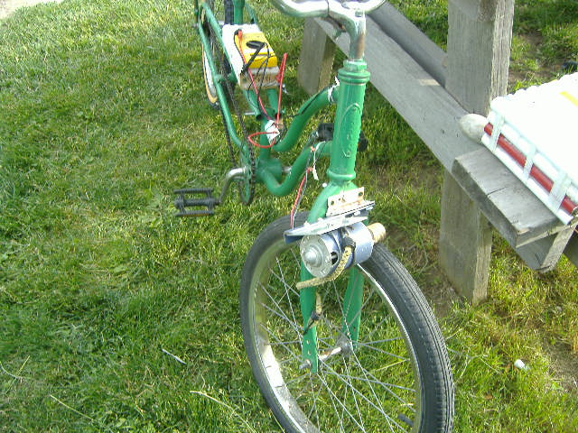

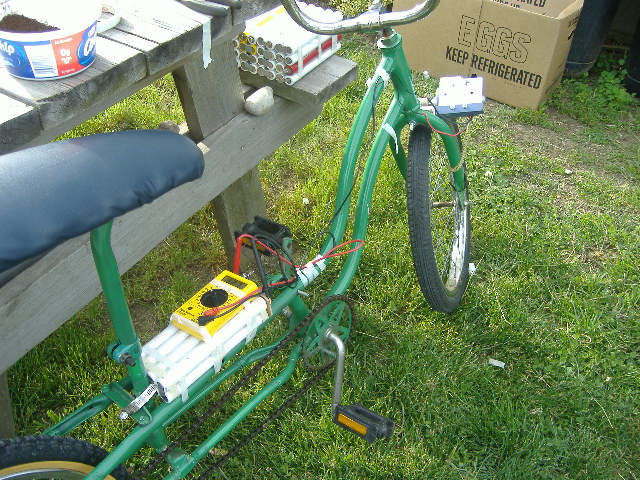

 Temporary hookup to see how well it works, way
too much tension on the wheel...
I plan on fixing it so I can raise the pulley on
hills.....
Put 8 miles on it so far about 20 watt/hrs.

The color is much better!
Do I recognize the motor?
How many amps?

Be careful pedaling that to the court house, police station, post office, etc.
It looks like about 6 or 7 pounds of dynamite on the bike and that bigger pack on the bench seat looks like it could blow up three quarters of Conneaut!!!

Almost 2 amps if you pedal real fast....there's a
hill down to the creek I can probably get going
35 mph maybe 4 amps???? ....but it's a long tough
walk up the other hill !!
Yes you do....its the motor I had on the first pedgen.

Now that you mention it...it does ? Paint the
sticks red.....and ......the yellow muti-meter
could be mistaken for the detonating device
careful ! ....be sure and cut the right wire !
I'm goiing to make a cover for them and permanent
terminals.
Got less tension on the pulley...big difference
especially pedaling a couple of miles or slight
uphill feels less like Pike's Peak !

 Interesting setup.. why did you choose to power the front wheel instead of the rear?
So does this setup give you enough extra power to the road to be useful?

Well first off it came to be set up just like it
was on the exercise bike also the bolt that
originally held the front brake just happened to
fit the middle hole of the hinge....just drilled
it bigger and used a larger bolt.
 I also like to see what's going on had a bicycle
alternator once on the backwheel of my motorbike
once reached back to flip it on one rainy night
and touched the terminals....Ouch!
 No this setup is just for charging batteries
the motor isn't powerful enough at 12 volts,
but it is dandy for charging my cordless drill batteries,
just for fun! One less wall wart....
