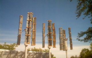

I completed the installion of 3 single phase vertical axis wind turbines.
I purchase a small CNC router to aid in the fabrication of the blade supports and rotors. It is a Zenbot, great bang for the bucks. The only downside is the Mach3 software, it has a problem, there is a accumulative offset of 0.0009 of a inch after each axis moves that does not show up on the digital read outs. I am now using Kcam software and it works great. I can draw a part using TurboCad to create a .dxf file. Open the .dxf with lazy cam Pro to create the G-code and use the G-code file with Kcam to cut the parts.
I tested the alternators with a variable speed lathe and a auto head light for a test load and they max out at 5 amps @ 16.3 volts @ about 700 RPMs.

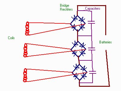

I am looking for a circuit that will allow me tie the 3 turbine together for a higher voltage at lower wind speeds. If anyone has any ideas please let me know.

G'day Kilroy,
             Is that a huge batch of PV panels right next to the vawts ???. If so I'd be making damn sure those vawts don't over speed in a storm and fly apart into those PV's.
Cheers Bryan

Hi, it just the greenhouse.

KilroyOdin;
What is the scale [size] of this unit?
Looks like fun stuff.

The hookup you're looking for looks like this (from Wooferhound's files):
That circuit will add the voltage of three phases together on a single motor but it may behave strangely in your case since the current flowing through the system loads the individual alternators in an unstable way.  Basically the turbine with the weakest output (even just a little less) may slow dramatically or even nearly stop due to the "electrical back-pressure" from the other two.
In any case it'll be cheap to try.  You just need three bridge rectifiers and some wire to hook it up.
The capacitors will be some help and they need to have a voltage rating at least double whatever your system voltage is and the highest capacity (in microfarads) that you can afford.
« Last Edit: June 13, 2009, 08:18:56 AM by RP »
Re: 3 single phase VAWT waiting for wind
« Reply #10 on: June 13, 2009, 10:29:39 AM »
I think it will work.
The bridges will act as a by-pass diode if one is stopped, meaning no the "electrical back-pressure" to stop one.  One may stall.
The caps can be attached directly to the bridges.  Only need the one wire running between windmills.
« Last Edit: June 13, 2009, 10:29:39 AM by ghurd »
