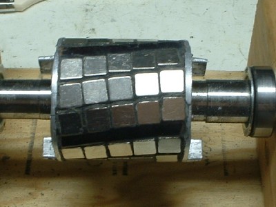

I also have an old lathe that I bought http://www.otherpower.com/images/scimages/1725/Elatheshot.jpg just for turning rotors. It's a '48 craftsman 6x12.
I've turned 6 rotors so far.
This might not be totally correct from a machinists point of view, but what I've settled on using is the pointed turning tool and a lathe speed of 315 RPM with a screw feed for 8 threads per inch.
I got a box of 5 carbide bits from HF (2 left, 2 right, 1 center point) and tried them all. The cutter has lasted through 4 of them so far and is still good.
The aluminum/steel matrix is one hell of a noise maker.
Since this is just a mini lathe I can only take off about .002" at a time. I leave the aluminum ends on the rotors to help keep the magnets in place http://www.otherpower.com/images/scimages/1725/AEG2mags.jpg.
I start the cutting process with the ends, going about 1/2 the total depth and then flush up the middle with the end cuts. Then I cut the ends down to the final diameter and finish the middle. I just change the angle of the tool for all the cutting.
I make about 3 passes at .003" increments and then a fourth pass without an increase, this trues up the cut. A sheet of paper is .003".
The 8 threads per inch feed will leave a nice rough surface for the epoxy (JB Kwik) to bond to the rotor.
There were posts a while back about delaminating rotors while turning. I have had no problem with this using the pointed turning tool and taking off small increments. I had never ran a lathe before and this was all seat of the pants learning. But, I feel I've got'er down pat.

I'm not sure the 8 threads per inch is correct. I changed the gearing until the feed rate left a ridge between each turn and didn't take all day to make a pass across the rotor. It's not a quick process to turn one down.

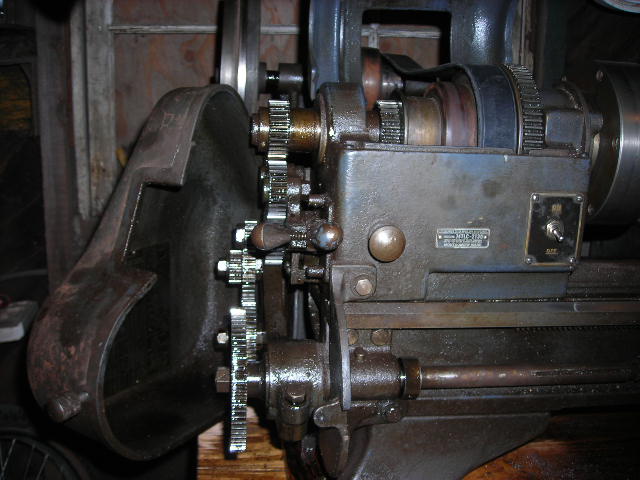

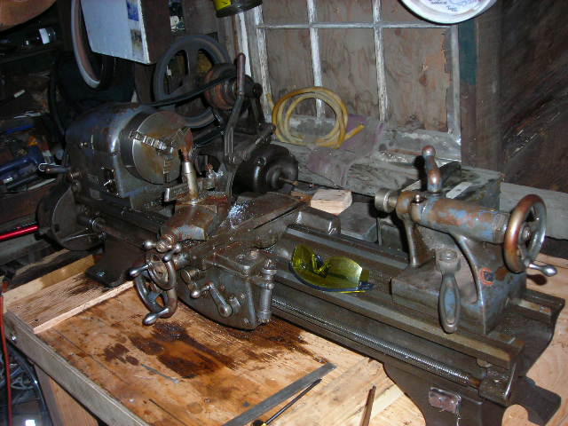

heres a few picts of the lathe....made by montgomery wards-belt drive-just a regular belt to hold your pants up
cut the ends off then sewn togeather with dental floss-works great..
when i first tried it out the darn thing ran backwards...what the ---?
checked it all out--hmm--[days later]looked at the on and off switch on the motor
flipped it down--hay easy fix--wasnt a on and off switch after all...

« Reply #6 on: June 14, 2009, 06:19:49 AM »
that lathe is a "logan" and rebadged and sold my montgomery wards
it is a superior lathe in many ways to the lathe the sears roebuck sold
which was a rebadged "atlas"
from what i understand most parts are still available for it, one of the sons or
grandsons of the logan family owns the rights and does support for the old machines.
there are many groups and forums for the logan lathes.
you should get many years of use from the machine, nice addition to your shop i am sure.

« Reply #7 on: June 14, 2009, 07:12:01 AM »
Sweet lathe there Hiker,
If you've never ran one before I suggest you get a copy of 'How to run a lathe' 1942 South Bend edition. Lots of good info.
What accessories did you get? Hopefully a 4 jaw chuck and the extra gears for the screw feed.
One of the things stressed the most is to make sure the lathe is set on a level surface. The bed will twist and it will not cut true.
Very nice lathe, Happy turning, and may the swarf not get in your eye.
