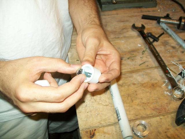

I recently got 210 NiMH cells from ebay for my high voltage electric bike (260Vdc). 260Vdc is very dangerous, your death is guaranteed if you get hit by it so dont take the idea from me if you are inexperienced with HV machinery. I just wanted to show how I built the packs inspired by someone in this forum that did something similar some time ago. I added some nice features to mine.
The construction only needs 1/2" PVC pipe and caps, springs, 1.5 inch bolts and nuts for them.
The batteries:
The cap:
Now drill a hole right on the center of the cap to snugly fit a bolt through it:

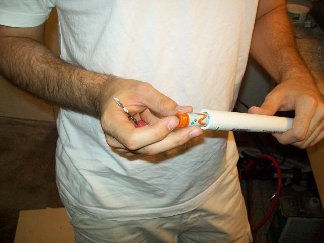

Put the cap on the previously cut to length pipe and fill the pipe with the batteries.
Slide the spring inside another bolt and slide it through the hole on another cap. The spring stays compressed in between the bolt head and the cap. This creates preassure against the batteries making a very nice contact. The bolt head must be small enough to fit inside the pipe.
Repeat
I was talking to Zeus last night and its a good idea to glue one of the caps to seal it off nicely and the other cap could be made removable (for servicing) by threading the pipe perpendicular to the batteries and inserting a bolt across the end cap to hold it in place.
The "subpacks" as I call them, can now be connected in series by using wires and terminals in between two nuts per bolt. Bolt resistance is not an issue for me as peak current will be about 5A and I used 5/16" bolts.

Question about the tightness of the batteries in the PVC, just how much room is there in there?
Are you using thin walled or thick? Since Ni-based batteries will get "warm" during charging, I'd be a little concerned about the middle section getting much hotter than the ends and not being able to vent.
I do like the idea, similar to Norm's of using bolts and springs to keep positive pressure for a good solid contact.

I thought about the temperature rise but I will be using very low current because of the high voltage. The thermal conductivity of PVC is about the same as that of plastic used in toys/cell phones and other electronics that have batteries inside. The batteries have about 1mm play so they dont really bounce inside. I do need to make some little vents on them in case they get hot (but I doubt it).
Because of that reason I dont think this is a good idea for low voltage machine. At low voltages you need more current to get the same power so they would just get cooked inside.
Anyways because they need charging, there will be a thermistor inside to monitor the charging process. This thermistor could be used to monitor battery temperature as well when the pack is being discharged.
At work I often find myself dealing with DC voltages of over 1000Vdc so I dont really mind 260V. There are procedures to do this safely but I do not recommend this to someone that have never dealt with such voltages before.
