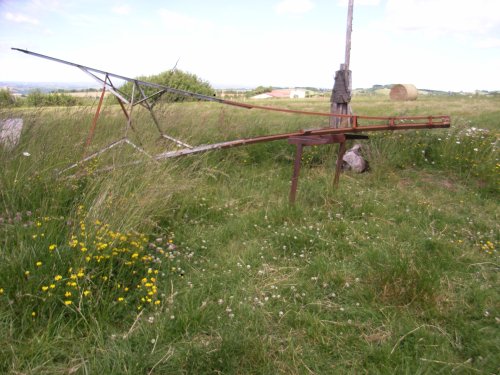

If you make another,you should try something like this
this one is still waiting for the finish.
Some people think that eiffel made his tower to make it look fancy.But it is just economy,going as high as possible for the least material invested.
By the way,That grass represent a lot of btu's.If you want to reduce your carbon footprint you should mow it,wet it and press it for fireburning.Just an idea for if you run out of projects...

« Reply #6 on: July 01, 2009, 06:56:24 PM »
stonebrain;
Interesting approach to that tower type. Is that factory or did you "reconfigure" it?
Mine was a freebie that had got slammed by high winds and was twisted pretty bad 60 footer to start only got a enough strate material for the 20 foot height 4 leg so I did that stub trick with much too light of material but fixed it now. It is something around 32 feet now to the hub center.

« Reply #7 on: July 02, 2009, 04:32:14 PM »
"Interesting approach to that tower type. Is that factory or did you "reconfigure" it?"
I just wanted to upgrade my small selfmade 3leg tower,I didn't plan it like that but it turned out to be the best way.I'll update my dairy about my vawt soon,with further explanations.
