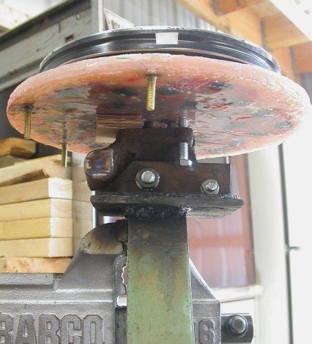

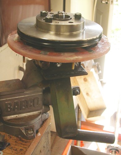

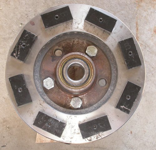

figured i would post some pics of my Piggott 4' machine in progress.

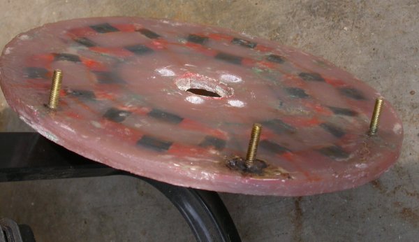

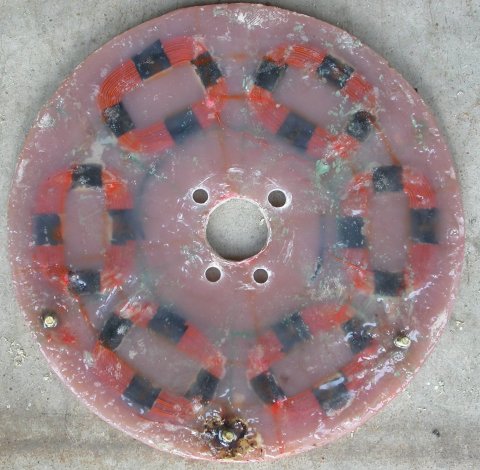

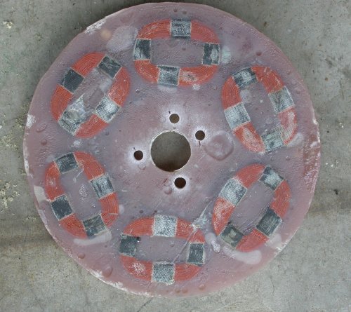

here is my stator.  had a bit of trouble w/ it...you can see some internal air bubbles, and some pop marks on the surface.
i made the connections to some brass bolts so all connections were inside the casting.
here is my magnet disk, a brake rotor.

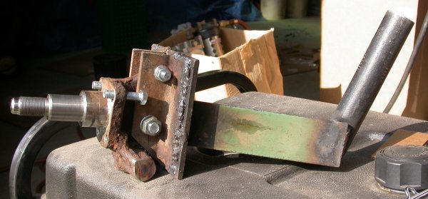

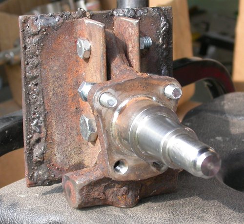

i used a rear wheel spindle from a front wheel drive car.  i had to machine the hub a bit to fit my rotor.
here is the frame, minus the tail and yaw pipe.
being put together for testing...
plenty of small problems along the way, but it's coming along, and so far it works as it is supposed to!

yes, i know my welding is terrible!  for the important ones, i tack it, and i have my dad finish it, he is MUCH better than i am.

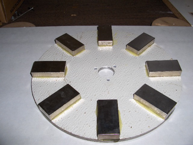

I'm abit confused by your coil and magnet orentation. I've not seen magnets and coils set this way.
Normaly magnets and coils are set pointing outwards from the center?
I'm sure thats how its described in Hughs book. I can't confirm that now, a freind has my book.
I would think this orentation would reduce power output with the magnetic lines of flux cutting accross the smaller part of the coils.
However you say your test #s are on trac? Can you laithe test with rpm, volt and amp #s?
I have done this plus prime driver power requierments as well.

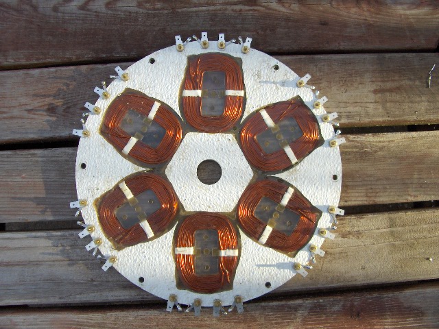

Here are a couple pictures of how I think magnet and coil posistion was sugjested in Hughs book? I could be wrong?
This is the stator.
This is the magnet disc rotor.
I am very intrested in your complete test #s. Thanks for shairing.

the 4' machine is Hugh's book is as i have done.  i asked about it before i started...
http://www.fieldlines.com/story/2009/2/8/235213/8286
so i just went with it.

hugh changed the 4' design in his latest book turning the magnets  and coils sideways how he has it in order to make more room at the center for the hub..... that is what i have heard anyway.....

when i was testing the output of a single coil, i should have rotated it and the magnets to see if the voltage changed.  too late now, all my coils are in resin!

Ditto what Kurt said.  There had been a few comments on it here at the time if I recall correctly.  Jerry, this is about when you would have been real busy with the rebuilding.  Rich

Yes Hugh turned the magnets round on the later version to get more space in the centre of the stator for the hub. The original version had a strange bearing arrangement with the stator up front and the magnet rotor at the back. The new arrangement is easier to build.
There is not much difference with the magnets turned round, you are looking at flux linkage, don't get bogged down with this stupid myth about active and dead coil sides . This single conductor emf equation implies that long conductors passing the magnet have higher volts and it is true for a single conductor but when you make a circuit the whole thing causes infinite confusion. If you have a given sized coil and magnet the flux linkage is the same and if the angular velocity of the magnet is the same ( same rpm) then the voltage will be the same. The only thing that could be different is the length of wire in the coil  and that will affect the resistance a bit but it is second order.
The magnets turned sideways gives a simpler and more practical solution but the old design has a very similar performance if you can manage to build it.

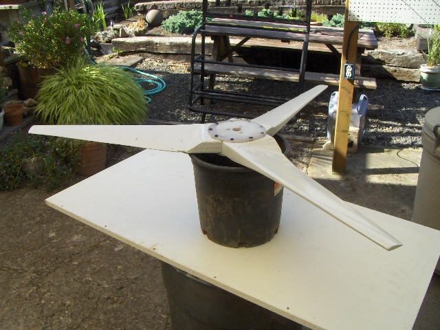

Well I started these blades 2 days ago. Outsiside of ballancing these are ready to fly.
I've even sanded them smooth and primed them and painted them with wight epoxy paint.
Here are a few pictures. In 1 of the pictures I set 1 of my nose cones on just for fun.
This is the nestled version.
I think I've come as close as I can to what Hughs design calls for.
Now maybe in a day or 2 I can get some wind tunnel test #s for the complete Hugh Piggot 4ft diameter wind generator.
Keep up the progress guys.

OK did a no load wind test of the 4ft blade today.
I still had my littel yellow 8" duel rotor alt mounted in the tunnel.
Hughs littel wood carved blades ran real smooth. It took a 1" stack of 1.25" washer for ballance.
A while back I tested my plastic "Jerry Blades" and some plastic pipe blades.
I tested them no load also and simply measured the voltage. All the blades were tested at 11 mph.
The littel 8" is a 24 volt alt. Here are the no load #s.
Pipe blades 30 volts.
Hughs carve blades 32.25 volts.
"Jerry Blades"    46 volts.
I hope to mount the complete 4ft Hugh Piggot wind genereator in the wind tunnel tommorow and do load testing fron cutin to the max tunnel speed.
I'll do this with all 3 blades and report the diferances.

Hi oztules.
Good points your making. As far as I know all of the blades except #5 have a tsr around 6?
I think this is what Hugh calls for in his 4 ft diameter genny. Correct me in any of this if I'm wrong.
My idea was to see witch blade worked best with this genny. My "Jeery Blades" have produced 1200 watts in some high winds. So I know they work well in high winds.
In these tests they've worked best at start up. Unfortunatly as of now my wind tunnel is limited to 12 to 15 mph depending on outside wind direction and speed.
I hope to make some improvments to top wind speed in the tunnel.
The other gennies I've been testing are also designed for 4FT blades with a TSR around 6.
I would love for some one else to build a wind tunnel and do the same tests I'm doing.
I'll even send them the stuff I'm testing just to see there results.
I welcome anyone to come over while I'm testing just to keep me honest.
I reports the #s I see thats all. You can make of them what you wish.
What I see is a group of blades and a group of gennies and the results of mods and testing.
Its not the materials that make these blades so difierand, it there shapes and airfoils.
I find the results intresting, they confirm my suspisions on designs and they help me dicide how I'll build the next wind machine.
Somebody build a better blade, well send it to me I'll test it. You know the genny I'm using just build it for that.
Well back to the lab more testing YA-NO.

Hi oztules.
Yes it does seem so. This was the first blade I've carved. At first I thought it wasn't going to work. Then it started to look more like a blade.
When I finished the blade I posted the question to Hugh if the blade was correct. I understand that Hugh is a very busy man and most likely had not either read the post or did not have  time to respond. I did think another blade builder would have checked the blade for correctness though.
I do have Hughs book and tryed to follow it to his instructions.  It did fly very smoothly. I belive it is the blade Hugh wants the genny to be flown with. After all its his design.
I simply wanted to see how other blades wold work with his alt. I don't think Hugh would design the wrong blade for his alt.
Is it posable another blade might just be better? Thats what I think is not being accepted here.
I think maybe a truck mounted test would be in order here to see the higher wind speed results. That may change the results on Hughs blade conciderably. I would also love to test a blade built to Hughs specs by a pro wood blade carver.
Thanks for the over seeing of my work.
