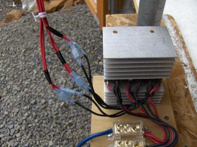

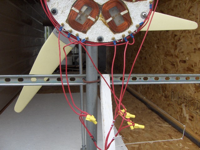

This has been a 3 year SAGA. In 2006 a discusion was going on about Hughs 4ft wind generator.
I was one of the discusers as well as Flux. I quote Flux from that thred. He was refuring to Hughs 4ft wind generator.
"you can't beat it with those magnets" Thank Flux I love a chalange. Even though its been a long one.
I've I've finnaly completed Hughs 4ft diameter wind generator and I've been testing it in my wind tunnel.
I've tested it with all stock star wireing as well as "Jerry Rigged" wireing scheem.
I've also tested it with several blade types.
The most resent test have been with 4 diferant blades. Today test was with the unit "Jerry Rigged".
Here are the test #s all stock wired star and with Hughs carved wood blades.

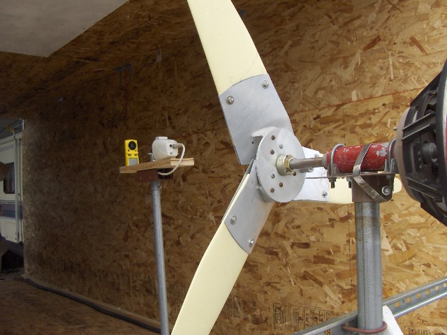

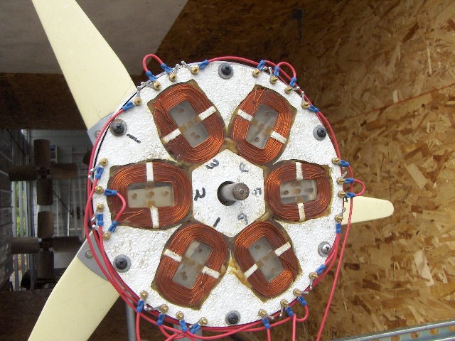

Oh heres a few pictures of todays set up.

Interesting work Jerry. You have caused a lot of head scratching over the years with your ideas and you have always seemed to get outputs from those 4ft Jerry blades that I thought was impossible.
Few of your methods would stand up to absolute measurement, even the present wind tunnel tests couldn't be relied on for absolute wind speed.
All your tests though have always been good comparisons of things under the same conditions so even if the absolute figures are not accurate then they are valid comparisons.
From your recent tests it seems that your blades suit Hugh's alternator better than the intended ones at least under those wind tunnel tests.
Some interesting things have come out of those tests which probably shows that blade matching is still the main thing that determines the output rather than alternator design as long as the alternator is reasonable.
With Hugh's alternator your blades give almost identical results with Star & Jerry connection so it seems that at 10 mph you are not matched to either configuration.
It is near impossible to know how things would work out in higher wind speeds where the matching would change.
It seems that the wooden blades are too slow for that alternator under your test conditions but it would be interesting if you could do the test with Hugh's blades with star and jerry connection.
I wish I had your energy and enthusiasm to follow up your work, you certainly have raised issues that would be worth following up.

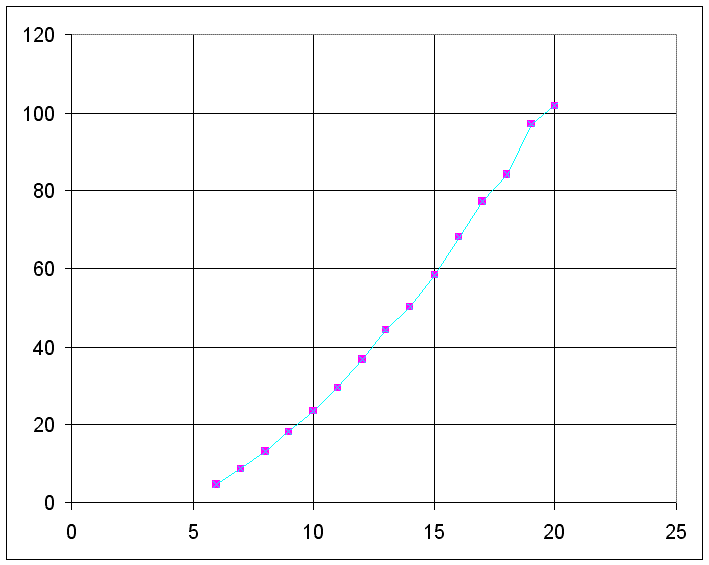

I did some actual wind tests on one of Hugh's 4ft machine several years ago and I have managed to find the results. I never tried with any other blades. I don't have a suitable site for decent wind power measurements so don't take my results as absolute either. Normally wind tunnel tests give optimistic figures but your tunnel tests are below mine. Someone ( was it Ed Lenz?) got a Hugh 4ft machine tested in the big tunnel at some research places and the results were better than mine.
For what it is worth here are my figures.
Keep up the good work, you certainly keep the rest of us on our toes, you will beta Betz yet

On second thoughts Jerry did you use 2 strands in series for your jerry rig test?
If so then the cut in speed would be similar and the match to the blades would be similar. That would explain why the results were so close.
I was assuming that you used the same winding and had a 1.7 ratio in the cut in speed.
With your blades and the parallel ones you could change the setting angle, that would give a lot more information. Unfortunately you can't do that with Hugh's prop.

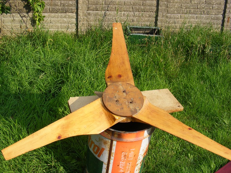

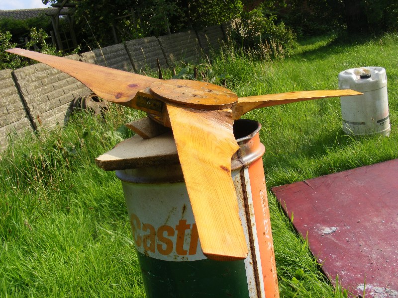

From your pictures of Hugh's prop it looks different from the one I did the tests with. Did you build it from a later book?, mine was from the early book with 8ft and 4ft machines only. I am not sure if he has changed things over the years.

As per my carved wood blades. This is the first carve blades I've built.
I have Hughs book from several years ago and I tryed to follow it as best I could.
I would like to test a set that Hugh built himself. That would be nice.
I did a post the question and asked Hugh if the blade I carved was good enough but I got no responce. It looked correct to me and ran very smooth.
As per my coils. Hugh asks for in the 12 volt version 85 turns of 16 ga. wire.
I wound 2 in hand 85 turns of 19 ga. 19ga. is 1/2 the circular mils. of 16 ga.
I brought all 4 ends out seperatly so the coils can be perelelled for star conection or siresed for Jerry rigged conection.
This was great. One stator that can be configure either way. There was a slight increase in power in the Jerry rigged conection. I'm convince there is also less heat. I also think there will be less coil burn outs with my configureation.
My thermal test indicated that. Over 1600 watts in the big NW storm a few years ago with my littel 8" duel rotor without a burn out helped in that belife.

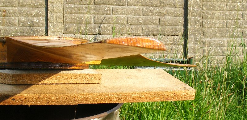

Here are some pictures of the prop I did my tests with. It has got knocked about a bit at the tips but was still working well when I replaced with a 5ft 6" one with a second disc added to the alternator.

There may be a lot in this turbulence idea.
The curve I posted was all taken with the wind in a direction that was clear upwind for at least 800ft. There were nearer obstructions down wind and on the occasions the wind came from those directions the results were bad and not repeatable.
I think at a much greater height and with no obstructions the results would have been better than my curve.
If the air flow is not the same all over the blade area then it is near impossible to get much idea what is happening.I suspect that the lower the solidity the worse it is likely to be with turbulence.
« Last Edit: August 09, 2009, 11:41:18 AM by Flux »

I do have many resistores to choose from. Today I set up My E-Truck with all the wind test stuff, 7ft mast, batteries, meters ECT. I'm going to mount the hand held anamometer on the hood.
In the truck I'm sure I can take the alt up to 40 amps. I'm thinking 20 amps into a resistor might do the tric. I'm thinking I would see around 15 volts so I'd need 300 watts of resistor or to be safe 500 watts. This would be a .75 ohm resistor.
I've got large resistor banks I used when building the big KW audio power amps.
I'll be able to cofigure any value and up to several KW if needed.
I'll do my first tests with the 2 golf cart 6 volt batteries I have onboard now.
I'll test the Hugh blades, Jerry blades and the foam pipe blades.
The #s will be scewed because of the cab over wind but Flux you are right, all blades will be tested the same way under the same conditions.
I wish my wind tunnel had straight air to 50 mph.
