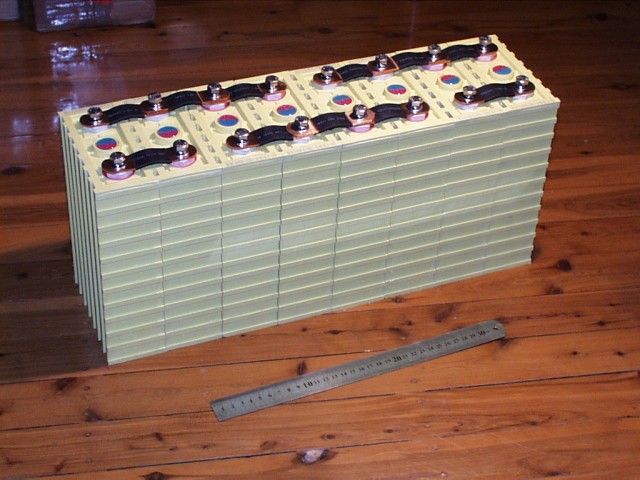

These turned up today.
8 x 90 AHr Thundersky Lithium Iron Phosphate (LiFePO4).
Manufacturers website here: http://www.thunder-sky.com/products_en.asp
Here I have configured them in 2p4s, for a nominal 12.8 volt pack at 180 AHrs.  Cost to my door was $1405 Aussie dollars.
Dimensions are 490mm x 145mm x 230mm, and weight approx 25.6 Kg.
The manufacturer rates these at 3000 cycles for 70% DoD.  Almost 10 years on a daily discharge cycle. If one uses the lead-acid principle of never more than 50%, they should just about last forever.
Next step is to finish the physical hookup of the control electronics, which will be detailed in the next installment.

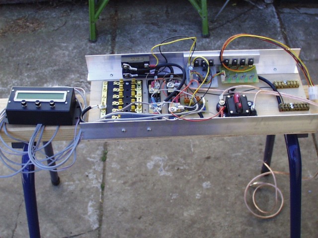

This weekend, I got the control electronics finished off enough to start putting some charge into the batteries from my lone 120 watt solar panel and a 6 amp smart charger.
Black box on the left with the lcd and 3 pushbuttons is my amp-hour meter. Was working previously on my SLA batteries, now won't boot. Will investigate later.
Moving to the right is a fuse block for connecting the loads, 2 x current shunts, the tiny little pcb is the amplifiers for the current shunts, a 70 amp circuit breaker, and terminal blocks for the incoming power. On the aluminium angle, one on each side, are a pair of 30 volt, 100 amp, solid state relays. One is the low voltage disconnect, the other is the bulk charge switch.

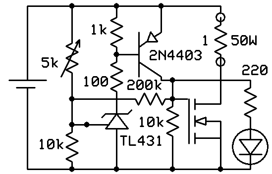

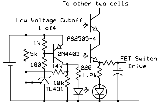

The 2 pcb's on the aluminium angle is the BMS. Board on the right is the per-cell circuitry, while the board on the left is the control circuitry.
The per-cell cct'y consists of a shunt regulator set at 3.65 volts, and a low-voltage detect set at 2.7 volts. Each of these feeds a common buss, and is opto-isolated. The green led comes on with the shunt regulator.
On the control board, the 3 TO-220 devices are:
one to power the low voltage disconnect SSR,
one to power the bulk charge SSR,
and the one in the middle is a constant current source for the final equalisation charge.  The constant current source is in parallel with the bulk charge SSR.
The low voltage signal drives a flip-flop, so once triggered the load stays off until manually reset. The RC network which makes the flip-flop start in reset state needs a bigger capacitor, and silly me forgot a pin header on the pcb for the reset switch.
Pdf's of all the circuitry coming in the next instalment.

And here's the functional block diagram of the control circuitry as a pdf.

I'm curious as to how much balancing current your individual cell shunt regulators allow. Of course, this effects how quickly the balancing operation will happen and I would think that with a 180Ah battery, it could take a while, depending on amount of imbalance and the current level.
I'm somewhat concerned about my system, since with intermittent charge sources (solar and wind), they may not reach a balanced state soon enough. The A123 cells have a reputation of holding balance fairly well after 10-15 break-in cycles so it may not be an issue.
I took a slightly different approach to balancer shunts in the BMS. Rather than linear shunt regulators, I use voltage detectors with 70mV hysteresis driving FET switches with 1 ohm loads. This puts most of the heat into resistors rather than the active devices for hopefully, better reliability. This results in peak balancing currents of 3.6A.
I've had my 56Ah A123 pack on line for about two weeks now, but do the balancing with a separate balancing charger toward end of charge since my BMS isn't finished yet (still laying out the PCB).

From my experience with the 40 AHr pack in my scooter, the cells stay very well balanced on their own. On the scooter, the equalisation/finishing current is limited to about 1/2 amp, and with 16 cells in series, it's typically about 3 minutes from first cell reaching full charge, to last cell reaching full charge.
With this 180 AHr pack, I've again limited the finishing current to 1/2 amp. On the scooter, once all cells are charged, the charger switches off. With the 180, it continues forever at the finishing current, or until you start discharging the pack. This gives a dissipation in the shunt regulators of about 7 watts.
« Last Edit: September 09, 2009, 05:54:46 PM by commanda »

You can achieve about 1-2% more charge if the battery is left at the constant-voltage, full-charge level (3.6-3.7V/cell) for some period of time after the last shunt kicks in. This could be determined by a minimum current (? - into the battery) detection or perhaps, be left indefinately. Hence, my question of your opinion about possible long-term effects of float at full voltage, which I would like to use.
Diversion controller = Dump load controller, in my opinion. If you're going to consider a wind source, I think you need one of these.
"Any diversion controller would need to be across the source, not the battery."
I don't understand this comment since, in most systems, the wind source AND/OR solar source are connected directly to the battery with the dump load switched in parallel with the "whole shoot'n match" (is this an Americanism?) to maintain a certain maximum battery voltage by diverting excess current from the source(s) and provide sufficient load to the wind turbine. I've always used diversion control (dump load), even on solar only systems, because I want to make use of the extra energy, beyond battery charging, for other purposes.
I've included a PWM diversion controller in my BMS using a TL494 and a bank of FETs - pretty simple. When nature is really cooperating, I get a full battery charge as well as some air conditioning via the diversion controller.
Your thoughts?

All shunts low switches off the charge current completely, after a time delay set by an RC network. Currently 4M7 and 10uF. I think this is too short, based on having it running for the last week. The last cell in the pack is always at a lower voltage than the rest. Might need a switch across the capacitor to disable it for a while at least, until I can get the whole pack fully charged.
The diversion controller needs to be across the source, because of the constant current charge regime. Otherwise the shunt regulators would have to take the full current supplied.

FYI here's the circuit for what I've elected to use for balancing shunts. It has been tested and functions well for the job.
The TL431 acts as a comparator with positive feedback via the 200k which sets hysteresis at about 70mV. It mimics PWM (sort of) as the cell voltage oscillates between 3.60 and 3.53V. The FET Rdson is only 4mOhms so it needs little heat sinking at 3.6A. Current limiting is by the 1 Ohm resistor, of course.
The advantages over linear are: little heat in the FET, full source current is available for the balancing/finishing charge, with all switches on it acts as a mini diversion load, and quicker balancing.
Your feedback will be appreciated.

« Reply #26 on: September 12, 2009, 04:50:27 PM »
Samoa,
Minor problems:
the 2N4403 should (may)be replaced with a darlington.
you haven't specified a part number for the Fet. Gate turn on voltage to achieve saturation is critical. Garden variety fet won't work.
Major problem:
the one ohm dump resistor means maximum charge current is limited to 3.6Amps.
This circuit is derived from the case where you charge 4 cells in series as a 12 volt block with an SLA smart charger, which winds back the current as the voltage comes up.

« Reply #27 on: September 12, 2009, 10:50:45 PM »
Thanks for your thoughts Amanda.
"the 2N4403 should (may)be replaced with a darlington."
Not really. The Tl431 has plenty of gain. The 2N4403, which has a beta of about 300, is well saturated at turn on.
"you haven't specified a part number for the Fet. Gate turn on voltage to achieve saturation is critical. Garden variety fet won't work."
Sorry for omitting the P/N. It's a NTD110N02R. Rated typical gate threshold is 1.5V. Gate voltage in this circuit at turn-on is about 3.4V which saturates it well for Id of 3.6A.
"Major problem:
the one ohm dump resistor means maximum charge current is limited to 3.6Amps."
I'm not sure what you mean by this since the bulk charge current (below 3.6V/cell) doesn't flow through the 1 Ohm resistors (all FETs off). Perhaps you mean the balancing charge current AFTER the first balancer has turned on, which is true but is seven times greater than the 0.5A you are using. But remember, the cell current acceptance is decreasing rapidly at this point. Perhaps I didn't make it clear that this is the balancing circuit across each cell (4 used) not a dump load controller for the whole pack. The balancing current (cell discharge) is 3.6A.
I tested this circuit on a 4S1P pack and it balanced the pack very quickly, about 15 seconds from first one on to the last one on. Of course, on the larger 4S24P Pack it'll take longer.

Bill,
Bit slow on the uptake sometimes, but I've figured out how yours works.
Once the batteries are full, as the charge current increases up to 3.6 amps, the shunts will turn on full. Any further increase in current beyond 3.6 amps, the voltage will increase proportionally due to the one ohm resistors. So you set the dump load controller to just above 3.6 * 4 = 14.4 volts.

Here's the rest of the per cell circuitry - the Low Voltage Cutoff (LVC):
It's similar to the balancer detector but with an off voltage of 2.7V and 300mV hysteresis - back on at 3.0V. I elected to have automatic reset rather than manual so that load surges don't have me running for the reset switch. If the battery is truly down and it recovers to more than 3.0V, it'll simply cycle - still protecting the battery.
The PS2505-4 is four photocouplers in a 16 pin DIP. The four output transistors are in series from the total pack voltage and provide the OR function. This output drives a bank of five NTD110N02R FETS as the load switch in the negative battery line. The RC filter helps protect against load surges.
I hope you don't think I'm trying to hijack your thread. I simply value your feedback so I don't make any stupid mistakes before I finalize the PCB.

« Reply #30 on: September 14, 2009, 03:55:19 PM »
Bill,
For LVC, consider the TC54. It's a low voltage reset chip for a micro. Output pulls low when voltage goes below a set voltage. Could use less components.

« Reply #31 on: September 14, 2009, 05:49:30 PM »
Amanda,
Thanks for the suggestion. Yes, I did consider the TC54 but rejected it for a few reasons. You're right, it would take fewer parts but, not being programable is a drawback. Different fixed voltages are available but I have limited access to parts. I also wanted to be able to control the differential.
