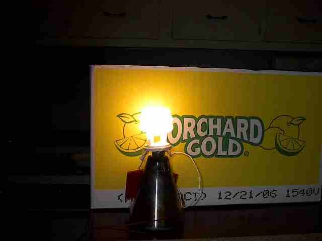

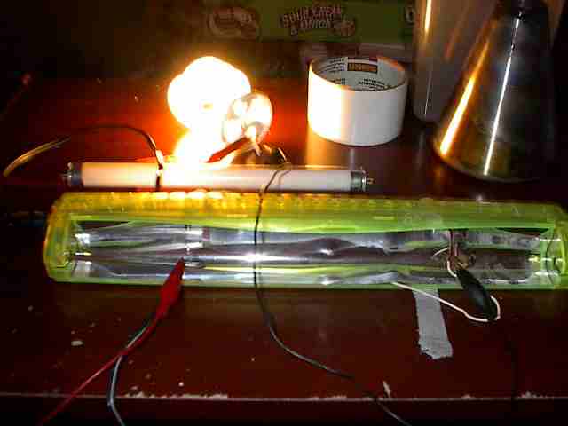

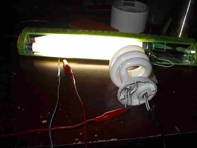

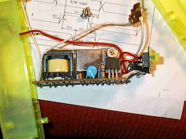

with Fall coming soon and the need for more light
i finally decided to try to run a CFL bulb on 12v
the bulb had two terminals at either end , but just using one terminal per end seemed to work just as well
i am not up on my flouro bulbs , but the unit was built for a 11.3" bulb (F8-5)
but the bulb in the last pic is a (F6-T5CW) for comparison with the CFL
since i didnt have a bulb with burnt electronics i had to use a working one , and it works!!
The pics were taken with the flash on
for comparison i put the T5 bulb back in , to me it looked as bright as the CFL but the reflector behind the T5 bulb makes it look brighter?
it didnt light right away ,i could see it was trying to warm up ,i tapped it and it started to light

almost forgot,  the unit has an auto accessery plug on the end  and is running off of 12V

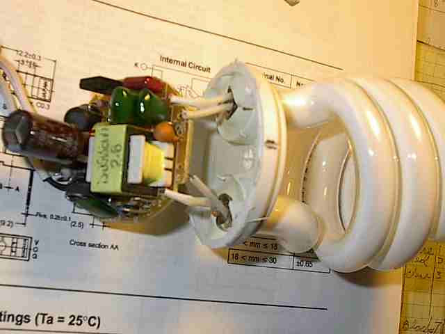

i bought the unit at Kmart and the CFL at the dollar store
the CFL was 120V , till i took it apart

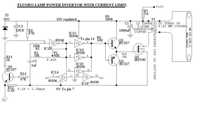

i have been doing some reading on them the two wires at each end of the tube itself , are for preheating , but no one seems to use them both , except the original (120 v ) circuit , did use all four wires separately..
i got this circuit off the net , looking at it , everything to the left of the IRF540 could be replaced with a pwm circuit/chip? i think
« Last Edit: September 01, 2006, 01:16:59 AM by willib »

Driving fluorescents efficiently and with long tube life is quite difficult.
Producing light is fairly easy if you don't measure efficiency and don't count tube life.
Probably the best route is to make a simple dc to ac square wave inverter to produce about 300v ac peak and use normal 230v cfl. They rectify the voltage internally to about 320v dc.
I suspect the 110v units may have a voltage doubler so you may need 120v ac square wave to feed them. Or you could use 300v and rectify it and feed to the unit after the doubler but that means going inside it.
Circuits that don't use the heaters always damage the cathodes and end up with black ends on the tube if you start them very often.
Single ended drivers are not very efficient and are generally not good for long tube life, some of the cheap units are only suited to up to about 8W where efficiency is not important as they give little light and are only suitable for background lighting.
If you just want light with simplicity and low cost and not bothered with efficiency there are several push/pull square wave self driven inverters about that will cold strike tubes from the spikes during switching then run with the leakage reactance of the ferrite rod transformer. they often will work with tubes with damaged heaters that no longer run on proper ballasts.
I have seen the circuit in a few places, maybe B T Humble, but someone here, has adapted it for 3rd world use.
If you use this , don't measure efficiency with a photometer, the eye is not a good comparator of light output.
« Last Edit: September 01, 2006, 01:40:56 AM by Flux »

I used a dremmel with an abrasive  wheel attachment to get the  120V one apart , i cut it along the joint between the top and bottom halves, you can see where i cut it , in the pics.

I've seen a lot of schematics, none that I like. This one could be ok, at least I've got plenty of old transformers from Philips TV PSU lying about...
You happen to remember where you find it? I'd be curious as to the maximum rating of this 'power' driver, and perhaps some pictures that go along with it. Esp. for the correct transformers.
Was thinking 'why quadfilar wound?', since they seem to use no taps, but it's probably done to reduce resistance of the primary without resorting to thick wire. I.e. 4 parallel windings.
I think I could build even such a complicated design in the foot of a CFL. Few SMD parts perhaps, creative layouting. Perhaps even add a 2nd level board.

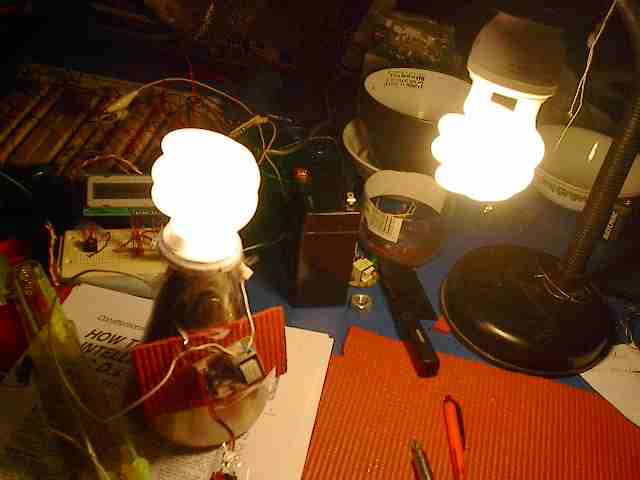

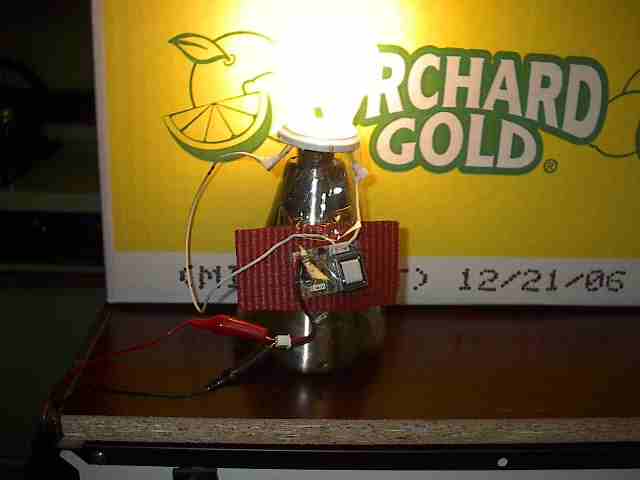

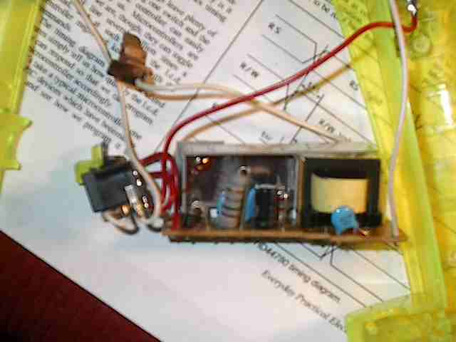

You have great pics, can you get one of the circuit board for the 12V? All I can do is try to scan one, probably won't be very good. Only 7 parts on both of mine, transformer couple resistors, a cap, and I think a gate.  About 20 various parts some strange on the 120V boards.
I took apart 2 12V CFL drop lights after reading your post. A couple things I found out myself.
The power going to the CFL can bite you, I wanted to be sure so I tried like 3 times and it does bite a bit! My drop lights had problems. One had a loose gate? I had to hold it bent in place to get it to work, bumped a wire on the bulb and got bit.
If you connect one wire to the bulb and just hold the other wire near the bulb will glow nice and the Gate gets very hot, found out when a wire fell off. Could be why the first drop light stopped working.
The 120V light that had been in the rain and only glowed a little in one spot, glows well, but it is a 4 U tube type for about 100watts output. 4 Pins, looks like 2 pins for 2 U tubes each. It presses/plugs into the 120V circuit board. Glows enough I can tell the tubes still work, but does not really light useable. Wondering why the 120V board does not work, I figured corrosion etc.. but it's clean and looks fine.
The 26Watt bulb (rated) looks the same as the one in your picture as far as I can tell, almost exact same. Wife was happy I finally put a second bulb in the kitchen, Hmmm well she is back to one now :)
I popped it apart. Nice these thing aren't hard to get apart. Simply force a flat screwdriver down into the seam on the sides and pry it up. Top and bottom just snap together, pry apart.
I saw the 4 pins sticking up, with my eyes I thought it was heavy wire soldered to holes in the board. After about 30 minutes or more of looking for the soldering iron I found I did not need it. Close look and the thin stiff copper wire is only wrapped around the 4 pins, no real connection just wrapped tight. Find end with finger nail and untwist it.
To get the CFL drop lights apart I just cut the rubber end near the cord, peeled it open and pulled it off. Everything slides out of the clear tub easy. One of these is an older light maybe $10 from K-mart years ago, the other a $3 Big Lots light. Don't know which is which. Basically the same thing inside, but one is better made, same tube.
One drop light has a reflective paper backing and the circuit board is just there stuck inside.
The other has a metal reflector sleeve the full length and the thing I reffer to as a gate is screwed to it for a bit of a heat sink.
 Otherwise the 2 are the same far as I can tell by looking. I will buy the $3 ones from now on to be sure!! If modding it I can add a heat sink myself, alot better one than thin metal.
As far as light and power?
The drop light was 8 watt it claims, used 2amps @ 12V so 24watts.
The 120V CFL says 26 watts, used 2.7A up to 3amps, seemed something caused it to gain .3 amps as it warmed up. So 3amps at 12V, 36watts.
As far as light output with mine sofar, the 26watt was far less bright on the 12V board than when on the 120V board. It may be more light than the 8watt tube produced though. Hard to tell durring the day, but I like the twisty 120V tube better.
Now that I found my solder iron I will fix the gate thing, make permanant connection and test some more. Also I used a bank of 3 17amp SLA batteries. I found one of my 115amps gell cells needed charging and I am doing that now, will use it tonight. Maybe put the works outside for a yard light and see what happens if it don't rain tonight.

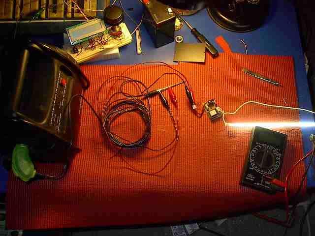

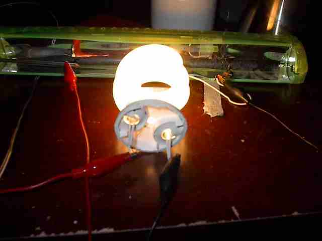

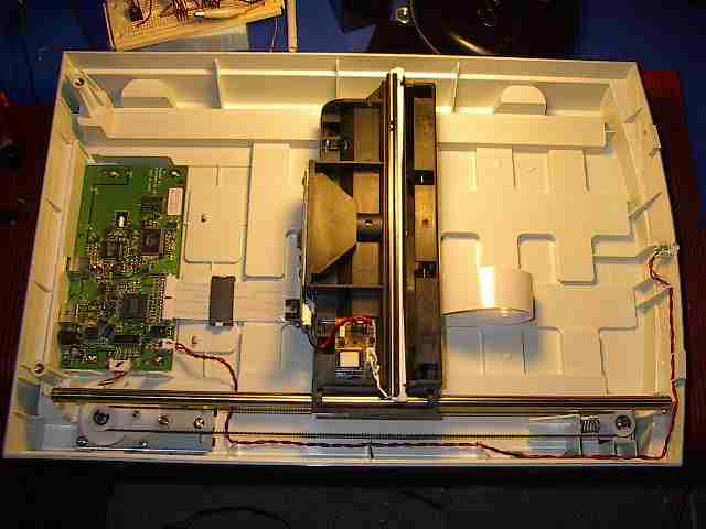

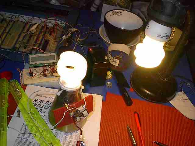

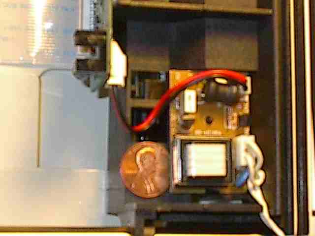

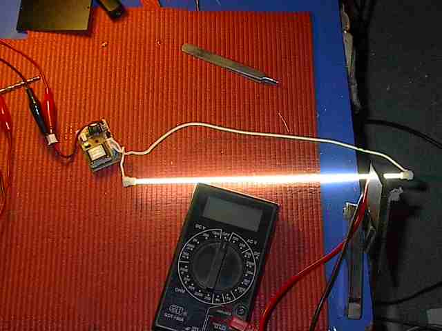

I've just taken apart a new 1$ Chinese CFL, and connected it to the FL driver from an old scanner. The circuit is meant for 12V and draws .55A, so input is about 6W; output is unknown, but it lights up a 11W CFL perfectly, as you can see in these pictures.
I doubt I get the full 11W of light though, maybe 5W, but still. The pcb is small enough to fit into the base of the CFL too...
These PCBs can be found in all old flatbed scanners, they usually drive the long & thin FL light in them. I've got several of these FL drivers lying about, and I know what I'll be looking for in my next dumpster-diving adventures: scanners.
The question of course is how long the thing will work; whether the CFL is perhaps damaged by the driver, etc. Of the 4 wires of the CFL bulb, I've only used two. No preheating of the electrodes was done. Also, I assume such scanner FL drivers aren't meant for continuous duty. Only one way to find out, I suppose.

i just happen to have a flatbed scanner ( dumpster diving lol) i'll look insde ! thanks!!

"can you get one(photo) of the circuit board for the 12V? "
sure !
« Last Edit: September 01, 2006, 04:24:03 PM by willib »
Re: Will a CFL work on 12V ?
« Reply #14 on: September 01, 2006, 05:38:51 PM »

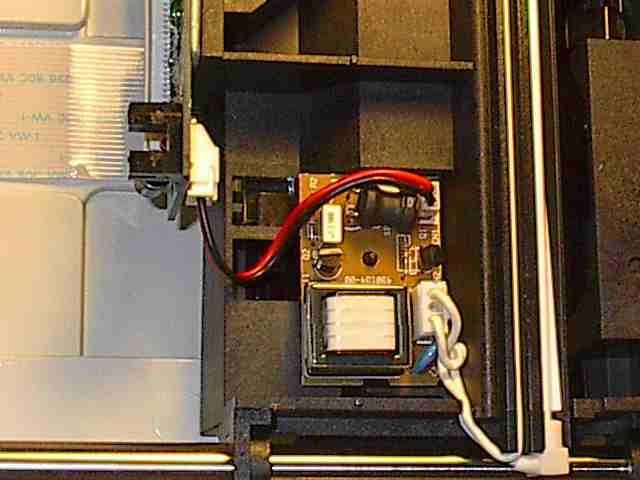

Wow good call Peter , besides the 12V fluro inverter ( pics 2 & 3 ), there is also a nice ground shaft with bushings .
and a optical switch (infrared), which tells the scanner when the bulb unit has returned to the home position , although i allready have a bunch one more is good too.

I left the scanner bulb in ,its pretty brite on its own

what about laptop screens? they have some sort of tube, and i have a BUNCH of old laptops at work. i also have a bunch of scanners, but not going to tear into working equipment :)
watch out, alot of scanner tubes have a fair bit of mercury in them. most new equipment has warning lables all over it.

12v board pics
« Reply #23 on: September 03, 2006, 10:46:12 AM »
As requested , the circuit board from the 12V board.
recap: this board is a standard T5 driver/inverter, whatever, which runs off of 12Vdc and powers a T5 fluro tube
this is a bit beefier than the scanner board inverter/driver , the transformer is larger , it has one power transistor w/heatsink , about 12 parts total , if i recall correctly (IIRC).
where the scanner board is smaller , it uses two TO92 size tranistors , but after it is on a while it only consumes .216 A , not bad !
i will post a "comparison" in a few mins.
« Last Edit: September 03, 2006, 10:46:12 AM by willib »
comparison
« Reply #24 on: September 03, 2006, 11:13:26 AM »
the light on the left is a "lamp" i made from a one dollar $1 cfl , powered by a scanner tube ciruit and running off of 12V, power consumption is 2.6W
the light on the right is the same tube ,but is origional and powered by 120v rated at 20W
the only way to tell the difference between the two lights (in a picture) is the shadow produced by the origional 120V one , on the right
granted when i'm working at my bench i prefer the 20W (120V) light , but the scannerboard light will provide enough light to illuminate a room, and at 2.6W it makes an inexpensive nightlight,or with a reflector behind it ,a night reading light
« Last Edit: September 03, 2006, 11:13:26 AM by willib »

Find a local PC modding geek and see if they have a few driver boards for the CCFL's they usually install and then remove for another color.
Scanner tubes usually are driven a bit "hot" and aren't usually full time rated (inverter stuff) making a bit of heat when used full time.
http://www.xpcgear.com/lightingmods.html
New stuff isn't too bad a price these days--but I would say "recycling"/"reusing for another purpose" this stuff would be cheaper. Watch carefully for some of the Neon type lamps/inverters used for cars or PC's--they use a much higher output voltage then the CCFL's or even the LED types available too.
Maxim makes a bunch of these type drivers and if registered with them--they even furnish samples (free) in small lots, 2 usually limit of each. And send you a monthly little magizine that describes some of their wares available and uses too.
The One-Wire (Dallas Semi) branch of Maxim makes some neat sensors for remote monitoring of everything from weather (temp--etc) to you name it.
Google "aag" for a cheap(er) one (weather monitor) that works well.
But the CCFL tubes are certainly rated for long life--11K to 15K+ hours.
Looks like a good usable source of cheaply obtained "light" to me.
