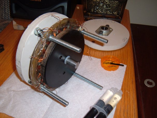

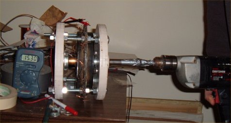

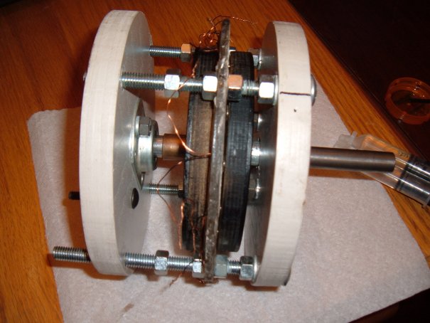

Greetings all: I have a basic PMG generator to battery question. It has probably been covered before, but i could not find it- -so please forgive me if it has. A short simple answer is greatly appreciated.
I just made this small PMG alternator that does 10-20 watts max. at 300-500 rpm.(shown below)  The magnets are tiny (3/8" diam x 1/2"deep) is why there is so little power. (live and learn) -The 20 watt max i get is while shorting it through my ammeter to get a reading. However, when I hook it to my 2/ 12V marine batteries (hooked parallel), I only can get 8 watts going in. Is it somehow possible to get the full 20 Watts going into the batteries. Unfortunetly, I cannot hook half the generator coils in parallel to get twice the amps, because it would take too strong a wind to reach cuttin voltage. (only getting about 10 volts @500rpm with coils hooked in parallel)
Is there anything I can do to get more of the maximum amps out of the 12 coils hooked in series?
I also have this same problem with a permenent magnet treadmill motor I was testing. I get 2or3 times the amps shorted thru my ammeter.    -Any help is super appreciated.
This is my first PMG. Not much power but at least it works. It does 18vac/16vdc @500rpm and 13vdc(cut in) @300 rmp.

You don't seem to understand the concept of power.
You get amps into a short circuit, but there is no power. Power is the product of amps and volts. You will never get the short circuit current into any form of load at a given speed.
Your true power is the amps into the battery x battery volts. With a tiny alternator you have to accept that you will need to run it at high speed to do anything. 500rpm is not such a high speed for a small windmill with an output of 20W.

Now you have given a bit more information I can help a bit more.
You saw 16v at 500 rpm with virtually no load, so your cut in at 12v will be at 12/16 x 500 = 375 rpm. ( say 400 rpm for a reasonably charged battery).
You get 1.2A at 15v, so you would get that into a fully charged battery when equalising.
You are not much above your cut in point, but power will increase as you take the speed over 500rpm so there is nothing to worry about. Don't reconnect it for double the speed, it is fine for a 4 ft prop with cut in at 375 rpm if you make a prop with tsr6 or so.
In higher winds the speed will go up to over 1000rpm without much trouble and your problem is more likely going to be preventing it burning out rather than getting enough power.
Battery resistance is so low as to make no difference, the gain you saw with 2 batteries in parallel was due to a slight drop in voltage as Ghurd said, nothing to do with resistance.
Take the trouble to learn about props and make something with a tsr of 6 or 7 and it will do far more than your expected 20W.
Don't get too confused about that motor you used as a load, the motor will only take the power it needs to do what it has to. As you load it, it takes more power to supply the load ( foot warmer ) If you completely stalled the motor you would see more amps at a low voltage.

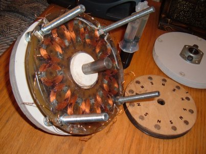

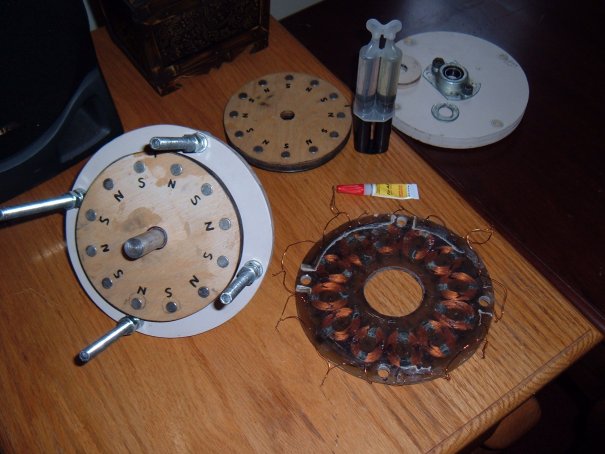

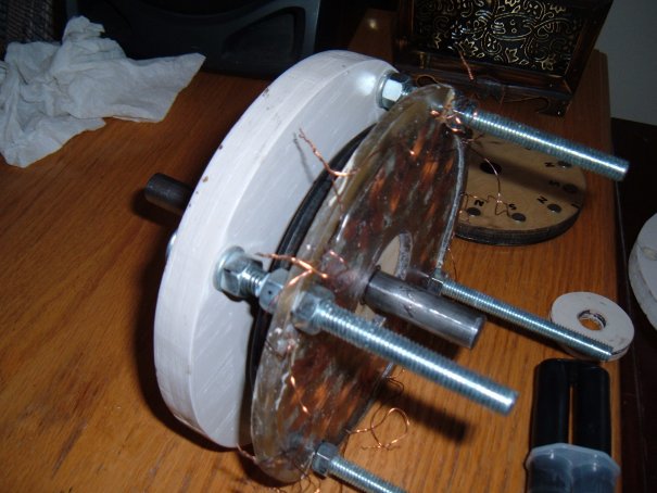

Anyway, here are a few more pics of this tiny prototype. I took many pictures of the whole process. These are just a few. Later I will display them all and the processes, including my bigger downwind alternator, to possibly help others and  give some ideas.       -Thanks guys
The Stator was pretty easy to make. I simply used plywood-cut out the radius, and used wax paper inbetween. It is perfectly flat and is 1/4th in thick. Overall magnet to magnet air gap is about 5/16".
The construction is very simple. The front and back is 3/4in. plywood painted w/2 coated exterior paint (will be 3), 5/8" ball bearings and rod. I used a piece of metal (electrical) conduit about 1.25" to go over the rod to the front bearing. I then ground out a couple of 7/16" washers with my dremel tool to fit tightly over the 5/8" rod.
I actually don't know which photo I'm commenting on. Anyway the magnet rotors are about 6" dia. -made with 1/2" baltic birch plywood and a 1/8" think steel back.(painted black) You could probably up size a bit and use a couple of 7.25" circular saw blades (plywood type-NOT carbide) for this. Just grind the sharp HHS tips off with your grinder.(of course you would have to heat treat the metal with your propane torch where you want to drill any holes thru- but thats easy and quick to do)

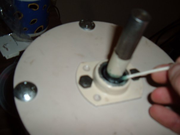

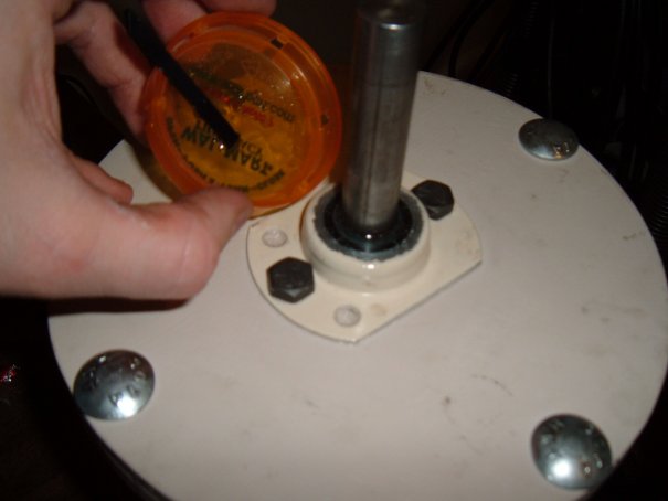

Lastly, I sealed the front bearing with 5min. epoxy to make it waterproof. First, I used silicon caulk to seal behind the bearings and bolts. Before I poured the epoxy, I put grease very carefully on the shaft and on the crease that goes around and around near the shaft. It starts setting in just a few minutes, so i took the masking tape off before it set - but be careful not to turn the shaft. Obviously, if epoxy goes down into the bearing, it is ruined and you've got a quick headache. But it worked for me like a charm. The shaft 'broke free' from the hardened epoxy very easily.
Oh -I forgot to mention that I EPOXY the magnet rotors to the shaft. Believe it or not, If you use a 5/8" fortsner brill bit, this makes a VERY strong bond. You would have to break it off with a hammer- and it would break the wood not the bond. (i know cause i had to do this earlier to redo the rotor mag set up)
So, to make a short story long, I'm going to use silicon caulk and wrap sheet metal around the front and back and screw it at bottom, and epoxy the 4' (3 pine 2x4 blades) to the shaft and i'm good to go!  I will publish the results soon. Thanks again.

An idea you may or may not like...
It LOOKS like there is space in the coil holes for a complete 2nd set of the same size magnets. And the rotors look like the 2nd set would fit pretty well compared to the coils.
So drill holes and add more magnets, very nearly touching the first magnets, on the inside diameter (between the existing magnets and the polarity markers).
Even if it's not a perfect fit, the open volts will increase probably enough to use the coils paralleled, the resistance will then be halved, and the output power will increase.
You went this far. Might be worth a couple bucks for more magnets?

http://www.otherpower.com/images/scimages/3274/algenerator1I.jpg
where did you find those bearing holders in this photo?

« Reply #19 on: January 16, 2007, 07:42:06 AM »
one more thing , since you still have all the coil ends exposed you can wire it in star ,and add four more poles , and build a 16pole 12coil three phase machine
because the stator you have constructed IS a three phase stator , not a single phase
you would benefit from knowing the difference when you build your next machine
« Last Edit: January 16, 2007, 07:42:06 AM by willib »

« Reply #21 on: January 16, 2007, 08:36:08 AM »
Actually, it is single phase- I don't believe 'all the kings men' could convert it to 3-phase now.
« Last Edit: January 16, 2007, 08:36:08 AM by CmeBREW »

« Reply #22 on: January 16, 2007, 08:41:33 AM »
Actually, the bearings came with those metal holders. I got em at a surplus store around here for $3 ea.
« Last Edit: January 16, 2007, 08:41:33 AM by CmeBREW »

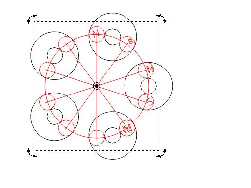

CmeBREW...
Unless your 12 coils are overlapping, you do not have a single phase alt, you have a pair of magnet rotors with 12 poles and 12 coils that look like there's a fair amount of cancelation, hence your poor output.
Looking at your pictures, do you have this setup?;
Magnet & coil spacing is important to maximise output, for 12 poles the following are the norm;

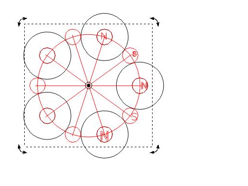

  • 6 coils, centers spaced 60 degrees, legs & center hole same size as mag dia (single phase)
  • 12 coils, centers spaced 30 degrees, legs & center hole same size as mag dia with overlapping legs (1, 2 or 4 phase)
  • 9 coils, centers spaced 40 degrees, legs & center hole same size as mag dia, touching legs (3 phase)
  • 36 coils (3 phase)... difficult to explain, see; Windstuff Ed's 3 phase turbine kit or http://www.fieldlines.com/story/2004/5/26/15451/3307 for an example.
As willb says, you have a 3 phase stator suited to 16 pole rotors;
(exact same stator layout with 12 coils as the image above)
paul

Hello stop4stuff:
    Yes, your first diagram is EXACTLY what I have. 12 magnets exactly spaced in the middle of each of the 12 coils as they go around. But my coils do not overlap-if i understand you right. I already knew that If I wanted to completely re-make new magnet rotors I could make a 3-phase alternator with 16 poles. Now I see what willb was saying. But  I don't want to re-make the rotors! I thought my alternator was a single phase since all 12 mags come accross each coil leg of each coil at the same time. Hope I didn't misunderstand that. Originally, the magnets WERE suppose to be 3/4" diam. , which is the center hole of each coil, but I was tring something different and well... - it didn't work, and so this is what I wound up with.(difficult to explain)
However, your first diagram is exactly what I wound up with. You even drew the magnets smaller as they are. Today I hooked a faster drill to the alternator and it is doing much more power at a higher RPM. (as Flux said) I'm getting over 30 watts at somewhere around 800-1200 rpm.(only rough guessing) The drill seems to be doing this fairly easy.(of course the drill is rated for 3100rpm, so i am just guessing where 1000rpm is.)
If you think I've done the layout totally wrong, please let me know. Thanks for the diagrams.
« Last Edit: January 16, 2007, 02:26:46 PM by CmeBREW »
Re:
« Reply #25 on: January 16, 2007, 02:40:56 PM »
What you have done is perfectly logical, you seem to have set out to make it single phase and have done so in a perfectly satisfactory way. You also seem to understand the 16 pole 12 coil 3 phase set up.
One thing I am not sure about, are the magnets on steel plates or just into plywood.
If just in plywood then you are loosing a lot of potential output.
« Last Edit: January 16, 2007, 02:40:56 PM by Flux »
CmeBREW
  • Posts: 615
Re:
« Reply #26 on: January 16, 2007, 03:21:34 PM »
Thanks Flux,
    For a minute there I feared I'm even dumber than I thought. I thought I knew the basic principle of single phase. I don't see any cancellation myself. There are no similar poles on a same coil. But at the same time, i'm only getting one magnet on only one leg of each coil, which is less power than if I had used the 3/4" diam. magnets which would
have got me about 1/4th (or more)of the next magnet on the same coil.(the opposite leg/side of one coil) Which would have meant more power. Thats alittle difficult to explain. Anyway I appreciate the 3-phase diagram of the 16 pole/12 coil , cause that is the set-up of the bigger alternator I am currently making using 7/8" x 7/8" N40 mags. (16 mags on each rotor/ and 12 coils.)
The answer to your question is yes, Each pole is 3/8"dia. x 1/2" deep. So they go thru the 1/2" plywood and stick to the 1/8" steel plate. In fact, Thats why I had to redo both the rotors, so they would be stronger flux accumulating on the steel plates.    -Thanks
« Last Edit: January 16, 2007, 03:21:34 PM by CmeBREW »
Re:
« Reply #27 on: January 16, 2007, 04:03:55 PM »
I dont mean to belabor the single phase point
 a true single phase has gaps between coils ,unlike your potential three phase stator.
the single phase has a cogging effect because each magnet passes over a coil
leg at the same time. Unlike a three phase machine which distributes the load
evenly and is preferable to single phase
http://www.otherpower.com/images/scimages/2965/single_phase.JPG
http://www.otherpower.com/images/scimages/2965/single_phase2.JPG
« Last Edit: January 16, 2007, 04:03:55 PM by willib »

« Reply #28 on: January 16, 2007, 05:36:14 PM »
Thanks Willib,
   Thats certainly true. But it must be much less noticable with a smaller, high rpm alternator like mine- cause it sure seems quite smooth even at over 2000rpm. (now I'm getting over 40 watts into the batteries, but of course thats WAY too fast for my blades) The main reason I did single phase is because I didn't understand (4 certain) 3-phase at the time. But now I do.   -Thanks for everyones' help!
« Last Edit: January 16, 2007, 05:36:14 PM by CmeBREW »

CraigM
  • Posts: 205
Re: Single Phase
« Reply #32 on: July 29, 2019, 09:26:09 PM »
Hello derekisastro,
Short answer, yes.
Single phase is when all coils are linked in series. The drawing below shows 5 coils and 10 poles. All coils will see N then S then N and so on... change from N to S is what creates emf (moving electrons) through the coil wire. The up and down AC sine wave is the result of the fluctuating N to S to N poles the coil is seeing. In this type of arrangement all coils are wound in the same direction, either clockwise or counterclockwise... as long as they are all the same. All coils see N at the same time and then all see S at the same time.
Single phase can also be done (and much more likely to see it this way) with the same number of poles (magnets) as there are coils. Example; 10 magnets, 10 coils. In this arrangement all coils are still connected in series but 5 of the coils will see N while at the same time 5 of the coils will see S. With this arrangement every other coil needs to be wound in the opposite direction. Five of the coils will be wound clockwise while the other five are wound counterclockwise.
So yes, you've got it.
Regards,
CM
