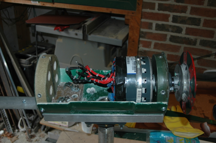

I have been messing around with one to! Fixing the prop to the small shaft (.110) has been a pain. I used a small flared fitting for brake lines, filled it with JB weld and stuck it on the shaft, Its drying now!
Keep us informed of your progress
