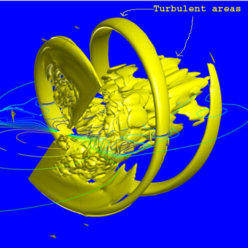

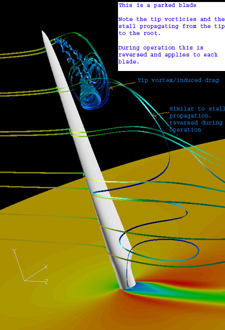

Below is some illustrations of induced losses. The images are computational fluid dynamics models done by Risoe. This is an extension of what I had to say in the last paragraph of Ed's recent blade calculation post.
http://www.fieldlines.com/story/2005/5/30/15179/7889
The newest enercon blade design reflects a recognition by them of the fact that treating theses areas will yield appreciable results. Note enercons use of winglets and a deep swept back root at a high angle.
http://www.enercon.de/www/en/rotorblattkonzept.nsf/mainView/1?OpenDocument
I, as usual these days, was advocating the use of fewer blades if possible and thought I would throw out some info to support my logic, which is, everytime you add another blade you add another "set" of these induced loss areas which may be greater than the losses incured by increasing the cord width of fewer blades which results in increased drag across the lifting portions of those blades.
Any takers? This isn't intended to be a classic 3 blades Vs. issue.

This also reflects on my feelings about utilizing sectional L/D figures when calculating rotor Cp and torque. You need to take these areas into account. rduce your figures accordingly(penalty depends on design).

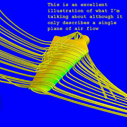

Nice illustrations rotornuts.
These turbulent areas in illustration 2 made me think about the separation of the Laminar boundary layer. The angle of attack of the wing at the turbulent areas is mush bigger that the rest of the wing, causing this separation.
So what you need to do is to maintain the Laminar boundary across the wing.

wdyasq
  • Posts: 1324
The Root Stall
« Reply #6 on: June 01, 2005, 08:07:56 PM »
Mike,

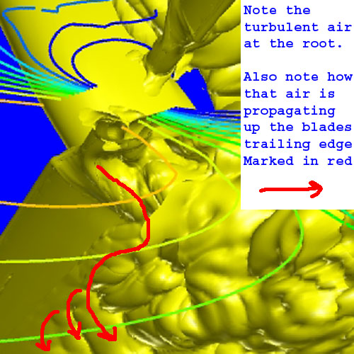

It is interesting how the attachment induced stall starts pulling the vortex from the root out.  It makes it interesting to see how a miss-shaped blade - insufficient angle at the root, would lead to problems.
What software was used to model the illustrations?  It shows real well the effects of a cylinder - at the root and explains why so much work is done at the root/wing interface on an airplane and why vortex fences are sometimes used.

« Reply #7 on: June 01, 2005, 11:20:29 PM »
Yes it is very interesting. I think unless you sweep the root suficiently you'd almost be better off not to have one. Stall fences(vortex fences) may be in order at the root along with a wider cord set at an appropriate angle with a proper swail to reduce boundry layer seperation. Vortex generators could also help clean up the root area and perhaps have a fence effect. I realize that in the past I've said that I don't like wide roots but that's in the context of the relatively low angles that we see on the 1 1/2 inch deep blades. The blades that are commonly used here on the board with the large root attachment point must be creating tons of dirty air and I'm sure you can imagine were it's going, straight up the low pressure area on the back side of the blade killing lift.
The modeling technique is called Detached Eddy Simulation which is suppossed to be an upgrade for Reynolds Averaged Navier-Stokes simulation. RANS appearently doesn't work as well In highly seperated air flows such as heavy stall conditions and bad wake turbulence like what you see in the above image. The RANS images show turbulent flow in the same areas but at nowhere near the same detail or severity. I was very happy to find those images.
